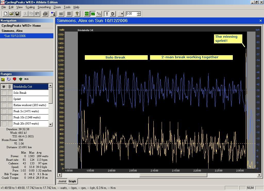

For a bit of fun and education, I thought I'd post a couple of criterium data files and open up for questions as to what it all means and what one can learn from it.
Here's one from the Brindabella Crit in Canberra.
In it I have marked where I did a solo break away (basically from the start), then was joined by another guy after 15-min. The total race stats are shown on the left, but note:
Ride Section___ Avg Power__ Normalised Power___ (NP/AP)
Overall Race____ 289W________ 306W___________ (1.06)
Solo Break_____ 322W_________ 331W___________ (1.03)
Two-man Break_ 269W_________ 288W___________ (1.07)

Postby Alex Simmons/RST » Mon Nov 10, 2008 5:25 pm
And here is another one.
This time a State Masters Criterium Championships at Port Macquarie.
Duration: ___ 48:09
Work:______ 797 kJ
TSS:_______ 127.1 (intensity factor 1.258)
Norm Power:_ 352
VI:_________ 1.28
Distance:____ 29.914 km
____________Min___ Max___ Avg
Power:______ 0 ____ 1336 __ 276 watts
Cadence:____ 23 ___ 124 ___ 94 rpm
Speed:______ 0 ____ 49.8 ___ 37.9 kph

Postby Alex Simmons/RST » Mon Nov 10, 2008 5:30 pm
chris641 wrote:Some nice power you got going there.
I've always wondered, but never got around to researching, what the normalized power numbers mean as opposed to the average power??
Normalised Power is a means by which the physiological strain of rides can be equated to one another.
It takes into account that the relationship between power and the strain on the body is not linear but curvelinear in nature (and follows a relatively predictable time course).
Hence, a highly variable power ride, while it may be of relatively low average power (compared to, say, what you could do as a solo TT like effort), can be quite stressful on the body simply because the high power surges take more out of you.
if you want to know more about it, have a read here:
http://www.cyclingpeakssoftware.com/pow ... efined.asp
and ask more questions.

Postby Alex Simmons/RST » Mon Nov 10, 2008 7:09 pm
philip wrote:Cool that's pretty interesting, especially the large differences in average power between the solo/two man break.
What can you determine by looking at one of these in terms of improvement? Can you look at it and say "I could've done X better and Y point in time", or do you only get a benefit by comparing one race with another to determine a change/improvement?
In terms of fitness progression, really you only look at race data (or a section of race data) when you know it was maximal effort. Otherwise tests are better for that.
You might actually learn more from races where you cracked, than where you went well.
Racing is often about how you rode as opposed to the absolute numbers. The power data tells you what you did, as opposed to what you should/could have done.
In the race where I was in the solo and then 2 man break, what I can say is that I was starting to suffer a bit after ~ 12-min or so (it was a very hot day with a shocking hot westerly blowing), so the power file reflects the point where you can see I eased up a bit as I noticed a guy bridging across and so I made the tactical decision to allow that to happen since I figured I had a better chance of making a break stick with two of us sharing the workload rather than solo in those conditions. By significantly dropping the power required to roughly maintain the same speed, we could maintain our break.
What I did learn is that, if executed well, I had the power to make a race go my way and have the confidence to execute such a strategy. So often we sit in the bunch and wonder what might have been.
This tells you what the actual demands are in order to execute such a strategy.
Ironically, in this case I didn't actually launch an attack in the usual sense. We hadn't even done one lap, the guy in front of me rolled off, I just put a little pressure on through a turn and there was a couple of bike lengths. I just kept the pressure on and the gap grew a little. The field would have thought (quite understandably), it's so friggin hot and windy, let the bugger fry.
