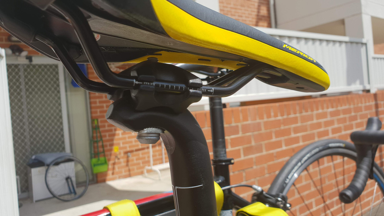

i don't seem to find anything about them on internet. now i got 2 bikes with different kind of seatpost.
whats the difference and which is better?

Neither? Well if I had to choose one the bottom one with the vertical screw and jaw clamp (but I rather two screw vertical clamps with the wheel adjustment). I don't like the side screw clamps at all and Selle SMP saddles can have real problems with them slipping. Although I do remember a guy in a Trek shop swore black and blue their side clamps didn't have any problems with Selle SMP saddles.

Transverse bolt clamps are rubbish. Simple as that. Single vertical bolt clamps are better, but tend to lack fine adjustment, and cam also tend to slip when they get old.

Was about to agree with all and rubbish side mount, but then checked the Giant CX race bike and its side mount. Seat/mount takes a hammering jumping on and off racing, and can't fault it. Although Trek MTB with side mount Bontrager post and saddle is rubbish. Had to grind to get it to work and still need massive tightening to hold.
Road bikes all verticle over the years and no issues.

My Cervelo has an arrangement similar to the first photo from the OP, it gives no trouble but it is maddening to configure it first time.

Got a 3T recently with some sidebolt arrangement, super weird to set up, but once done, seems good.
