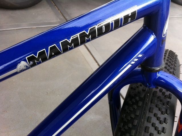

After reading the talk in the So how bad is a Big W bike, really? thread it came to pass that the Mammoth would enter my possession. As an addict of the local gumtree bicycles listings I noticed one a while ago for the princely sum of $200. It didn't sell, so I considered offering $150. Then to my excitement (or is that horror) the seller was having an oz-day weekend sale, n+1.5 kicked in and I brought it home yesterday.
As described elsewhere on the web and in the other thread this is no ordinary Big w BSO, it is a fat bike, and with that comes a significant amount of steel and a little alloy weighing in at 23.1 on my bathroom scales this morning. The tyres are huge and no doubt the tubes are too adding up to all the extra weight over what would probably be a 14kg bike other than for the wheels. It's rigid, single speed and has not much extra on it.
I have taken it for a spin short around sunrise this morning and it's going to have to go back in the workshop and then be put on a diet. You can really feel the weight in spinning up the wheels, but once there it isn't that hard to cruise along the flat. Up hill is a different story, funnily enough it feels heavy, very heavy. The steering is a bit wired too, seems to be nice and stable going straight on, but once the bars turn there is a strange sensation probably to do with the rotational inertia and changing the direction of the spinning 4kg (estimate) wheel, or it could be the geometry that appears to be a little bit too steep. Either way, something to get used to. Maybe some fattie riders might comment on the steering of a decent fat bike setup. The position is very upright and it could probably do with a longer stem, but I'm on the taller end of humans and have a long torso too. As its one size fits most, it obviously won't fit everyone, and although a more cruisy position it wasn't bad.
The chain promptly fell off after rolling out of the drive down the road and then beginning to pedal up the next rise. The front brakes rubbed for the whole ride and the left crank developed a bit of a clunk on the way home so I pushed it up the hills rather than damage something. Was ok on the flatter sections without too much power applied. Tool time next. Also need to shorten the silly-long brake cable and remove excess items like a kickstand and maybe the chain guard.
I also let down the tyre a lot. The previous owner had them quite hard, as I know heaps about fat bikes I figured the tyres shouldn't be hard so I dropped the pressure to around 15, bit hard to tell as my pump guage isn't accurate that low. The tyres still are quite firm even at 15psi using the old squeeze test. Seems the tyres are fairly stiff, next step will be completely deflating them and testing!

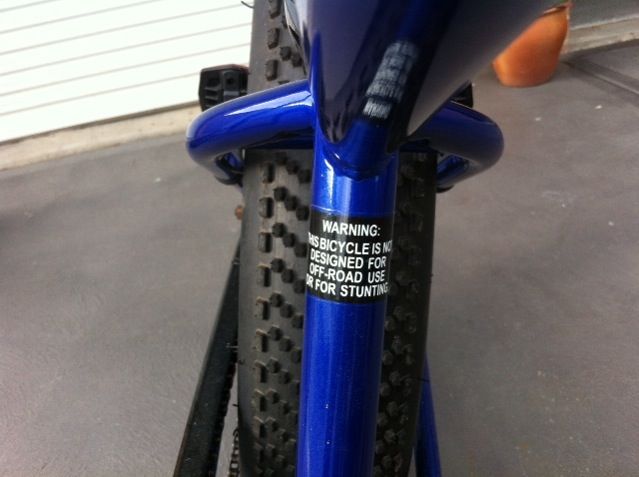

A coaster brake on a a supposedly off-road bike. Well, not really. That sticker says a lot!
How are you supposed to ratchet the pedals over obstacles with a coaster brake?
Smite it with fire! :lol:

trailgumby wrote:How are you supposed to ratchet the pedals over obstacles with a coaster brake?
You're missing the point. You crush them instead with your sheer weight. BigDump is trying to appeal to the MMA/MonsterTruck loving set where brute force is (and short attention spans are) king.
