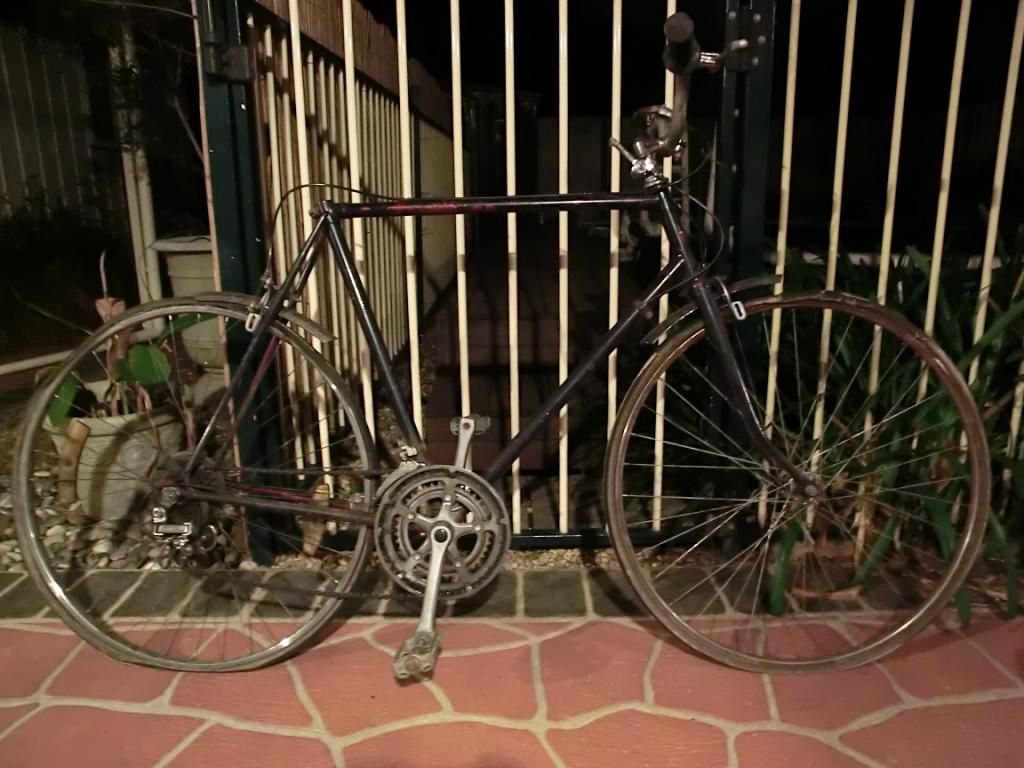

Postby korokorohumbug » Thu Jun 12, 2014 9:34 pm
So this is the beast!
I just took some measurements. Any thing seem unusual here?
Wheel OD = 644mm (hard to measure exactly)
Rim inner width = 17.5mm
Seat tube mounting clamp ID = 25.7mm
Handle bar OD (measured at the centre near the clamp) 25.1mm
Sproket shifting mechanism = Suntour Honor brand... never heard of them but actually doesn't look rusty - the Chrome is holding up well considering what this bike must have been through!
Chain pitch = 13mm approx (The links look very skinny compared to the pushbike chains I've seen)
Pedal thread OD = 14.12mm (must be an imperial thread but I didn't check the thread form)
Pedal crank is Aluminium and is SR brand - again never heard of it.
So the plan is to get her up and running this weekend - I'm very temped to sand back and repaint the frame as it looks absolutely disgusting lol.

i wouldnt waste your money on that bike, looks like i needs everything replaced

They look like 27" wheels, so find 27" tubes and tyres accordingly.
You don't have a seat post? May be hard/ easy to find. I'm thinking this one just takes the same as what a BMX uses. Then again, try a bunch of posts to see if it fits.
Handlebar clamp should be 25.4mm.
Suntour Honor is usable. Nothing special. Your shifters are not indexed. So you have to shift and set it at the correct place manually. There are no clicks to tell you the correct position of the shifter.
Just lube up your chain. No need for a new one really. But if you want, find a 5/6/7 speed chain. The current one is not skinny. It's one of the fatter ones you can get.
It most likely has standard pedal threads(whatever size they are(most pedals will work), and Is reverse threaded on the crank with the gears). SR is Sakae Ringo, nothing special.
You are missing brake pads too. Find some pads for steel rims. However, regardless, the braking will be weak as.
Don't strip and repaint. Ain't worth the effort. Try it with a better frame if you ever decide to upgrade. And make sure that this frame fits you. It looks fairly big. Measure the top tube and seat tube centre to centre and see if it is correct for you by using the online bike sizing calculators.

Yeah, I probably wont bother painting the frame - every time I paint or polish something it always gets destroyed or stolen. ha! If I keep it though, maybe when its stripped, I'll give it a scrub with some kero and iron wool then spray paint flat black.
Whilst that $400 cell bike looks like a great bargain - I think its a bit much for what I'm prepared to spend at this point in time... but I will keep it an option.
I might be able to pinch some brake pads and a seat from another junk bike I found leaving me with only new tyres and possibly bars on the shopping list.
I just measured the frame to be about 57 to 58cm on the top bar. I'm only 172cm tall so I would need a 53cm frame... but it seems pretty close... but is it close enough?

Seems too large. I'm 174cm and on a 54cm Giant TCR SL1 (with a quite high seat post). I have tried a larger bike and it wasn't good. Maybe you can manage however.
