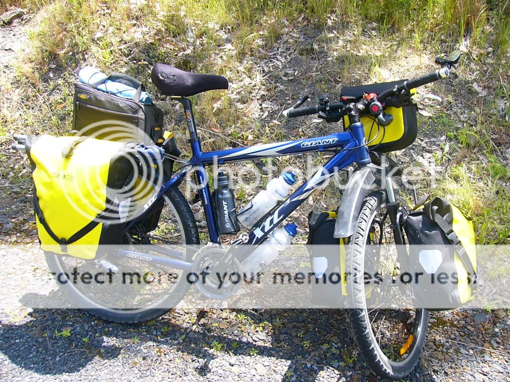

Postby banjo » Mon Jul 27, 2009 11:33 am
I toured many years ago in runners with the cage pedal setup. Its all I knew then. Now I use SPD shoes on cleated pedals. Superior by far. You can walk in them like regular shoes and when I'm touring I stick to the one pair of shoes anyway and maybe a pair of thongs or sandals.
I tour on a Giant hardtail and even then I lock out the front suspension as much as possible. I'd steer well clear of rear suspension. Your background in NZ is ideal and will serve you well. You'll know all too well what a quality piece of kit that you can depend on looks like.
This is my beast during a 4wk tour last year.
