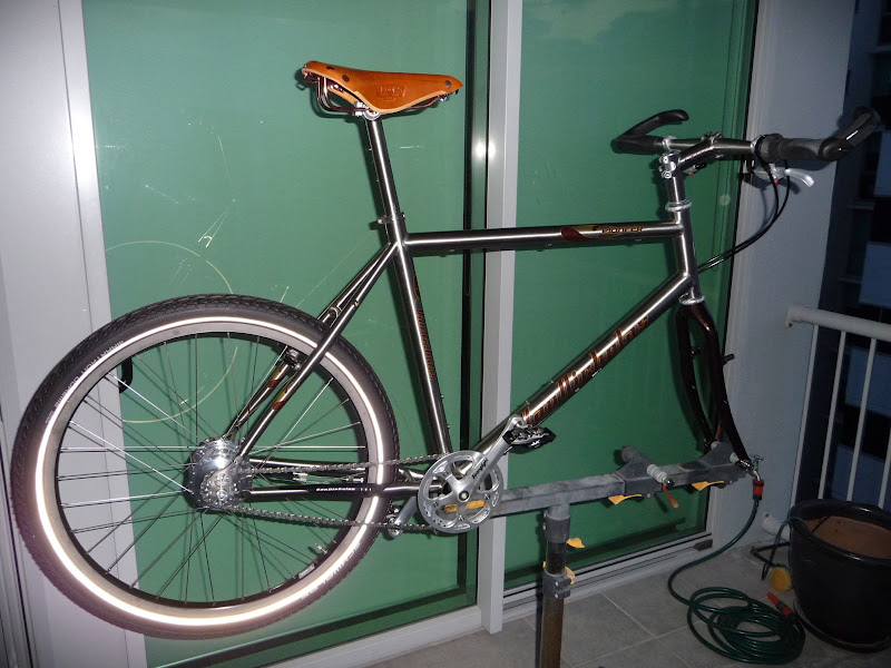

Postby RonK » Sat Oct 29, 2011 8:38 pm
RonK wrote:I didn't make much progress with the build last weekend - I'd forgotten to buy a crown race installer. But Wiggle came to the rescue and had one to me in 4 days. Interestingly, the bargain-priced work stand I ordered from Torpedo 7 the day before still hasn't arrived. It would have been handy this weekend. Torpedo 7 today sent an customer satisfaction email asking for my feedback about the purchasing experience, and whilst I'm not (yet) particularly put out by the non-arrival of the stand, I will be making the comparison with the service provided by a merchant on the other side of the world.
First task is to install the headset cups. Notice the reflections of the lovely view from my 16th floor balcony. That is Mt Coot-Tha you see in the background.
Then install the crown race, and using the cutting guide, cut the steerer to size.
Finally, assemble the steerer, add handlebars, wheels, seatpost and saddle, and suddenly it's a bike.
Titanium is chosen for its strength and light weight. The rationale is I'm here for a good time - not a long time. Another 10 years will see out my cycle touring career, and I want it to be as pleasant as possible. I've heard all the arguments, but have enough personal experience at bushwalking and high-altitude trekking to understand that I have no need or desire for an indestructible battle tank.

Postby RonK » Sun Oct 30, 2011 7:30 pm
The Stronglight crankset is installed with the Bushnell eccentric bottom bracket housing and Shimano UN54 bottom bracket. With the chain and shift cables added it's now a rideable (but not yet stoppable) bike. I was pleasantly surprised to discover how easy it was to install and adjust the Bushnell EBB. Fitting the shifter revealed that Rohloff have changed to a new twist shifter with a round rather than triangular grip, and slightly different cable entry.
A couple of minor irrits were encountered along the way. The inner chainguard fouled the chainstay and had to be removed. I could have saved $10 and ordered the single chainguard version. And the chain - the singlespeed chain I ordered was too wide for the sprockets, so a quick trip to the lbs was required to get the right one. :oops:
During the assembly I discovered that the Stronglight crankset is manufactured by Sugino, and it has XD2 forging marks on the back. 8)
Now it's just a matter of installing and cabling the brakes, and then I'll be able to take a test ride before fitting all the accessories.

Postby RonK » Sun Oct 30, 2011 8:30 pm
Well actually I should have made much more progress but I've had to take care of domestic chores and get in a ride and of course drink coffee and chew the fat for a while.
The chain problem was obvious - it rubbed on the chain guard and made an awful racket. The Ergon GC3 grips came fron Chain Reaction Cycles - $62 for the Rohloff/Nexus version.
In building this bike I'm challenging some of my long-held beliefs and biases. I've always insisted on drop bars, but never use the drops. Ultimately I think it's really "the look" that has driven my choices. It makes no sense. And I've disliked hub gears since the old Sturmey Archer 3-speed hubs of my childhood. And fat tyres - well, really.
It's an interesting exercise to research and compare the bikes sold in Europe with those from the UK and US. Other than China, Europe is probably the world's biggest market for bicycles, but only racing bikes have drop bars there. There are a plethora of trekking bike models to choose from. All have flat bars and only entry-level models use derailleur gears. I would have bought one of these, but couldn't find a merchant who was willing to export one.
Notice the XT Trail pedals? They are definitely nicely proportioned in relation to the bike overall. Double-sided, good sized platform, just what I've been seeking for a long time.

Postby RonK » Tue Nov 01, 2011 9:10 pm
Last night I installed the v-brakes, and this afternoon I got home early from the office Melbourne Cup function and ran the brake cables. So I just got back from my first ride, just a short one in the dark - about 5 kilometers. Except for a little brake squeal (the pads need some toe-in) everything performed flawlessly, and on first impressions the bike is going to be a real pleasure to ride. With luck I'll have the fenders, racks and lights installed by the weekend and get a good long ride in. But I think I'm going to exchange this hard new saddle for the almost broken in one on the Sabbath first.
Posts: 3290

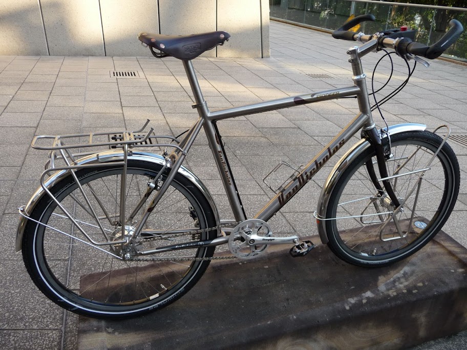

Postby RonK » Wed Nov 02, 2011 8:39 pm
Well, I can report that titanium handlebars may be cut using a fine 32 tpi hacksaw. Using the steerer cutting guide resulted in neat, square cut. It's surprising how much narrower the bars seem with 20mm cut off each end.
Posts: 3290
Re: Van Nicholas Pioneer project...
Postby RonK » Sat Nov 05, 2011 6:26 pm
Well - the bike is pretty much finished now except for the lights and wiring. Tomorrow will be its first real outing.

Postby CommuRider » Sat Nov 05, 2011 6:49 pm
That is sexy. And cool. 8) Well done.

Postby rifraf » Sat Nov 05, 2011 6:59 pm
Hi Ron,
she's looking very smart indeed :!: :!: :!:
Green with envy :mrgreen:
A question about those nice looking grips you've put on.
My bars are very skinny being a model from 15 years ago - I looked on the Ergon website but couldnt find any relevant info on bar diameter sizing?
Did you spot anything about it in your research?
My bar appears to be 25.4 at the stem and 22.3 at the ends which I'm assuming is very "old school"
I'm bound to be looking at the wrong part of the website page.
Aidan :D
