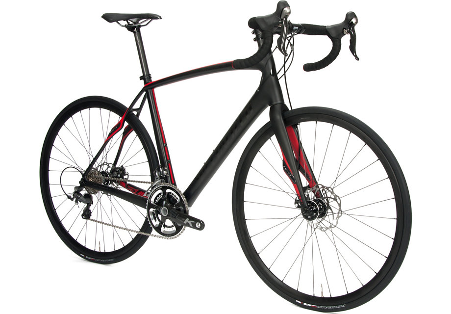

Jeez, I'm with you there, my roadie is getting a bit long in the tooth - I've had it since 2006, and maybe it's time to think about a new one.
Perhaps a Specialized Roubaix SL4 Expert Disc

Looks like it is sitting very high on the bike. Not having a crack, but why wouldn't you just fit a rack and take 1 pannier? is it a weight issue? I would have thought the little bit of extra weight would be offset by more balance on the bike.

STC67 wrote:Looks like it is sitting very high on the bike. Not having a crack, but why wouldn't you just fit a rack and take 1 pannier? is it a weight issue? I would have thought the little bit of extra weight would be offset by more balance on the bike.
That is actually the low position. I would want it in the high position, so that the bag is behind me and out of the airflow.
Like this.
This is to be my roadie, and I want to use this setup for a bit of credit card touring. I will carry only a few kg on the rack. And being a roadie it doesn't have any mounting points for a rack anyway.

STC67 wrote:Perhaps a Specialized Roubaix SL4 Expert Disc
Nice bike Ron, but, it is fitted with a BB30 bottom bracket.
I have a Cannondale CAAD9 with the same FSA cranks and BB30. The cranks have been trouble free for over 17,000km's. I can't say the same for the bearings (BB30).
I've stated my opinion and experience of BB30 systems numerous times in the past, I don't need to again.
In short, I wouldn't go near it.
Maybe fit a conversion sleeve and conventional bottom bracket, or maybe consider a different bike.

Tim wrote:I've stated my opinion and experience of BB30 systems numerous times in the past, I don't need to again.
Yeah, I hear you Tim. But there are not many bikes that have all the attributes I like in the Roubaix.
If I couldn't live with the BB30 I'd probably fit a Praxis conversion.

Postby Tim » Wed Aug 28, 2013 2:03 pm
Ron, it could be that Specialised machine the frame bottom bracket shell to more exact tolerances than Cannondale. I've not read of any BB30 problems specific to that brand. Mostly just Cannondale and Boardman.
If the bearings seat properly, with no movement, they seem to last quite well. Mine have done around 15,000km's having been held in place with Loctite.
The CAAD is a dry weather bike only though. Another BB30 drawback is the limited water resistance. The plastic grommet on the cartridge is the only bearing seal, at least it is on my CAAD9, it might be better enclosed on the Specialised bikes.
I had this reply from Praxis re their BB converter a year or two back when I contacted them. It seems to be the best option;
Tim,
Just measure your frame bb shell width.... most likely it's a 68mm road width, but just check.
You'll want the 68mm BB30 Conversion most likely.
We can't guarantee it won't creak as frames mfg'ers have too many tolerance issues... it's just the reality.
