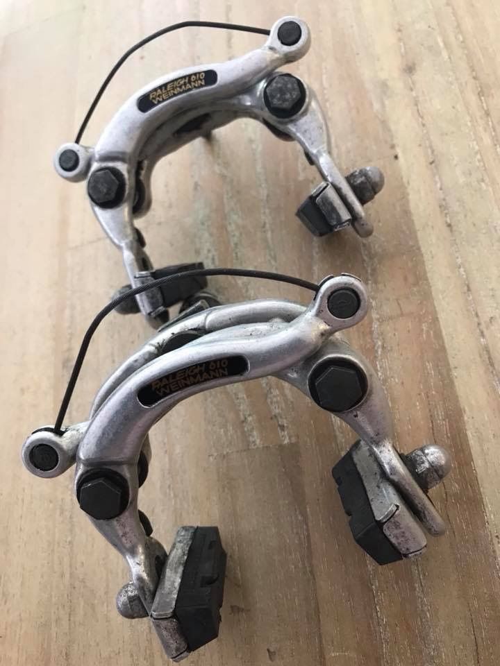

Probably time I updated this thread. - Been a little busy training and haven't had time to work on this beast as much as I would like.
Been getting a few bits and pieces together including this pair of centre pull brakes. Haven't test fitted hem ye but will do shortly and hopefully all is well and wih some new pads and a clean up they will be good to go:
10speedsemiracer
Posts: 1107
Location: Melbourne, Eastern Suburbs, near the hills,
Re: New (Old) rebuild - looking for some build advice
Postby 10speedsemiracer » Mon Feb 19, 2018 4:07 pm
zedries wrote:Probably time I updated this thread. - Been a little busy training and haven't had time to work on this beast as much as I would like.
Ah memories, not all good, but still..memories. Had this exact pair of brakes on a Raleigh in the late 70s. To set them up properly you will need something like the Park Tool 4th hand cable stretcher although they are expensive. SuperB make a copy :
which is much, much cheaper ($18 vs $50+) although I haven't used it to compare. The Park Tool unit is excellent and I use it on all brakes now, it just makes the process easier and more precise.
https://www.pushys.com.au/super-b-inner-cable-puller.html
Lastly, swap the Weinmann style pads for KoolStop Salmon pads, if you're interested in not bouncing off things. Hope you got the cable hangers/stops for the centre-pulls as well. Can be a pain sourcing them otherwise. I think Abbotsford Cycles carry some.
Good luck with the build, keep us updated.

Postby Thoglette » Mon Feb 19, 2018 4:22 pm
10speedsemiracer wrote:Ah memories, not all good, but still..memories. Had this exact pair of brakes on a Raleigh in the late 70s. To set them up properly you will need something like the Park Tool 4th hand cable stretcher although they are expensive. SuperB make a copy :
He-who-must-not-be-named flogs ... no, he doesn't. Scratch that.
Have a look around and see if you can find some thinner (shifter thickness) straddle cables, which should improve the braking (as you're not wasting effort bending the cable). If not, prebend the cable to match your straddle cable hanger. Thin cable works well on the roller hangers, thick not so well but still better than traditional hook style hangers.
10speedsemiracer wrote:Lastly, swap the Weinmann style pads for KoolStop Salmon pads,.
+1

Thanks very much - I have fitted something similar before so I should be able to manage without the tool.
I do have the cable hangers too and will definitely be ordering new pads. Many people have suggested the Koolstop Salmon pads so I will look into it.

Nothing wrong with the Weinmann brakes, I find them to be some of the best brakes for modulation and I have no issues with stopping on high speed descent at all. Plus they swallow fat tyres and mudguards with ease.
The problem back in the day is the crappy brake pads and the usually associated steel rims that went with them. I run Shimano Ultegra cartridge brake pads on mine, cheaper than Kool Stop. You will need to use a washer behind the lock nut on the pad due to the thinner pad mounting point. The advantage with the Ultegra pads, besides the better braking material, is that they allow you to get the toe in just right. This greatly improves braking power and stops the dreaded howl that is associated with the old skool block pads.
You dont need to change the hanger cable as its the right length for the job. Plus it may be difficult to replicate the cable ends.

singlespeedscott wrote:Nothing wrong with the Weinmann brakes, I find them to be some of the best brakes for modulation and I have no issues with stopping on high speed descent at all. Plus they swallow fat tyres and mudguards with ease.
Right - I guess I should really double check the hanger cable then.
I have some pads sitting around from spare callipers from my road bikes including ultegra and other shimano bits so I might line them up and see how they sit before I splash out on new fancy pads. I have some old school looking aluminium rims at the ready so only time will tell on this little gem.
I'll keep you all updated next week.

The other option for the centre-pulls is good quality MTB pads, which provide a slightly larger braking contact patch, if you don't want to spend the $s on KoolStop. I've done this, and have also tried it on some DiaCompe 1970s side-pulls. Makes a difference, just an incremental one though.
Or you could go nuts and fit the KoolStop Salmon MTB pad :
Which I haven't tried but can imagine would work very well. I did it with both Jagwire pads (ok) and Shimano Deore pads (better).
Mmm, SunTour
Posts: 5296
Postby singlespeedscott » Thu Feb 22, 2018 9:27 pm
The MTB pads tend to howl under light braking.
Postby singlespeedscott » Thu Feb 22, 2018 9:45 pm
They work, but no better than road pads. Which have the added bonus of being noise free.
