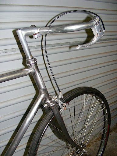

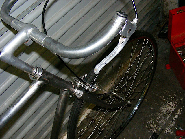

Postby brendan03 » Tue May 26, 2009 4:47 pm
Hi, my name is Brendan - first time called, long time listener.
Firstly, thanks for all the informative posts on this forum - I've been lurking for a while now gathering intel for my first crack at a retro-fixie-rebuild. Which leads me to ask if anyone can help with identifying or providing some more info about a hard-waste-kerb-side-pickup frame I'm working with.
Heaps more pics: http://picasaweb.google.com/marett/FirstFixie?authkey=Gv1sRgCKCkup3c0fmTaw&feat=directlink
I obviously know it's an old Lawrencia build, and I've read-up about those guys - but not sure about the frame. Who likely made it? Country of origin? Does the "87" on the BB stamp indicate it was produced in 87? Any other info? I also found an old "Orion" ladies bike and this frame is EXACTLY the same in several areas.
Its a good frame, hope it will be a good fit for me. So far, in a weekend I've stripped the paint, removed the cable-stays (cable-stops?) and sanded away all traces of rust and the more noticable imperfectons. Several of which were caused by my un-skilled hacksaw technique. :oops:
Would have loved to keep the original paint and decals (which were very cool) but unfortunately the rust was starting to get a hold. Some of the pics make it look better nic' than it really was.
Any ideas about it origin? Not that it matters one-iota, we;ve bonded quite well churning though the sheets of sand paper, i'm just curious to know more. Cheers!

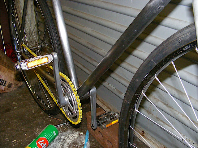

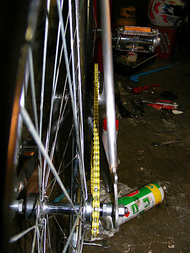

Spent some more quality time on the build this weekend, even got a quick ride in to tighten the rear cog and lock-ring before the blue threadlocker went on.
Here are some progress shots:
Plan is to spray/coat the frame in yellow - so the chain seems a little out of place only for now. :P
After the initial ride I'm a little worried the frame might be a touch too large for me - 700c wheels might bring it "down to my size". Will go for some longer rides tonight since the thread-locker will be cured.
If it is to large - anyone in Melbourne in the habit of trading or swapping old frames?
