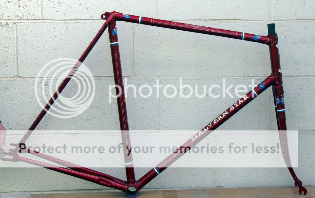

This morning I had a wonderful time photographing old frames and bikes for the long-term owner.
One for Warren's interpretation of the frame number.
and the stampings do not wrap further than shown above
and the full frame

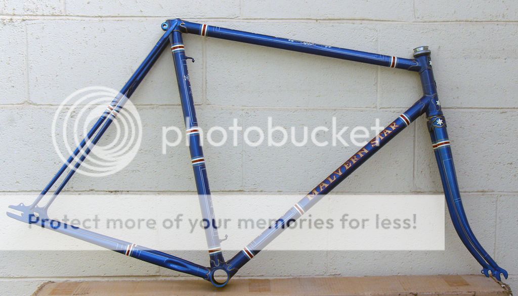

and the second of the 5 Stars, a 1947 Adelaide built frame
All of the bikes and frames have been in Adelaide for quite some time, and certainly since being repainted by Ray Greenslade around 1992. They have been on a wall, on display since then.
