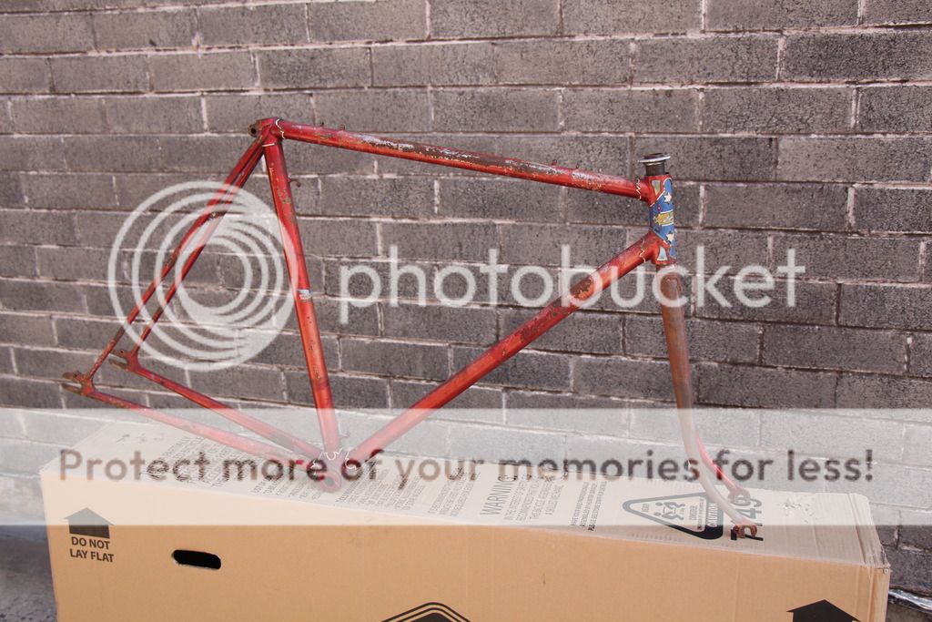

Can anyone help with this skidstar frame? I can't find any serial numbers, it looks like the BB had a number at some stage but it's now illegible.
It seems oldish, but the star is a plastic stick on the same as seen in the 80's. i spent some time removing the remnants of a previous rattle can paint job. Lugs are all fairly plain, bottom bracket oiler has a flip top lid. Rear wheel has Sachs coaster brake hub. 22 tooth cog i think. Trying to decide of i should just chuck back on the wheels and seat, source some bars and ride it, or rebuild as a cruiser.
Edit: sorry, just realised this ' s probably the wrong thread as i don't have a serial number. Any tips on lifting a faint serial number like this?

Hi Arreis, welcome to the forum. I think your bicycle was made in the mid/late 1960's at a guess. If it was mine, I'd keep it as a rat-ride and get it back on the road. Just make sure you check (or have it checked out) that the frame is sound, looks like its had a hard life.

Cheers. Yeah, i was definitely leaning that way too. The rust is all superficial and the forks and tubes all seem straight apart from the drive side chainstay which has a smallish dent directly underneath the chainring clearance indent. It should be ok if i keep an eye on it.

Arreis wrote:Can anyone help with this skidstar frame? I can't find any serial numbers, it looks like the BB had a number at some stage but it's now illegible.
I have a couple frames the same and they are 67/68 vintage but skidstars with that paint style were made into the early 70's. Skidstars normally had 3 speed rear wheels. The serial number is next to the rear wheel drop out, drive side.
Decal kits are being developed for the restoration of these skidstars.
Cheers Geoff
Cheers Geoff
Thanks. I couldn't see a SN near the dropout, but i'll have a closer look.
