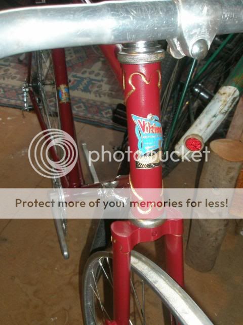

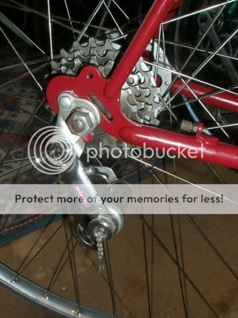

Finally made the time to do some work on this bike. Stripped the green paint and matched new paint to the original overspray on the steerer tube. Interesting, while it was bare frame I found where on old cyclo shifter boss had been removed. I will use a clamp on shifter, so didn't bother with a modern replacement.Decals from Lloyds. Headbadge has been repainted and I've even had another try at lug lining :lol: . Once the top coat has cured in a few weeks I'll start putting it together with the parts I've assembled so far. Have a cyclo Benelux RD, will probably use a huret shifter as I don't have a matching cyclo, stronglight 49D cranks, brooks saddle, GB bars, not sure what stem yet, the original LF airlite front hub and an odd rear till I find a match, brakes - still looking for some GB, but will use some universal as a fill in.

Thanks guys, I'll add some more detailed photos once I get the bike built. Managed to do the clear coat today, so the frame will be sitting beside a heater for a while to harden the paint. I'd tried lug lining once before and gave up pretty quickly. While painting the head badge I found the most appropriate tool for the job was the pointy end of a wooden skewer, which also works quite well on lugs.

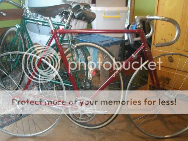

Slow progress, but managed to get the wheels built last night. Front is the original Airlite hub and weinmann rim now with stainless spokes, while the rear is a Powell hub and similar era 40 hole weinmann rim that came on another tip shop bike about 5 years ago (knew I saved it for a reason). Don't know a lot about Powell hubs other than they look nearly exactly like airlites, were built in Coventry and were apparently one of the most expensive hubs of the day (more expensive than airlites). Next job is to find the now misplaced bag that contains the headset and other small bits and pieces :oops: .

More progress today, managed to chip the paint for the first time :x , and also found the headset, so the frame and forks are now attached :D . Stronglight bottom bracket is in and 49D cranks with Magistroni adaptor and chainring is test fitted. Huret shifter looks the part from a distance, while it will be interesting to see how the Cyclo RD shifts across the 4 speed Regina block. Stem is a 1970s GB while I try to find a 50s GB hiduminium. Also still searching for GB courier or sport brakes. Need to purchase some tyres and hopefully will be ready for a test ride later this month.

After an extended hiatus, rubbish weather here most of today, so more progress has been made. Pretty much a complete bike now, with the addition of an old brooks saddle bag, and silver alloy pump. Just need to install some cloth bar tape and purchase a shifter cable with the right fitting for the huret shifter. Will do some more detailed photo's once it's complete. I have ridden it about 50m as is though :D .
