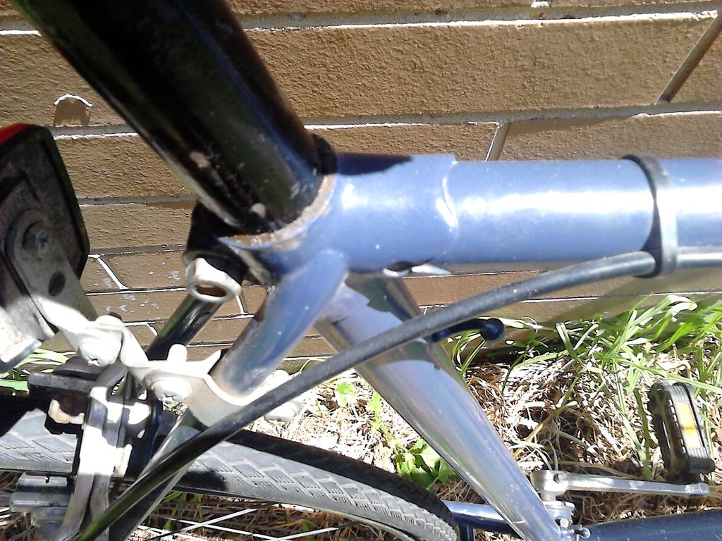

Jaydabear wrote:Also my new project which I found abandoned in a laneway would love to restore this could anyone please tell me if you know what brand of bicycle this is so I can buy the right tires and wheelset thanks
She doesn't look to be anything flash. The horizontal dropouts make her perfect for a fixie. The brake calipers look to have plenty of adjustment to throw on 700c wheels and ditch those 27s. A cheap crankset & BB, cheaps fixed wheels, ditch rear brake and you're done :mrgreen:

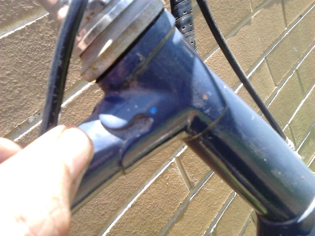

Really she's a old girl has keyhole lugs there old school vintage T.D.C made in England bottom bracket lockring rare nervar crankset cherry brake levers weinmann type 810 brakes oil pot hole on bottom bracket the serials read 1260 on rear drivetrain dropouts and underneath bottom bracket to the left near lockring is the number 2 and in the center reads I think 840 or B40 to me she's ether French or from England or could be Australian iv done alot of research into this and still can't find the manufacturer so need abit of help but I do know she's old and for that reason I wanna bring it back to life also gonna give it to my uncle once it's finished as a gift I'm currently in the process of sanding it down to respray

After the huge search found out that it's a Healing road bicycle from around 1930 to 1940 so I'm gonna be adding my own design doing it in green and gold should be completed by today next week if everything goes smooth with parts an all will keep you's all updated

I doubt it's older than the early 1960's. The head and set angle plus clearances are not of the 1930s/1940s. Nor is the headset cup arrangement The lugs you describe were common to many Australian builders. The bidon cage mounts are likely a later add on it would seem. My guess is that it's an Australian made frame of unknown make from the 1960s to perhaps the early 1970s which has been modified by later bidon cage add ons. The parts are fairly random and tell us nothing apart from either a rebuild in the 1980's or just bitsa updates in the past.

Oh ok there's so much I gotta learn thought it was would this brake bridge hold the key to who made this bike
