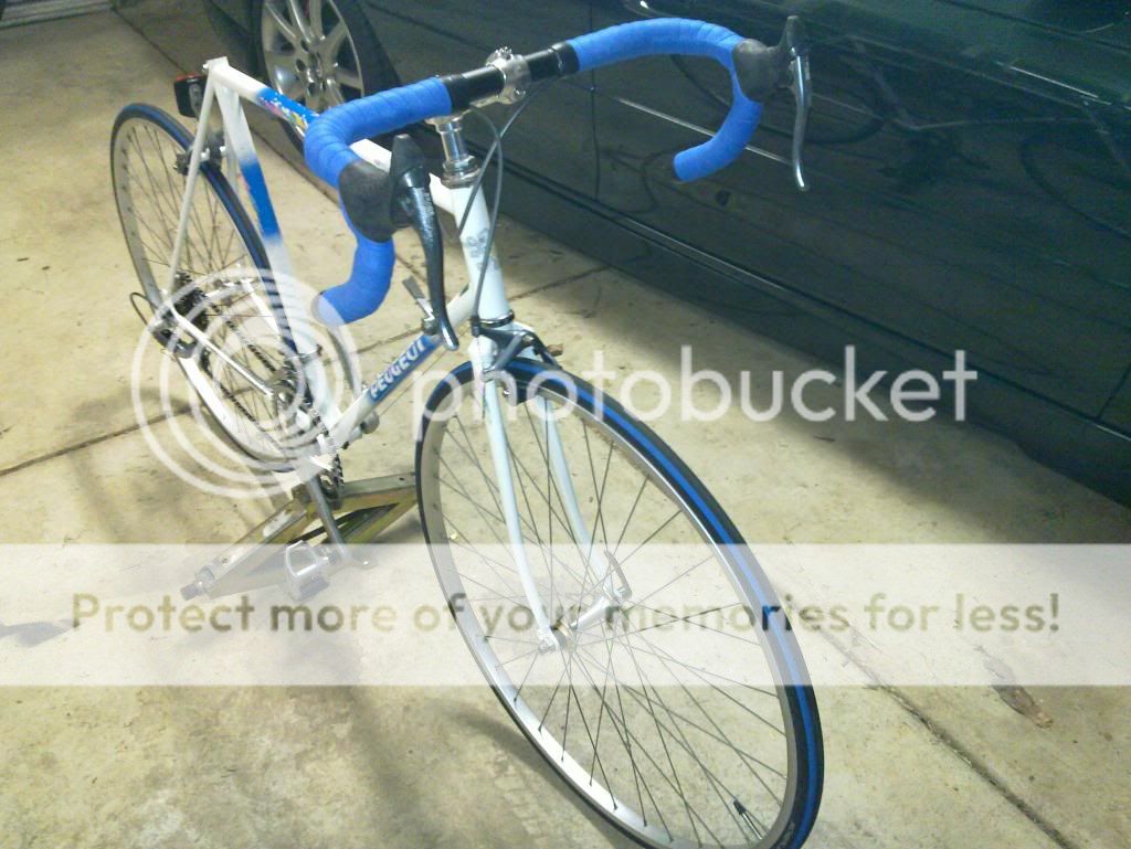

any probs shifting?
The front deralleur looks quite far from the chainring.

Sunho - it is partly the camera angle, but you are correct - it is higher than one would normally place it. I did have it lower, but it fouled - the FD has an awkward range of movement - as it moves outwards it travels down, then up (vertically) and the BioPace doesn't seem to help it. It shifts perfectly where it is now though, so go figure.

Yea Exage front derailleurs and biopace rings make setup a little different but when they're set up right they will shift really well as you've found.

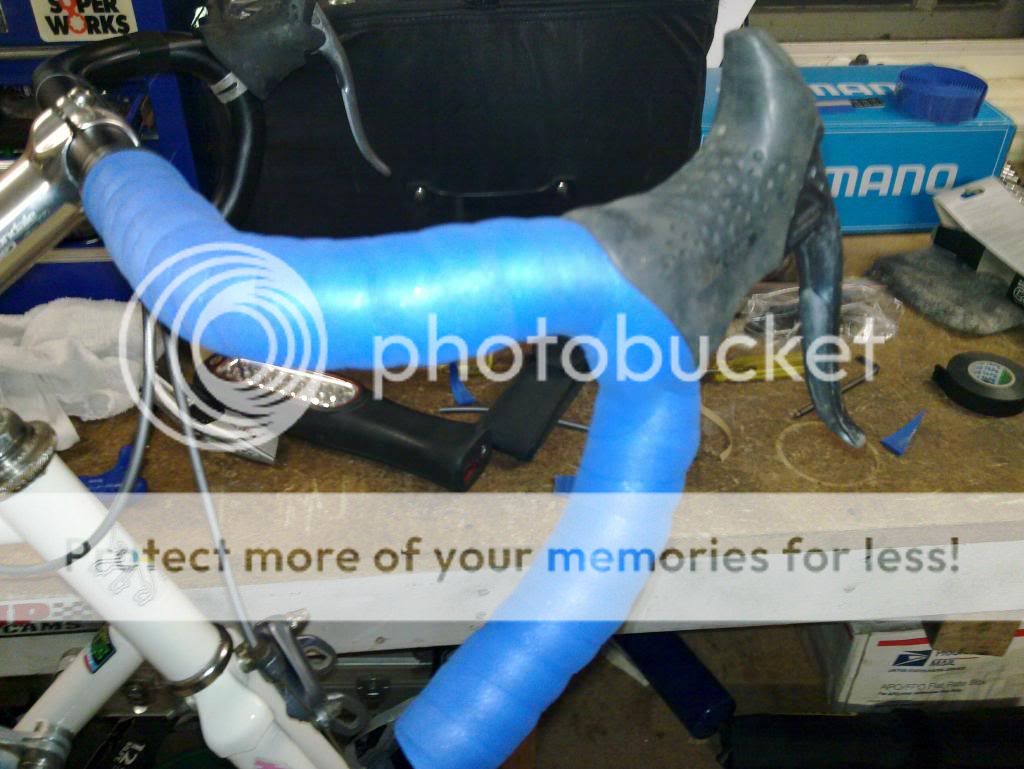

A bit more from today. I decided to go another way with the stem as the black one looked a tad odd, so, I bought a 22.2mm to 1 1/8" adaptor and a nice second-hand Cannondale angled stem from Bicycle Recycle, then fitted them, bars and brake levers, wrapping them up in nice blue bar tape.
Couldn't help but take it for a quick spin up and down the driveway and it feels good. Now waiting on the seatpost from the US, then it'll be time for its maiden voyage.

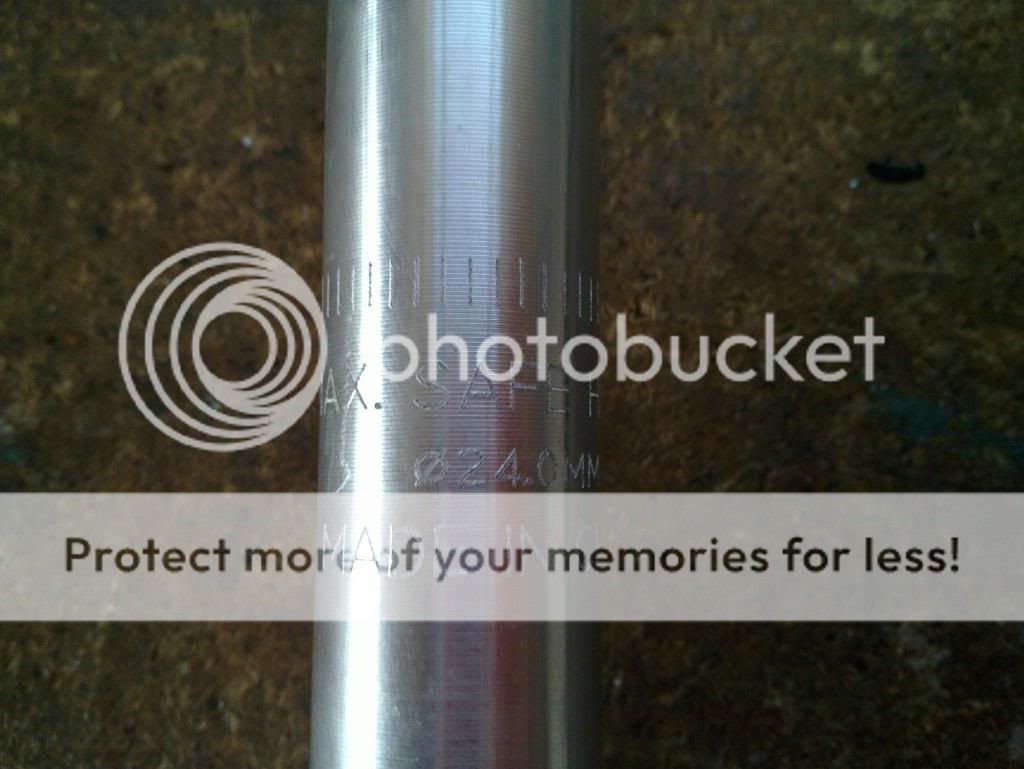

Well, I received the last piece of the puzzle from Yellow Jacket Cycles in the US today - 24.0mm alloy seatpost - and it slid in perfectly!!!
The seat is a bit dubious at present, but may stay as it'll be a bit of a 'fun' bike anyway.
