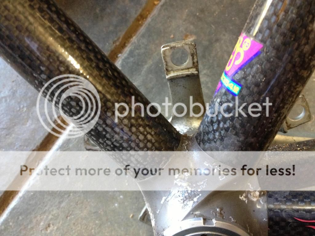

Waiting on Dayne's reply re his Centurion before deciding on which frame I should get. Oh how likely would there be a CF frame at the upcoming Bike Show at Tempe?
So the Cadex 980c Frame Im looking at is this
Could scratches near the BB
And comes with a Rolls saddle.
The corrosion in the 3rd pic. Will that be an issue? That guy's been riding around on this til about 2 months ago. The steerer has been welded an extension and has been remachined(professionally). Probs best if I change out the fork right?
Anyway, I will be stripping the decals(I think they are painted on), and then clear coating the CF tubes. Ill polish up the aluminium. How long would the polished Al stay nice and shiny? Or should I clear coat those parts as well after polishing?
