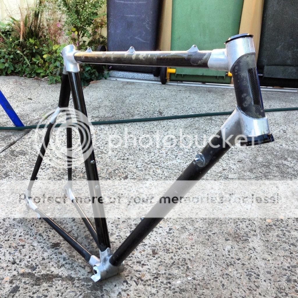

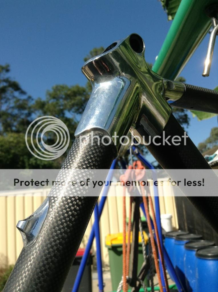

My plans are to keep everything as is. The clear coat of the carbon is suffering from UV degradation, so Ill remove the top coat, and will be recoating. The decals are stickers, so they'll be removed, and then scanned. Now I need to find a vinyl/sticker printing service. Any here able to do it? Or know someone who can? The RSX groupset will be overhauled, and then reinstalled.
Received it this arvo! Took it out, and stripped the last of the components off. Bare frame here

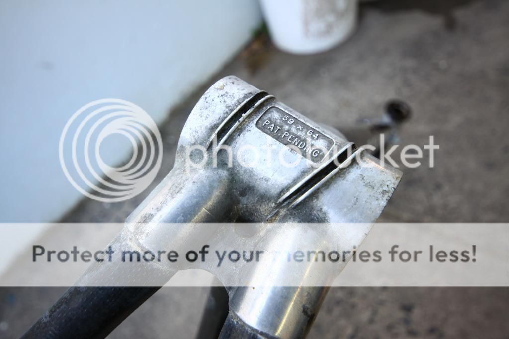

Bottom Bracket with an integrated cable guide. Does that 59x64 mean the angle of the tubes?

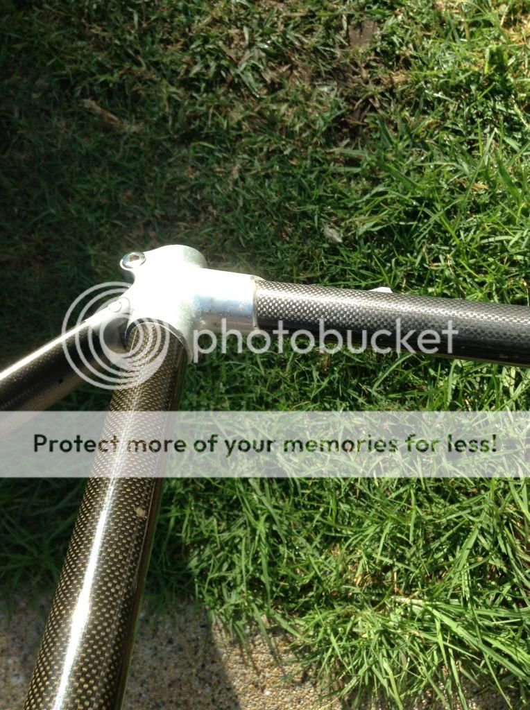

Some pics in the sun to see the carbon weave!
And serial number on rear dropout. Looking around, everyone says its on the BB, but as you can see, its not there, but on the dropout.
Anyway, decals have been removed, and Im in the process of scanning, and creating a file for someone to print.
Tomorrow, I will begin to strip the top coat. Once thats done, all the aluminium lugs and fork will be polished to mirror! :mrgreen:

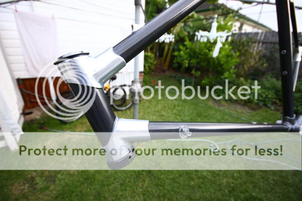

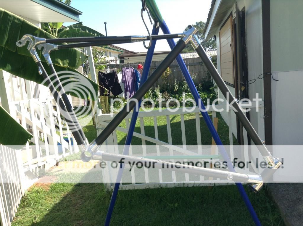

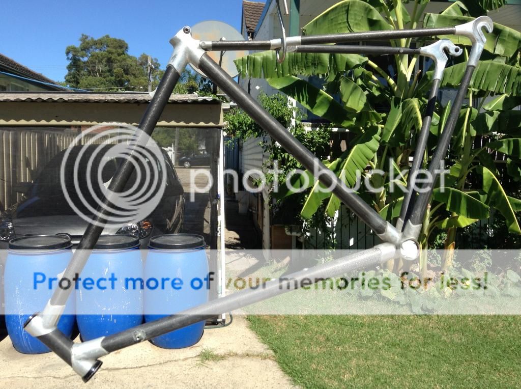

Frame with decals removed. Might be a little hard to see, but look at where the decals would be. Those are the areas which are still new looking, and havent suffered from the UV.
Anyway, spent the day stripping the clear coat, which wasnt at all hard. Those who have enquired about going about it, heres how. There are a few options. You can go with chemicals, or sandpaper, or blades. I chose the latter, since chemicals would prob destroy the resin holding everything together. First you want a rug cutting blade, preferably with a handle. I did not have one, which slowed me down due to the extra effort put in. I would say, its best to get some cheapo blades, and not expensive ones which last forever. Two reasons for this, one being that its cheaper, and the other is the itll have a lower carbon content meaning its softer. It is softer than the carbon, so once you hit the carbon you will wear the blade, and not cut/damage the carbon. The top tube which had suffered the most damage from the UV, was so easy to strip. Water from a hose wouldve blasted it away. You can see this foryourself in the video. Once pretty much all of the clear coat has been removed, I then wet sanded the carbon. Used 600 grit paper around the areas under the stickers first to get rid of the coat which was a little hard to remove. Then I continued to sand the rest of the tubes incase I missed any small spots. The 600 turned into at least 2000 grit when I was done. This is a worry for some people, but carbon is a hard material. Sanding will take minimal amounts of carbon away, and its really the sandpaper that is being worn away. So unless youre using a really low grit paper with lots of effort, its really hard to stuff up the carbon.
Click to view video below. Look at how little effort I need to put in. But this was really only for the top tube and head tube. The seat tube, and rear triangle was a little hearder to remove, but wasnt as bad the the down tube. The downtube took forever to remove the coat since it wasnt really degrading. Overall, I took 3 hours to remove the coat. 30 mins for the top tube and 2 seat stays. Cut my finger cause I was speaking to my Dad whilst scraping. Took a 30 min break to buy some petrol to clean the groupset, not really so much cause of the cut. Came back and continued for 2.5 hours. I began off with one blunt blade cause I couldnt find any others, but when I reached the downtube, I had to find more blades, otherwise I wouldve broken my arm. With a new blade, it was so much easier to remove. So let that be a tip, ALWAYS USE A RELATIVELY SHARP BLADE! Use like a blade per tube.
You can see the difference. The seat tube and stay has a yellow tint to it. Thats the top coat turned yellow due to time and UV degradation.
Frame fulled stripped, before sanding.
You can see hints of the top coat on the right hand side, which was under the Carbon-R logo.

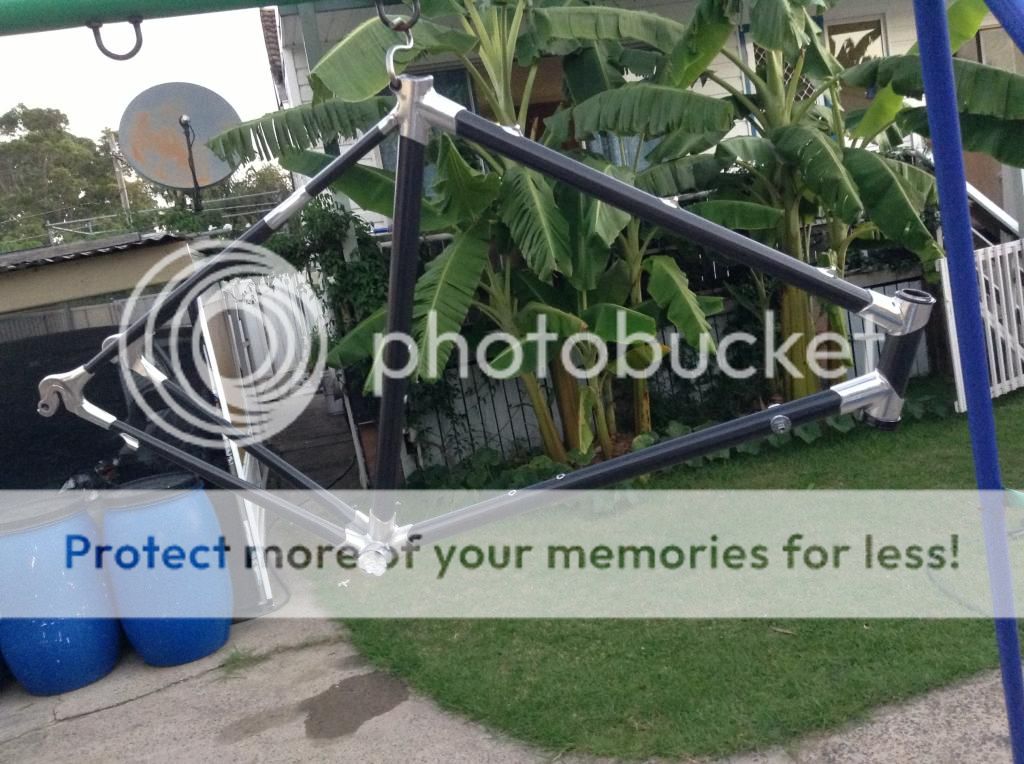

Began polishing the the dropouts since they didnt require sanding.
I started sanding the other lugs, but darkness hit, and I called it a day. Will resume work tomorrow, and hopefully get some paint on!

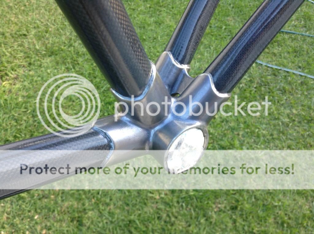

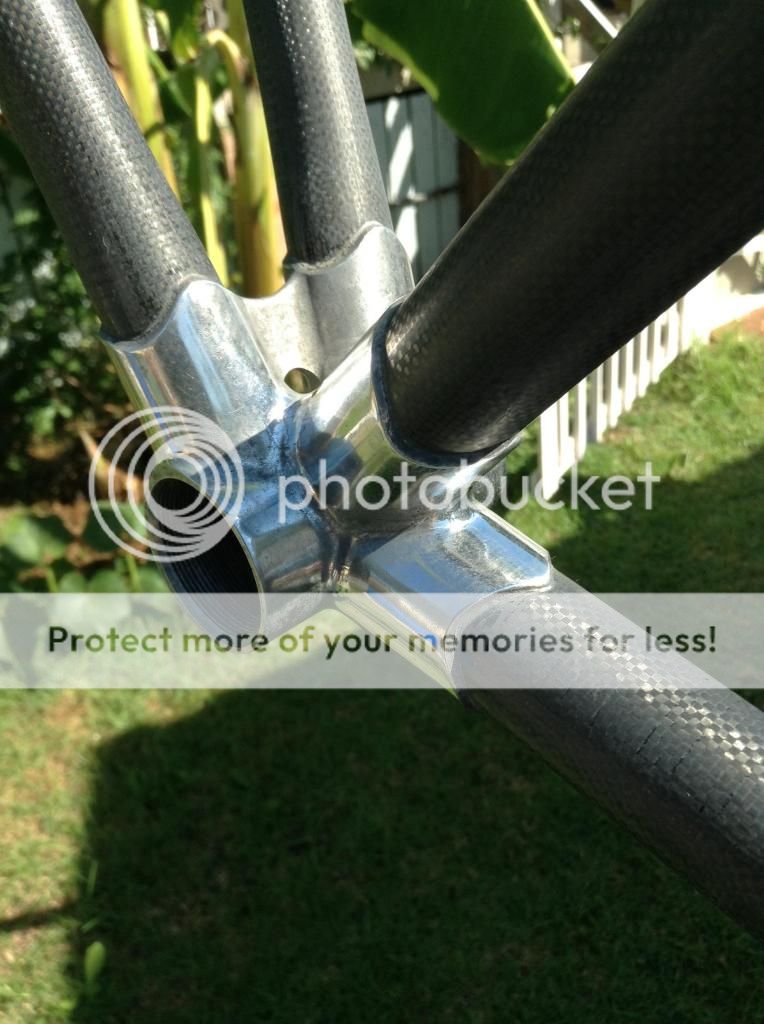

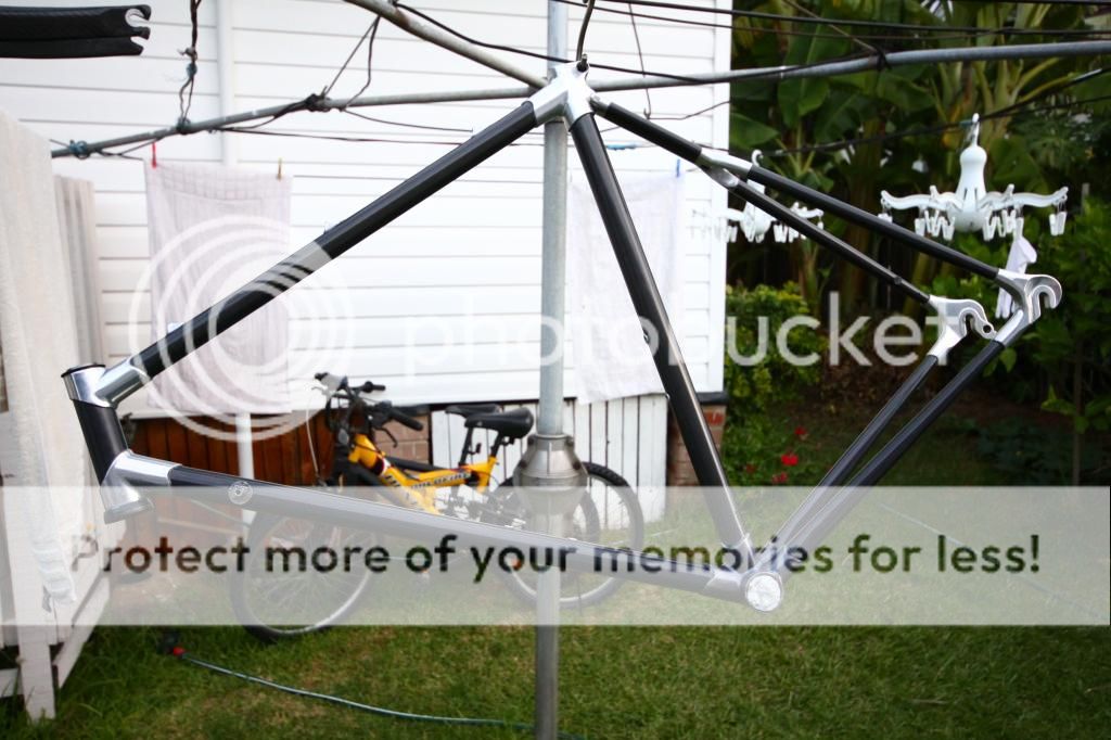

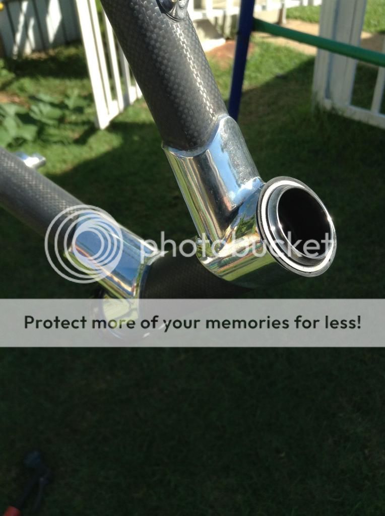

Postby QuangVuong » Sun Apr 14, 2013 6:57 pm
Polishing the rest took forever(5 hours or so).
BB was hard to do, so I did what I could.
Then proceeded with the first couple coats of clear. I am using waterbased polyurethane(Cabots Cabothane Gloss). Its for wood products, but its useful for other purposes as well.
Nice and glossy
Got a few runs in the last coat I sprayed, so Ill sand those areas down and continue clear coating tomorrow.

Painting done! Once stickers get printed, I may add 2 more coats over the top.
Cheated a bit for the BB. I was not bothered fully polishing it, so I just got some chroming powder, and covered it. Not as shiny as the other lugs, but its one colour overall, rather than bright and dark patches light before.
Shiny!
And polished up the forks!

Postby QuangVuong » Tue Apr 16, 2013 7:56 am
Vaeske, you mean the top tube? It's unlikely a razor will damage the carbon as carbon is harder than the metal used in the blade.
Dan, I know I got a little lazy, but that BB area would be just taken too long, plus I was running out of buffing tips. And that part I reckon was casted, not forged and polished like the others. The cast lines were stil there together with the rough sandy surface. This made polishing hard. Getting in there with sandpaper would be almost impossible. But overall, it isn't too bad. It's still shiny, but a shade darker than the others.
