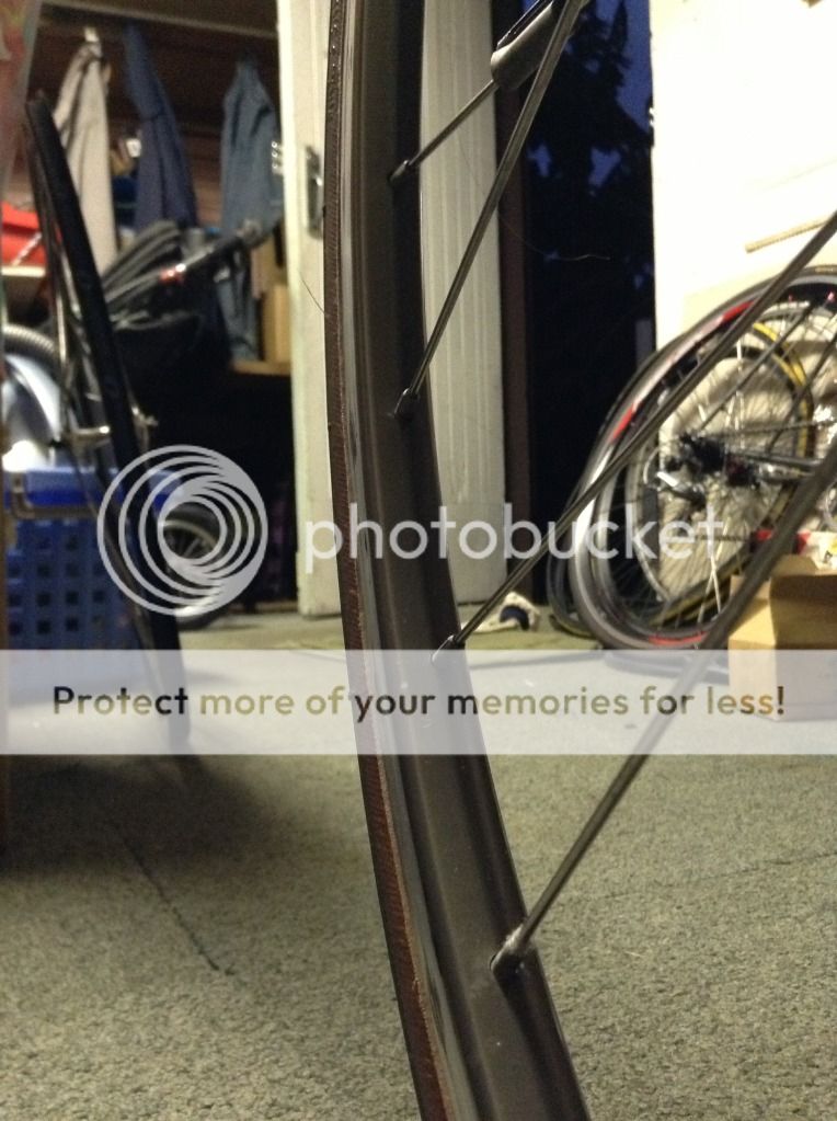

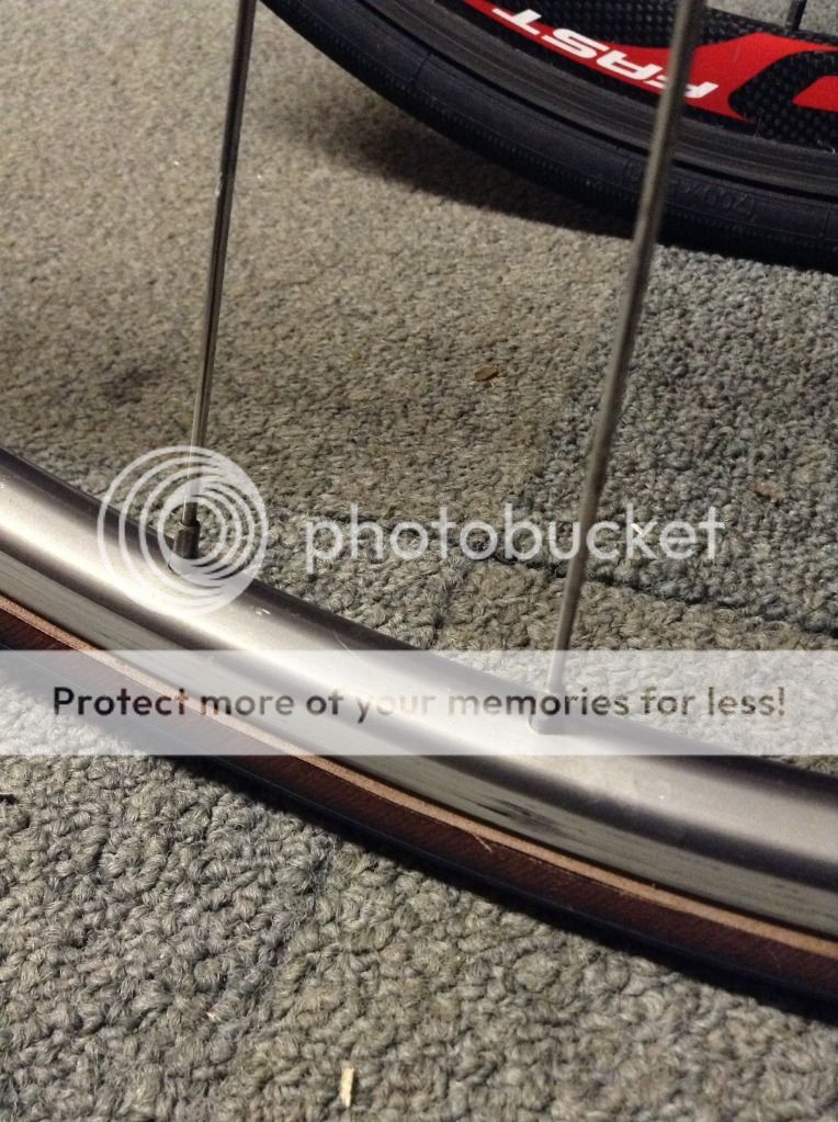

Anyway, these are the rims. What do you reckon it is? Im thinking its Wolber Profil TX or some sort of Araya. If they arent anything special, Ill delace and build some other wheels. Maybe Ill be needing that tensiometer from you Bruce.

Postby LG » Sun Aug 11, 2013 8:14 pm
I'll need to check the shed tomorrow, but think my TX profile rim has a slightly different shape to that.

Re: It's a Bundy!
Postby matt1986 » Mon Aug 12, 2013 9:28 pm
LG wrote:I'll need to check the shed tomorrow, but think my TX profile rim has a slightly different shape to that.
Yep, not so boxy, from memory.

Postby QuangVuong » Tue Aug 13, 2013 9:33 pm
Yeah, I dont think its any good anymore after removing tyres. Turns out they are a single walled rim, and they made up most of the weight of the bike. Delacing them soon, then hubs are off to be built up to Velocity Aeroheads.

Postby rustychisel » Sun Sep 01, 2013 7:28 pm
rims = Araya CT 19 ???
