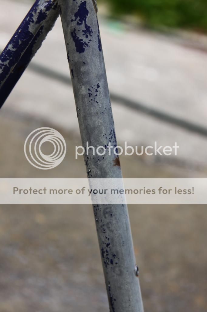

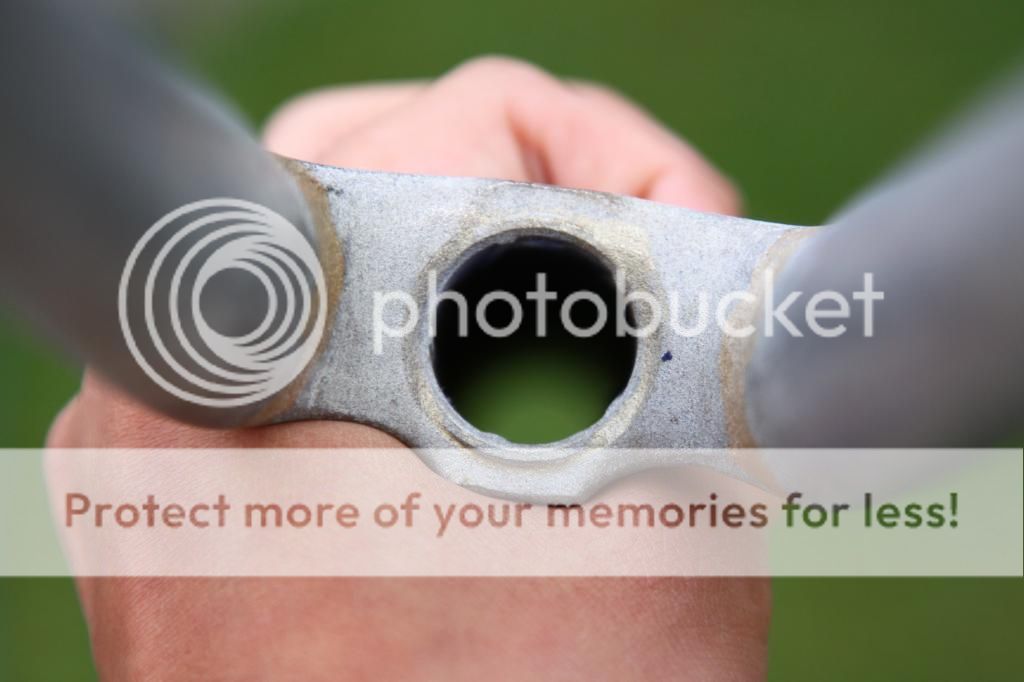

After a while attempting to remove the NDS cup, I decided to follow Dayne's advice and heated up the BB shell today over the stove, and it came out. It was rusted tight, and took a fair bit of effort to remove. But once that was out, I got down to rust removal and paint stripping. Upon stripping, I found out that the purple is not the original colour. It was a neon orange, and had some old logos still on the frame, or a least visible on the primer(both sides of the seat tube as pictured, and both sides of the downtube, directly next to the DT shifter bosses). It reads SEERS Racing. Anyone know anything about that? This bike did come from up in Port Macquarie, which has a cycling shop owned by Graham Seers. I can't seem to find any info of a team or a brand though.
Anyway, heres the frame completely stripped of the old paint
Bundy seatstay
The worst bit of surface rust
And the rifling of the Columbus SLX fork. However, there are no signs of what the frame tubing is. Prob Columbus cause of the Italian BB shell

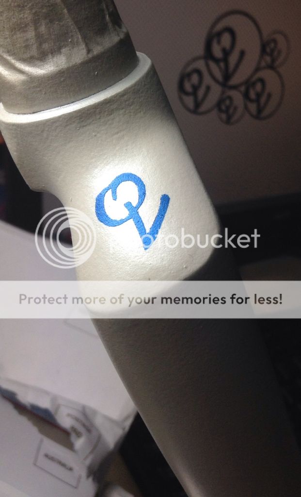

EDIT: Added some touches to my fork crown. Do you guys reckon a Columbus fork sticker would be fitting, or will it be too busy?
Sneak peek of whats going to be on the frame too.

So after a whole year, I finally finished up the paint. I went with a 4 colour fade rather than have QV all over the bike. Decided that it was gonna be too busy.
Only QV logos on the HT, crown, and brake bridge. Will have Bundy decals on the DT whenever I go and find out who actually built this one.

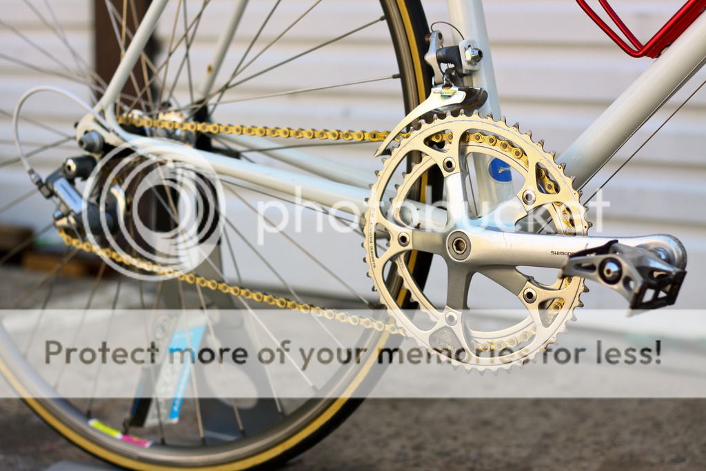

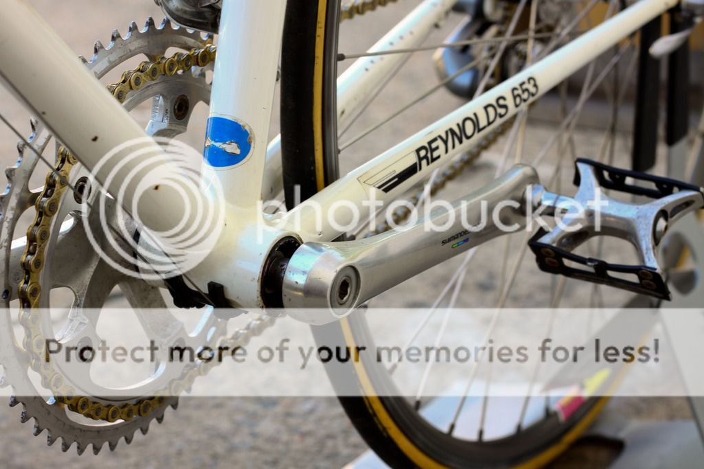

Posts: 1754
It's a Bundy!
Postby QuangVuong » Sun Mar 15, 2015 4:21 pm
Frame cleaned up very well.
Cool braze on tab too.

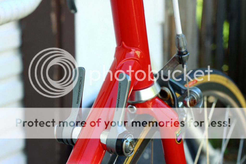

Ive always had thoughts that this wasn't built by Jim himself, and I was spot on when I pulled the bike apart. It definitely is built under the Bundy name, going off the markings on the steerer. Cool little diagram drawn for the paint scheme too.
It was the pinning inside the ST and chainstays which confirmed that it ain't Jim's work. Geoff initally thought it was his, but he reckons from the pinning might be Paul Macdolland's work. Paul was trained 32 years ago by Geoff. Whatever it is, it is a very clean and well built frame. It comes in at 1745g with a 655g fork, which is very decent for a Reynolds 653 frame that is 54 square, with a very long HT.
I have reason to believe that this may be the same builder as my Red Marble frame. They are a few particular details which are very similar. I'll have to continue searching around.
And done. Decided to build it up with a 600 group, since Ive got a couple of those groups lying around. It still does need a cassette though.
Very minimalistic Haden lugs.
I dont know which Superbe Pro pedals these are since someone has chopped and sanded part of the cage off.
The blue sticker on the ST is the guarantee that the frame was built with Haden lugs.
