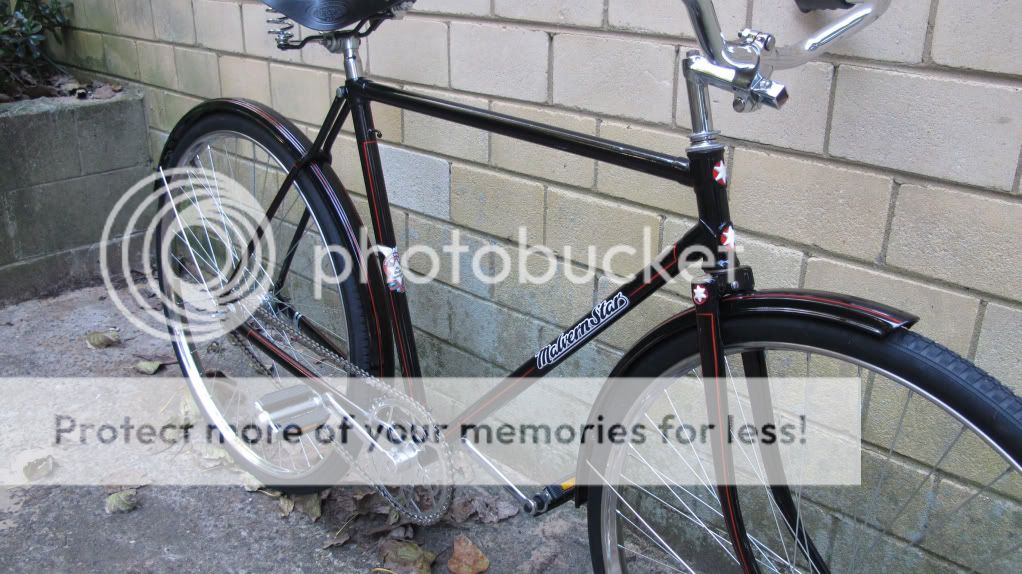

Postby ldrcycles » Sat Nov 30, 2013 11:59 pm
Well now she's almost finished it's time for me to show off my 3 speed race bike :) .
Still needs the decals to be done properly, twine on the bar tape and the shifter bolted on (the standard one wouldn't fit once the bar tape was on), but still did a beautiful job on her maiden race.
I will need to do some research/experimenting though, as while the Sturmey-Archer shifter is workable with the Nexus, it's far from ideal. With the 2nd gear set up correctly, 1st has the cable completely slack and flapping in the breeze, while 3rd is a bit too tight to hold properly. The problem is that the steps in the shifter (1st to 2nd is short, 2nd to 3rd is long) are the opposite to the hub. It still shifted and pedalled exceptionally well, and I really enjoyed that glorious rolling click of the idle gears while pedalling in top :D .
Posts: 8237
Re: 3 speed IGH race bikes?
Postby ldrcycles » Thu Apr 09, 2015 7:07 pm
Finally got around to swapping the Nexus for a Sturmey AW so now the shifting is perfect :) .
