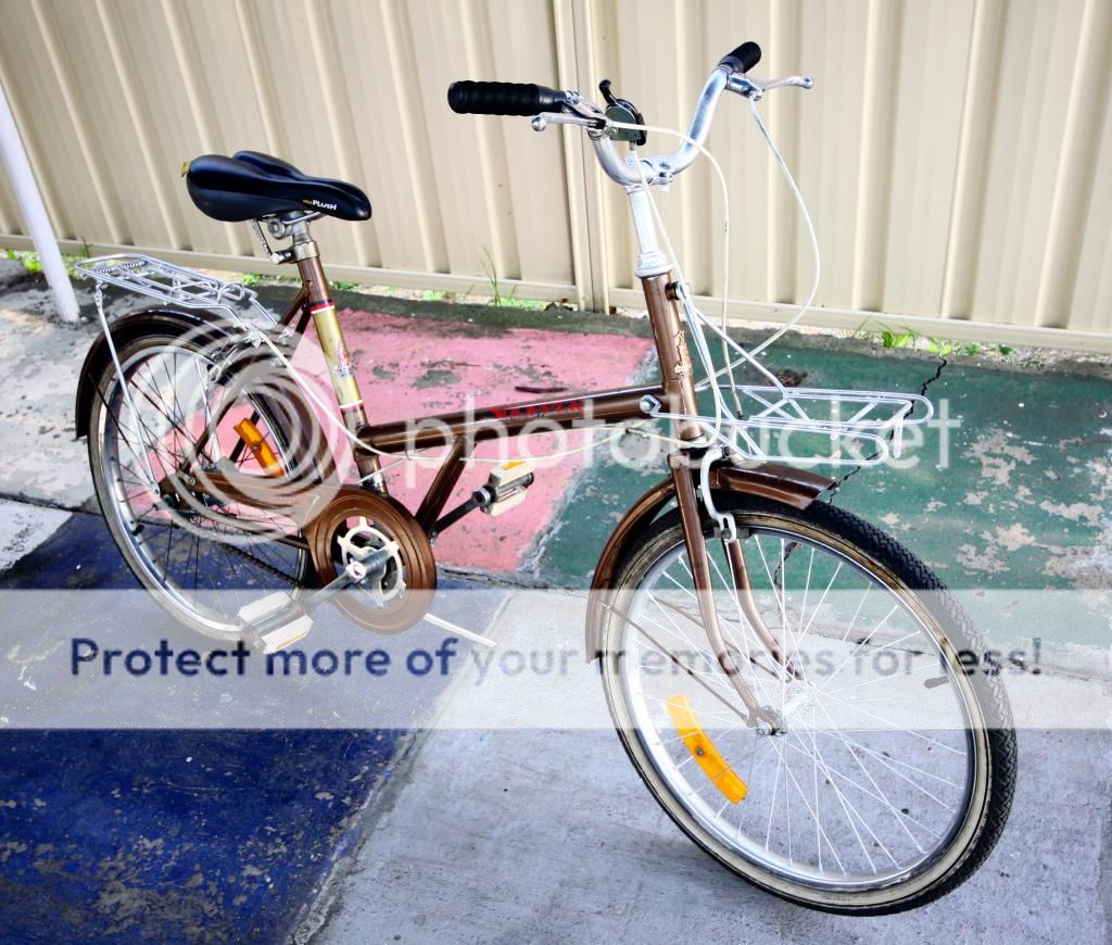

Postby QuangVuong » Thu May 09, 2013 9:51 pm
This Bright Chrome spray paint. Wasnt really expecting anything better than a matallic silver, but it turned out to be quite a nice foggy chrome. Wheels are next up for painting as well.

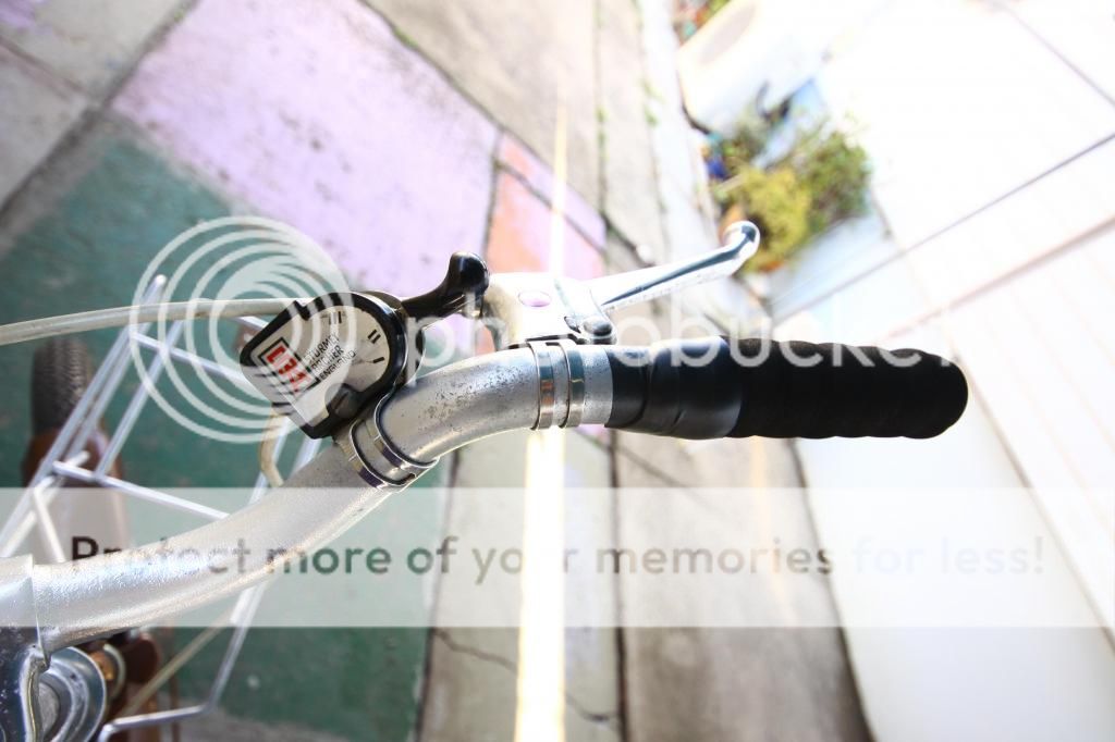

The Raleigh Twenty-Two Shopper done!
Polished up the levers. Bit hard to see though. Bar tape works well, and prob will just stick with that. Its comfier than the plastic grips from before.

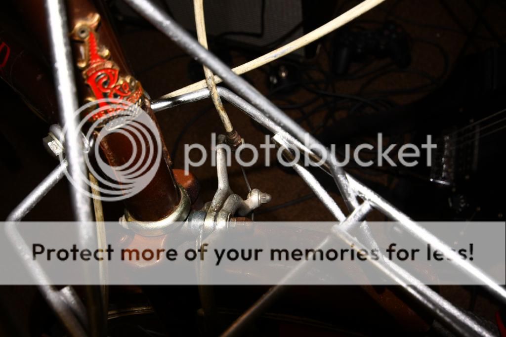

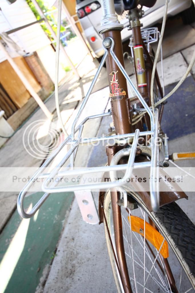

But theres a slight issue. The housing gets caught in the front rack when turning left which makes it brake. Theres no other place to route the housing. Oh well, the brake isnt that strong so it wouldnt cause an accident.

Does it just need a longer cable with a bit more slack in it?
Posts: 1774
Re: Raleigh Twenty
Postby QuangVuong » Sat May 11, 2013 1:16 pm
Yeah, went up and down the street to test safety and brakes. Rear brealy does anything, and front works well enough.
As for the front housing, its super long already. Its just that the rack gets in the way. Dont think theres anyway to get around that other than removing the rack.

I haven't seen a frame mounted front rack before - my BSA 20 has a front rack but its mounted to the fork. Does the cable snag when you're riding or just when you're testing it out while standing still?
Removing the rack is probably the easiest option unless routing the cable like a centre pull down the middle gives you a bit more slack. Converting to a centre pull brake is another possibility?

Well this was a success. Mum didn't didn't see it over the week, so it remained a secret up til today. She's happy with it, and I found out that she had a similar bike ages ago
Anyway, looks like that auto raking issue isn't too bad. I loosened the barrel adjuster anchor bolt, and that allowed the housing to flex a bit without it causin the brakes to pull in. And will be buying those leather pads soon. Or could buy some 22" alloy rims(some on eBay for only $19 per rim) and save on the price of pads.
