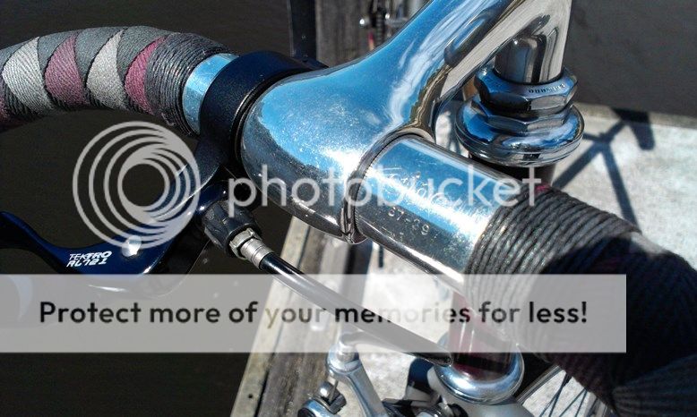

Well we can't have a Dura-Ace AX thread without the best bit - hidden bolt stems!
When I bought my McBain it came with an AX stem and AX 'aero' seat post to fit* the Tange Aero tubing. I originally wanted a full AX groupset, but soon discovered it only came as a road group, so just kept the stem and seatpost. I kinda like how optimistic the early 80's aero thing was; as if a slightly modified shape was going to really counter the big chunk of flesh and bones sitting atop the saddle!
I polished out the silkscreened D-A AX logos which were pretty banged up anyway. The stem was missing the cap when I bought it, so I had a buy a whole new stem just for a cap!
If money (or time) was no object I'd love to find some AX bars to put on it as there's not many bars that match the AX stem's 26.0 clamp. The grub screw seatpost, er, binder is arguably the worst thing to come out of that aero period.
* It doesn't fit very well.
