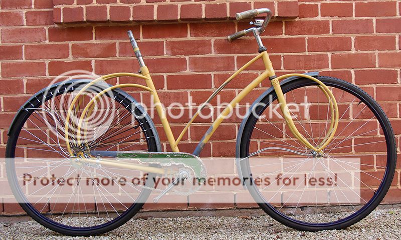

I bought one for my wife.
The serial number indicates it was produced in Melbourne in 1948.
I had it blasted to see the state of the frame, which was very good, with only a minor ding on one to the pair of thin downtubes. I sprayed the frame and forks with etch primer and a putty coat.
Slowly I have been accumulating parts; rims and hubs, mudguards, chainguard, crankset. I had a chainring made.
Last weekend my ever resourceful brother-in-law filled the ding, filled in the original mudguard and chainguard drilled holes which needed repositioning to suit this frame, as well as brazed on a new chainguard mount also to match this frame.
I have rebuilt it to check all parts are in the right position before I strip it down and start the preparation for painting.

These go at the back of the saddle and allow the bag loops to pass through the leather clad rear section of the saddle.
The custom made saddle bag has arrived.
I am currently reading up on the printing on and/or etching of aluminium for a custom saddle name badge.
And I think I have found the source for the paint for the thin coloured band on the tyres.
