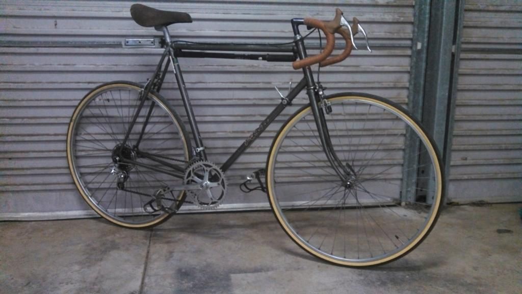

I just picked this bike up with a view to reliving my youth, (although the black 10 speed I had back then was a cheap steel framed, steel wheeled, foam-hand-gripped thing), and I wasn't expecting much when I went to get it, but from my limited knowledge based on what I've read on here, it seems to have some decent bits on it. Suntour derailers which work perfectly, some sort of Italian handlebars, a suede seat which is unfortunately damaged, and alloy rims. Not too mention a decent looking frame.
I'm going to tidy it up a bit, don't know about painting it, put new brake cables, pads, tyres, etc. I was after some feedback on the boots that go around the brake levers, grip tape, and a new seat possibly. Basically i'm after a bit of advice on aesthetics. I'm new to fixing up bicycles and i'd like it to look "right"
Thanks in advance.
p.s. any info on the bike itself would be great.

so you need some new rubber 'brake hoods' for your levers.
what brand are the brake levers? ebay might be the best place to start looking.
same with the handlebar tape. some faux-leather stuff would be the correct period. you can get black, white, tan, and every colour in between. Ambrosio bar tape is nice, and good value.

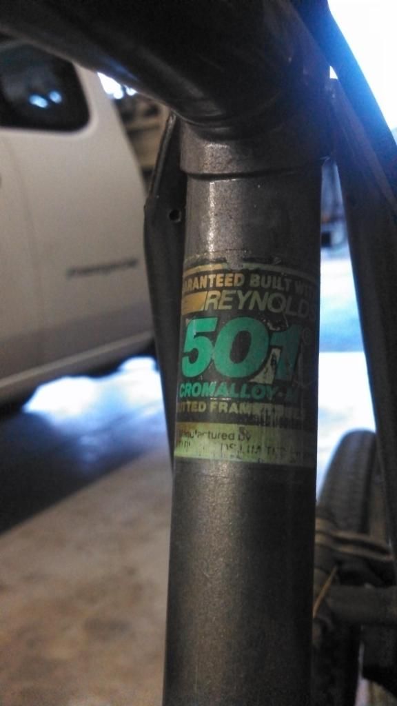

a reynolds 501 frame is decent - falcon made mostly mid-range and better frames. yours is entry/mid-level. certainly a keeper if it's your size.
as for aesthetics, keep the original paint if you can. finding the correct decals might be a challenge, and a cheap paintjob turns a half-decent bike into another random clunker.
are the wheels 27" or 700c?

+1 for keeping original paint, but I'd put some new Tektro aero levers on it with dual pivot brake calipers of some type.

Looks like a good solid project base. Not too cheap & nasty on the other hand nothing too delicate from the top shelf to regret anything by way damage or cross pedigree. :D
I'd just start by carefully stripping it all back and cleaning the various parts, reading and researching as you go. What you replace will and can be dictated by a number of factors besides wanton opinions on here ;)
Depending on how thorough you want to be, how worn things are as it's found, or merely how much coin you want to throw at it you could quite easily get away with with just replacing a few basic consumables like tyres, brake pads and cables... maybe even just one or two of those.
I wouldn't go putting a new chain on it without assessing relative wear of the existing ring/cassette/chain combo. Clean it up and ride as is. I'd only start worrying about that if the drive train slips in any particular gear.
Nb: gear slipping is where the chain seems to suddenly lurch over a tooth, but otherwise stay in that gear selection.
Gear skipping, or involuntary shifting (most often from low to high; bigger sprocket to small at the back) is indicative of seperate issues.

Thanks for all the info guys. I cleaned a little of the grime off the bike this morning to see what was under there. It has 3ttt handlebars with drilled black anodised Galli brake levers. The front wheel looks to be the original Weinmann as are the brake calipers. The wheels are both 27"
I couldn't find any brake lever covers online, I might take them into the local bike shop and see what they have.
Any recommendations on a suitable looking set of tyres?

I'm building up an 80s 501 frame at the moment and I'm curious if you can tell me what you seat post diameter is. Mine's 26.8mm wondering if thats standard across all 501 seat tubes.

You can get replacement brake hoods from e-Bay. Cane Creek make top quality ones in black or tan or there are other cheaper options like
http://www.ebay.com.au/itm/OLD-SCHOOL-BRAKE-HOODS-BLACK-RUBBER-BRAKE-HOODS-VINTAGE-BRAKE-HOODS-/301293389018?pt=AU_Sport_Cycling_Parts&hash=item46267c44da
You have a nice bike there from about halfway down the Falcon range, a full 501 frame is not bad at all, enjoy!

G'day mate, this one measures 26.8 as well if that helps?

Nothing too exciting, new tyres/tubes. Some dia compe aero levers and nice new bar tape. Don't know what to do about the seat, can you recover them?

Yep suede seats are Easy to recover, looking good so far

paulos wrote:Nothing too exciting, new tyres/tubes. Some dia compe aero levers and nice new bar tape. Don't know what to do about the seat, can you recover them?
Very nice, that's all it needed really. You might find it cheaper to buy a new saddle rather than re-cover the old one. Some good buys available on e-Bay, or, if you are not into doing big distances, a saddle cover.
