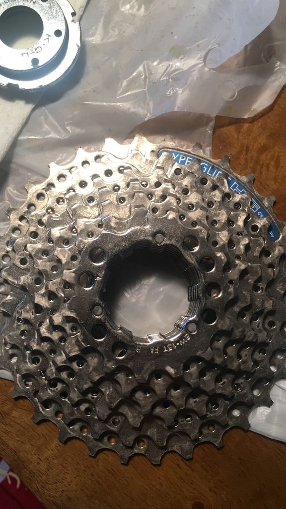

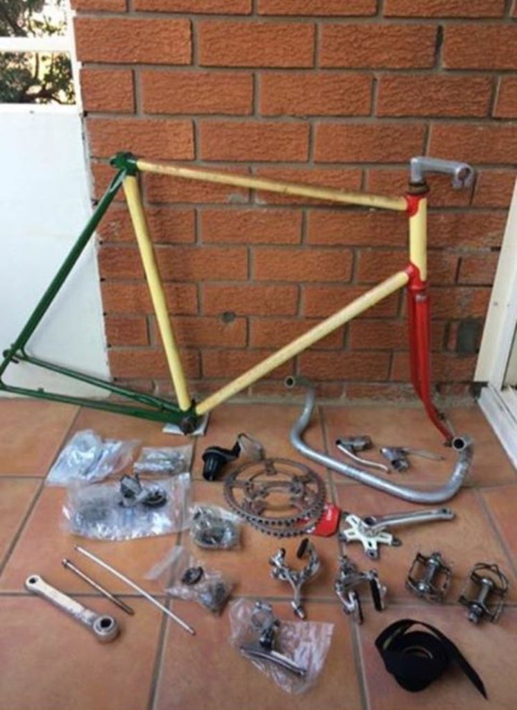

I'm hoping to do this build on the cheap - that, is to see if I can salvage parts and do what I can with what I have in hand.
I found a 8 speed MTB cassette in my piles of parts and was well on my way to paint stripper yesterday when I came to the realisation that the quill is stuck in the steerer tube.. Nooooo!!!

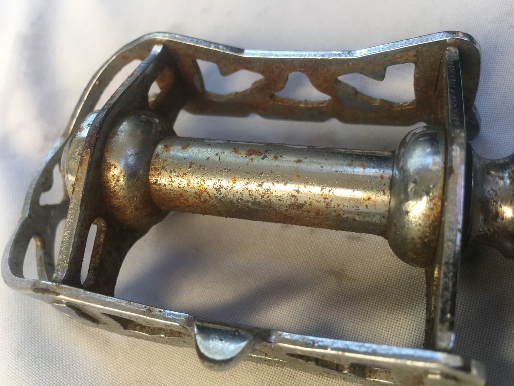

So tonight I'm going to pour down some vinegar and hope it dislodges the galvanic bond/rust given the wedge is loose. I fear, however, that I will be needing a new quill after cutting this one off if need be.
also have an old aluminium wheel with a 8 speed suntour freewheel on it I need to try and take off. Might work well as a temporary if the MTB cassett doesn't work given the sixe of the cogs and me using a Arabesque RD.

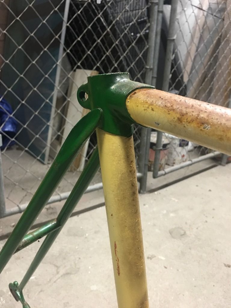

It’s interesting you mention Italy as the lady who sold it to me was Italian! Her hubby was under instruction to downsize so I got a bargain I think.

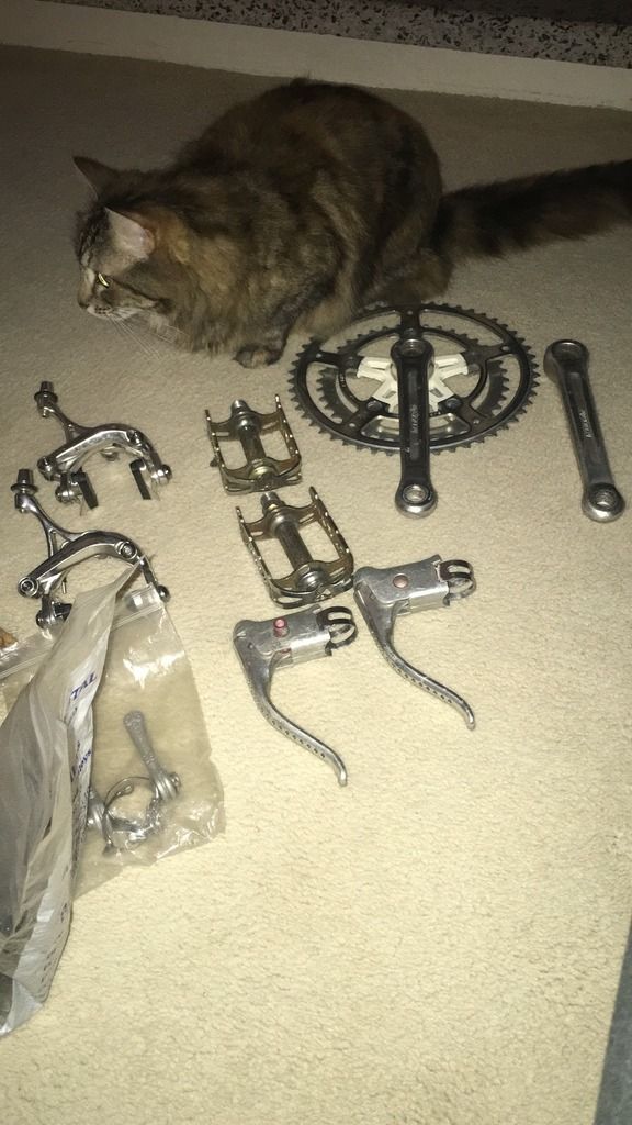

Interestingly the parts it came with included a pair of brand new Campagnolo brake calipers which is unusual given the vintage of all the Japanese componentry.
I’m hopefully going to get closer to knowing what’s up when I get to strip the frame this weekend but I suspect your early 70’s guess is close given the frame only has a couple of braze ons and the rest is clamp on.

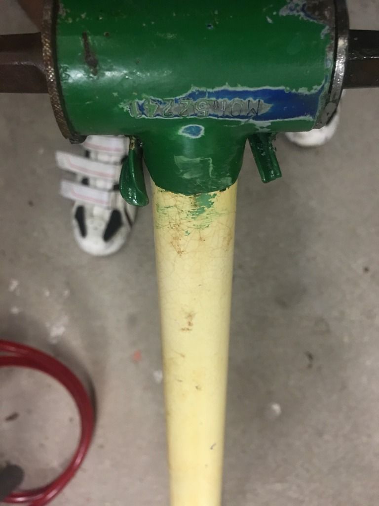

The B.B. is also “English” so I doubt it is Italian but rather painted to look like it was from there. I’ll snap some close up pictures soon. Might help in the ID process.

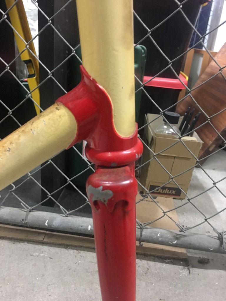

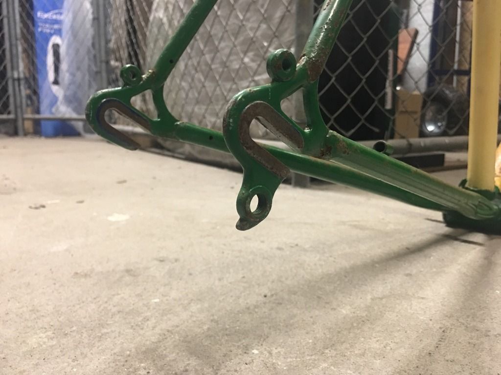

I don't know if this will help to identify the builder but the rear stays appear to be brazed to the seat tube cluster quite low down on the cluster. Perhaps an explanation might be that the frame builder only had a slightly short length stay tube available. I suspected the bottom bracket was British. Are the dropouts Campagnolo as they don't look to be Campagnolo to me (no adjuster screws and large diameter eyelets). It will be interesting to see if there is any identifying marks on the front fork steerer tube when you finally separate it from the main frame.
I have had great success burning paint off frames in the past. I had access to an Oxy Acetylene set and it proved to be a wonderful means of paint removal as well as normalising the frame - stress relieving too. It is easy to control and the frames never changed colour.

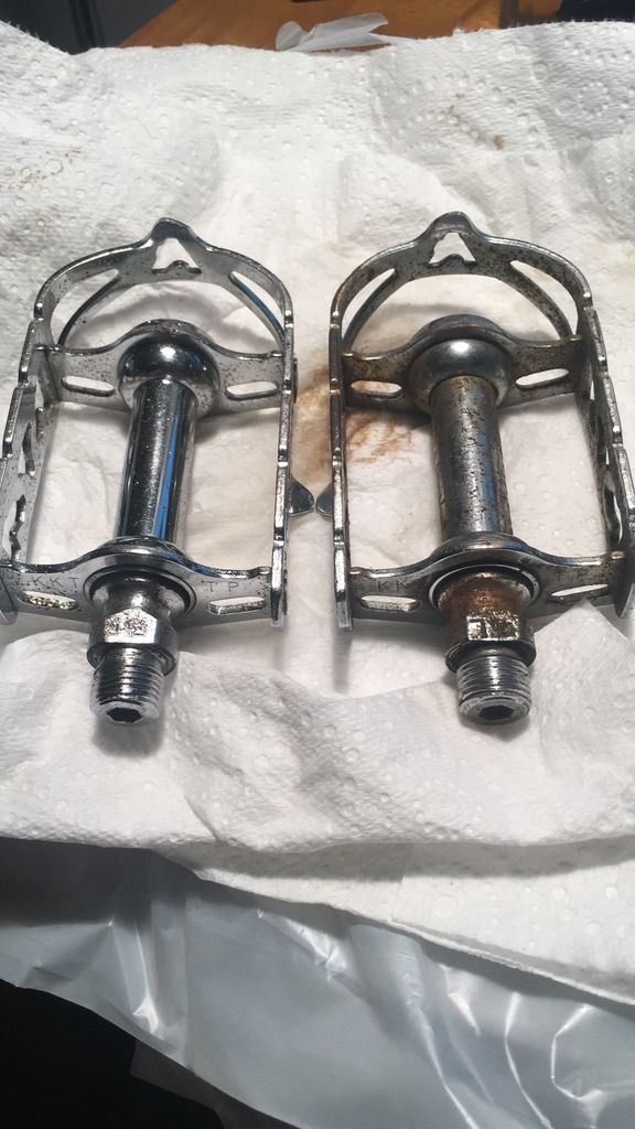

Postby zedries » Thu Dec 21, 2017 7:04 pm
Thought I would post more pictures, coz lets be honest - No one reads the dribble:

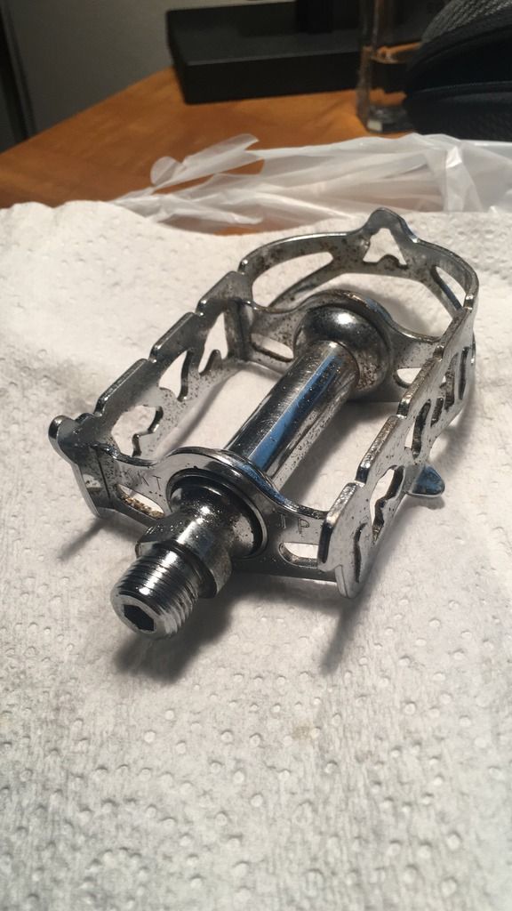

pedal before evapo-rust bath
Pedal after:
Comparison:
I did polish them with some light turtle wax compound polish but will probably use my metal polish and a polishing wheel/rotary tool when I have some time but pretty happy how well the evapo-rust worked. Pity its so pricey.

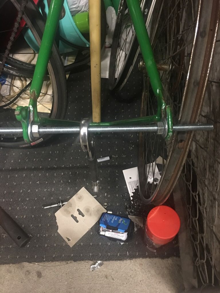

Cold setting the drops to accept the 130mm spacing I need for a 700c wheel with an 8 speed cassette:
the cleaned up cassette I was proposing to use (but I think there are too many teeth. Believe it or not this was rusty:

No i don't believe they are campy dropouts.
good thinking on the rear stays, although it may also be that frame is really tall? I'm new to the world of steel frames so I don't know exactly how to measure it but I suspect this is a large/xl sized frame. I'll have a better idea once I test fit wheels etc now that I have the rear drop outs widened.
Wish I could do the burn off... unfortunately I don't have a garage where I can easily perform that, just a storage cage int he basement of an old apartment block. I could get away with using the paint stripper I have but I dare not have any flames burning. (I've not been able to use my MIG in a long time and I suspect my skills have long since deteriorated for the same reason).
Here's a pic of the BB serial number: MOH52241
THe only reference matching I've found on the interwebs has been for a Murray. But that would put it at a 1940's era frame which I doubt.

Think the brake calipers may give you grief. Are they nutted or recessed mount? And if recessed, will the frame take recessed mount brakes? Also the question of whether they will reach...700c in 70s frames often need a longer reach caliper like the Tektro r539 or r559. Can get these in nutted mount.
Or you can drill the frame to accept recessed mount but the rear brake bridge is a pain...

Stick with the newer wheel would be my advice. Steel 27 inch rims are not an ideal braking experience, especially when wet.

Paint stripper will work well. It's interesting to see the original blue paint under the green. The components appear to be cleaning up well.
It's nice to see the brazed on cable guides on the bottom bracket - yet another indicator to the age of the frame. For instance, Campagnolo advertised a small braze on cable ferrule (for brazing to the bottom bracket to guide the gear cable) in 1958. It wasn't until 1969 that Campagnolo advertised a larger, longer braze on cable ferrule for the gear cable. You have this longer type of cable ferrule brazed to your bottom bracket (along with the smaller cable ferrule). A number of component manufacturers did produce similar cable ferrules. (Suntour, Shimano, Simplex, Hurret, etc). Just using the Campagnolo example, I would say your frame is perhaps a late 60's frame but, more confidently, an early 70's frame at the earliest. That's not to say that the frame could have been produced at any time in the 70's and perhaps into the early 80's but with the lack of other brazed on components I would say early 70's is your best bet.

Well I'm going with Haden (UK) for the lugset, fork crown and seat stay tops, especially the seat stay tops, I still have a few of those in the box in the workshop. The stays do end low as GaryF says.. Dropouts look like standard Haden kit Maybe all sourced from Brit-Int in Castle Hill back in the day? I'm reckoning an Oz build back in the 70's - 80's period probably with pretty decent tubing of some sort. Else maybe a Japanese build from the same period given the frame number. They were big on using Haden components. Not that big a frame for the period. I'm 5 foot 9 inches and I ride a 58cm centre to centre seat tube on 70's-80's bikes and back in the 70's racers got their leg over the biggest frame possible so I have 60 cm c-c frames in my collection that I ride frequently.

I've been struggling with this frame in my mind since the post came up. Looks similar to another frame I've seen, but can't remember where or when, or what it was. Just thought of something as well, re the pedals, which came up nicely.
If they went into the evapo-rust bath fully assembled, will need disassembling and re-greasing and possibly new ball bearings. Easy job, just fiddly, much easier with a bench vice.
