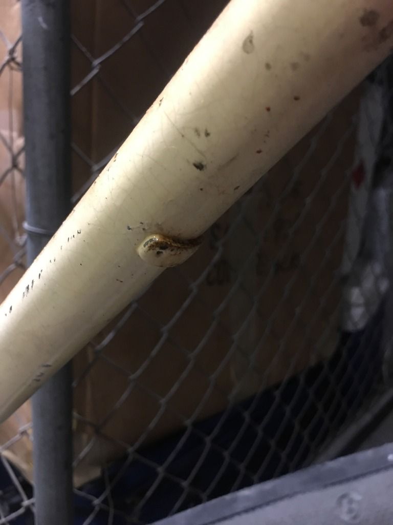

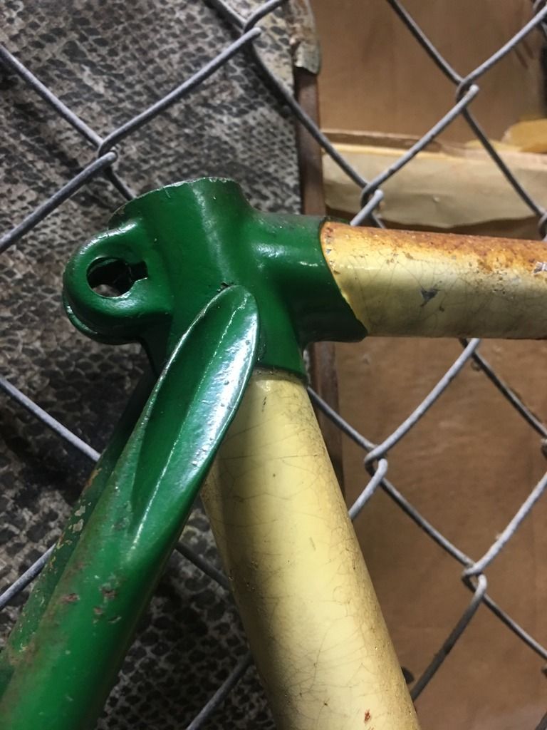

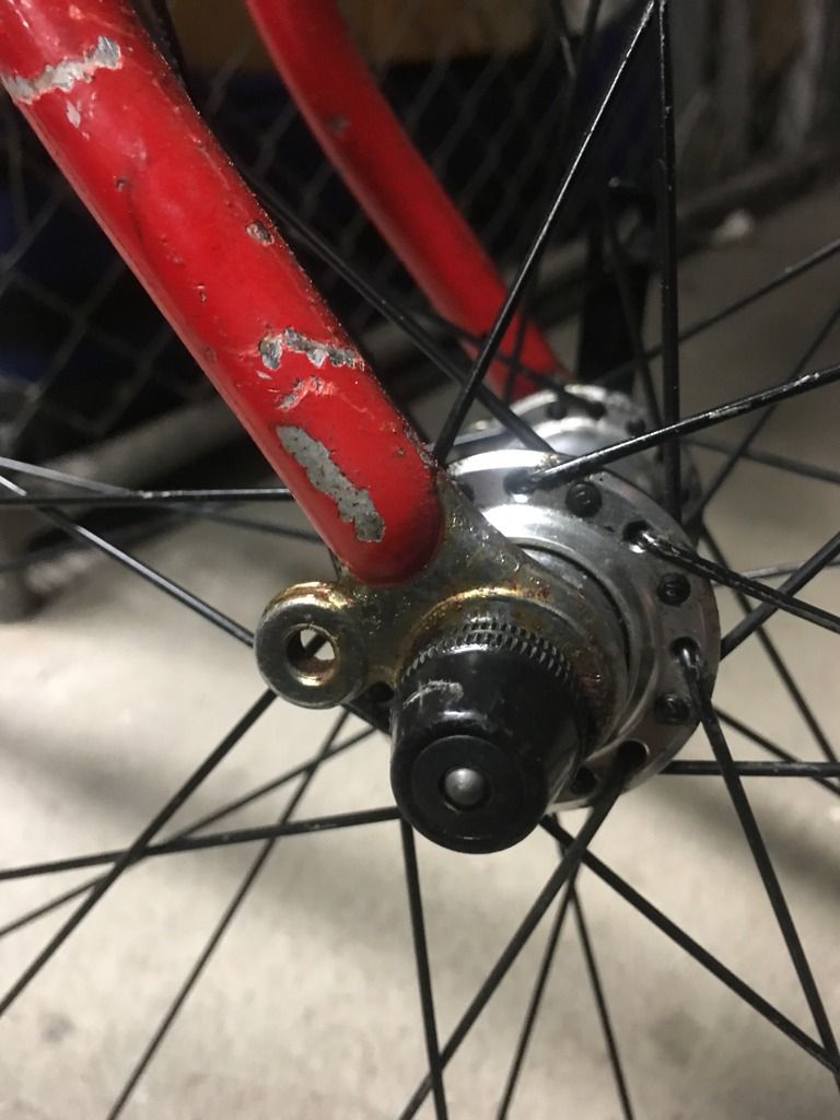

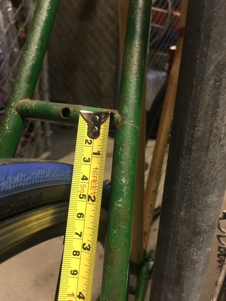

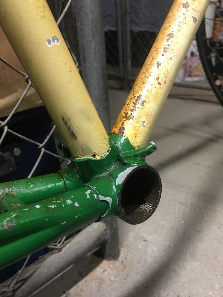

Ok so as promised I fitted a set of wheels from my road bike to test the drop for the brake caliper reach. I’m not sure what I am looking for so hoping these measurements help get some guidance from all you wonderful people.
Anyway, enough talk, more pics:
I also couldn’t find any identifiers for the drop outs either front or rear
I also trust that the frame is really old as I was only able to locate braze ons for the cable guides on the top of the BB barrel and also the cable guide for the RD.
He last one being under the down tube which has the braze on for the clamp on dt shifter
More pics of the lug set

I think from a braking perspective, you may be stuck with either nutted Tektro r559 calipers Image.
If you want to go retro, some centre-pulls Image, and Paul Engineering and Velo Orange both do modern repro calipers, but it's a much more expensive proposition and would only make sense if you want to run mudguards and/or racks.
The Tektro can be had for $50-60 depending on how lucky you are, and will be much more effective (after you get rid of the Tektro OEM pads) than the centre-pulls.

zedries wrote:Ok so as promised I fitted a set of wheels from my road bike to test the drop for the brake caliper reach.
Going by the pic, you'll need a 57mm drop. I'd go for a long reach caliper. The Tektro 559s are a pretty good brake for the price.

Postby TopSide » Sun Jan 14, 2018 7:20 am
The frame number on the BB is from the manufacturer Miki of Sakai Japan. The M is for Miki, the 0 is for the year 1980, the next letter H is the month of manufacture, August.
Several Australian brand names used Miki frames: Borsari in Melbourne, Apollo V model in some years were Miki frames.
