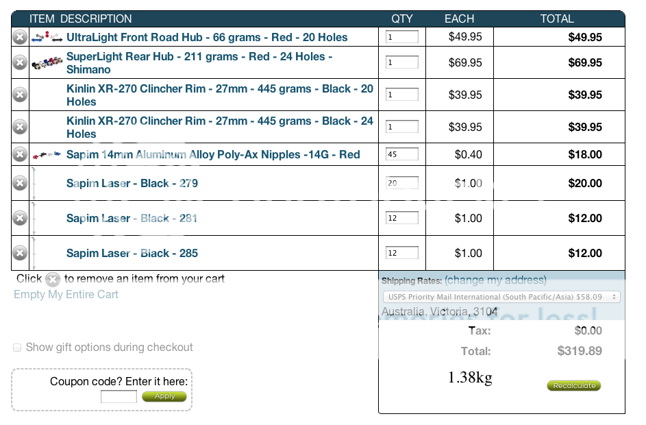

Ok guys, here is my final setup. I went for a radial lacing for the front and 2x lacing for the rear. Any comments?

Postby Mulger bill » Wed Oct 10, 2012 9:27 pm
Yep, read the book at least three times before you touch anything and find a scruffy old wheel you can pull down and rebuild for practice.

Don't lace the rear 3 cross, the spoke angle will be too high, I sugges 2x and radial or 1x on the front, make sure you can lace the hub radial, radial lacing puts extra strain on the wheel and some hubs weren't built to be laced radial. Also, I won't use the Sapim Laser on the rear drive side, its a VERY thin spoke and you may have some issues with it, I'd go for the Sapim Race on the rear drive side. If you're building yourself I'd avoid the laser altogether, its really easy to twist and wind up so its a pain to work with, go with the CX-Ray if you are building yourself as the bladed profile will allow you to see spoke wind-up and help you avoid it. And use 12mm nipples, 14mm may make your spokes too long

+1 on the spare spokes and nipples, but I don't think the book is necessary, all the info you need is on Sheldon's site and miketechinfo.com. Pulling an old wheel apart may not be such a good idea as rebuilding an old wheel is MUCH harder than starting from scratch
