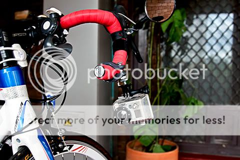

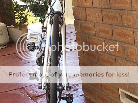

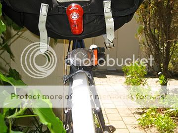

1) Q: Is there a preferred place to mount a camera on the rear of a bike?
A: It’s just a matter of finding the right place, so it is not obstructed by a bag or light etc. You also need to have the camera mounted so your leg doesn’t knock it while pedalling. I find its better to mount it down low on the rear seat stay. I feel this gives a better view of number plates. You would need to have the camera in a case though, just in case any debris or water is thrown up by the wheel.

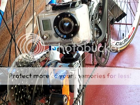

2) Q: I have a GoPro and used one of the stick on mounts. I put it in the wrong place though and want to remove it. Is there an easy way to get them off?
A: Yep, been there, done that. When they stick, they are stuck. Use a blow dryer on hot and medium flow. Warm it up for approx 3 or 4 minutes, then pull on one side...slowly. Once it starts to pull away use the blow dryer for approx another 30 seconds. Then pull and repeat until it comes off. If the sticky 3M stays on just pull it very slowly off. Then by touching it as little as possible put it back on the mount. Now you can remount it and it will be just as strong. As an added security I always use a lanyard.

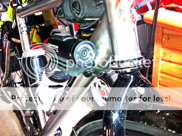

4) Q: I have tightened my mount as much as I can, but the footage still seems shaky, like the mount is loose.
A: Make sure you only use a THIN piece of rubber, between the bike and the mount. If it is too thick it tends to allow the mount to move or flex. You could always use some electrical tape to protect the paint and small strips of rubber from an old tube to help with grip/dampening. Also check the connection between the camera and mount. If you are using normal Velcro, try using some 3M Dual Lock instead.
5) Q: Does it matter if the mount sticks out a bit?

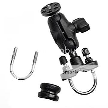

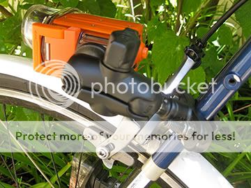

A: if you are using something like a Ram Mount, it should be fine. If you are not, then you need to keep the mount short, having any type of long arm etc on the mount will introduce vibrations because it will flex too much. Another thing to keep in mind is the position of the mount. If it sticks out and is too close to your leg, you will knock the camera when pedalling.

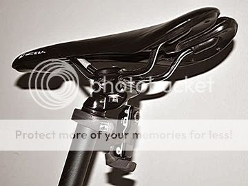

6) Q: I have a Carradice bag on my bike, so I can't mount it to the seat post.
A: You could always use a Ram Mount, these things are really sturdy even when they are completely straight. You could attach it to the V section near the seat post at top of the rear seat stays. This will allow the camera to go under the bag. It will also be tucked in quite nicely, so you wouldn’t be knocking it when pedalling.

12) Q: Which is best, helmet mount, bar mount or rear mount?
A: It depends. I find that having the camera mounted on the helmet allows me to record where I am looking. But I find that the footage is too jerky because of all the sudden head movements.
Having it mounted to the helmet may have its advantages. Things like capturing your head checks, hand signals and possibly braking. It can be a little harder to line the camera up properly if you don't have a preview screen or are using a camera with a narrow field of view. Especially if you ride a road bike and move into the drops, you might find you are only recording the road directly in front of the wheel.
As for bars or rear, both are good options. Before I had two cameras, I mainly used it on the rear, because I figured I could see what was ahead of me, but didn't always know what was going on behind me and in the event of an accident it may at least be caught on camera.

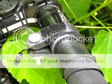

14) Q: The Velcro I am using on my mount does not stick very well and the camera still seems to be a bit wobbly.
A: Use 3M Dual Lock. It is far superior to normal Velcro. It will hold the camera really securely and there is no movement. It does not fray like other Velcro does after you have been using it for awhile. When you snap the two together, it holds extremely well with no movement.

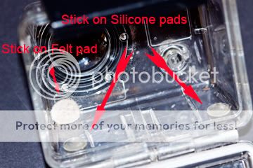

18) Q: I have a GoPro and can’t seem to get rid of that rattling sound.
A: That rattling can be caused by different things. It maybe the camera is moving slightly inside the case, it maybe the quick release mounts or the little screws on some of the quick release mounts might be loose.

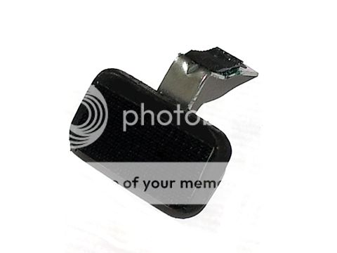

To stop the rattle when using the Chest Mount, start by making sure the screws are tight, slide the bracket off the chest mount and tighten the screws.
• The buckle on the chest plate rubs against the plate and this can cause it make a little bit of noise. Adding some padding will stop this, make sure you add the padding under the buckle and also along the outer edge.

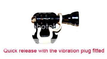

• You should also have a Quick-Release/Vibration Plug. Use this on all of your quick release mounts. It stops the two parts rattling against each other.
• Slide the ring over the thumb bolt.
• It should look like this when it's installed correctly.
• If you are still having problems with rattling noise buy some of those really small stick on Silicone or Felt pads. I have used two Silicone pads and one Felt pad to make sure there is no camera movement inside the case.
• The pads are available from Bunnings for a few bucks

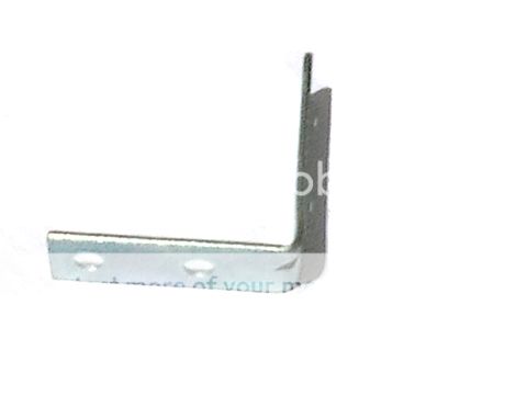

This mount can be used with any camera that has a tripod mount. I have this mounted to the MTB, but it is just as good on a road bike.
It consists of 1 x Small flat L shaped bracket, 1 x Small Ballhead, 1x Small hose clamp, a thin strip of rubber to go under the hose clamp and a nut and bolt to fit a tripod thread.

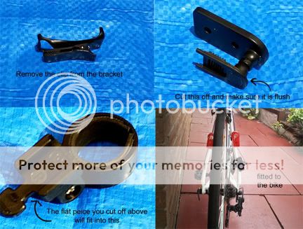

While the MD80 comes with a few different mounts, they are not that flash, they are just cheap plastic, and they will more than likely break after some time.

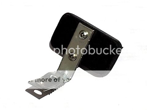

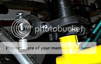

This mount is designed to attach to the Rear Seat Stay. I have taken a couple of those mounts and converted them to make one, so it can be used on an old light mount.
You will need the following: 2 small nuts & bolts, an old light mount that is designed to fit a rear seat stay and the MD80 bracket with the clip attached, also the magnetic plate that has a stand plate attached via a plastic ball joint as well as a small piece of rubber to use inside the light mount.
First you need to cut the plate off the magnetic stand base, be sure it is flush on the ball joint side. This will be used to slide into the light bracket. This will only fit one way, so you have to connect the bracket to the side the ball joint was on. Next remove the clip from the bracket this will be used to hold the camera onto the mount.
Line up the bracket on the piece you just cut off the magnetic plate and drill two small holes.
Attach the bracket using two very small bolts with nuts, the bolts have to have a flat head or the camera won't fit into the bracket.
They also cannot protrude past that indent or it won't slide onto the light mount, I just cut them off flush. I didn't line up the holes properly when I drilled them so it is a bit lop sided. Put the rubber strip inside the light mount to protect the paint
Here are the parts I used and a shot of the camera mounted to the bike.

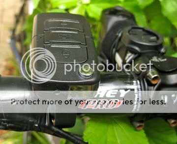

Jumbo 808 and 808 #11 Keychain Camera
Mount 1
Weather Resistant Case for Jumbo and External Battery
Credit: Graeme
This can be used with the External Battery pack and the Jumbo 808 Camera.

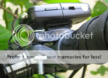

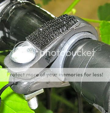

To mount this on a bike, you will need a bracket that has a 3m Dual Lock Velcro base. Use some 3M Dual Lock and attach some to the underside of the case. The Dual Lock will hold it really firm without any movement, unlike other types of Velcro.
The battery and camera do not move once the lid it put on properly. You may also need to put some small holes in the bottom of the case, to allow heat to escape and stop the lens fogging up.

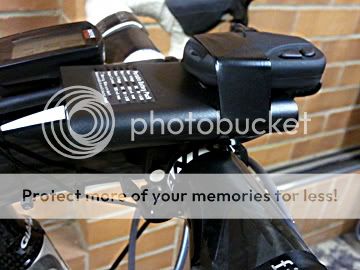

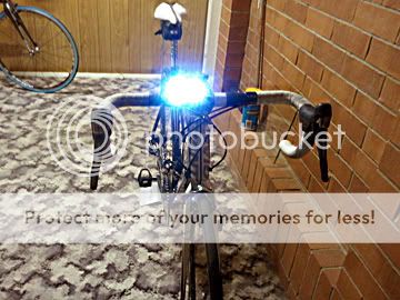

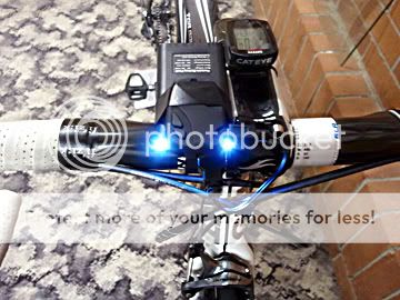

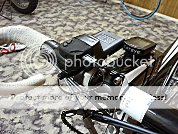

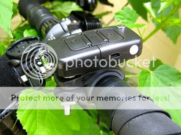

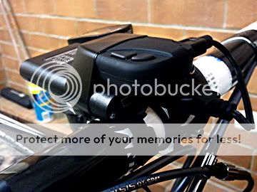

This is my current setup, I removed an unused light from its handlebar mount and some double sided tape to hold it all together. I also used some insulation tape for good measure. The LEDs are quite bright too, for a battery it makes a pretty good headlight.

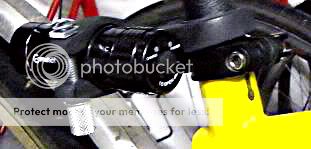

I decided to see how a wooden mount would hold up. It is made for the handle bars. I also wanted to see if it would help reduce the bike noise that a lot of mounts seem to introduce. It works really well, so much so that I made some more for the other bikes.

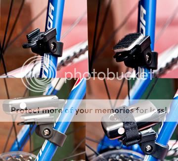

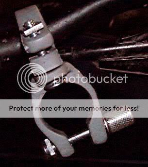

Rear Seat Stay Mount
Credit: Graeme

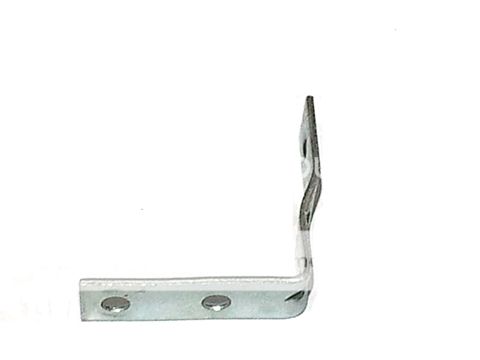

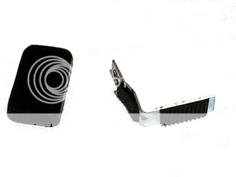

1 x Rear light bracket
1 x Flat piece of plastic (I used the base of the magnetic stand from the MD80) or an old light mount to use as a base to fit snugly into the light bracket
1 x Small piece of thin rigid flat metal, cut to fit the plastic base above, this is used to lay the camera on.
2 x Tiny bolts and nuts to hold the metal and plastic base together. You could glue them if needed
1 x Small piece of Velcro, stick one side to the metal base and the other to the underside and to the rear of the camera
1 x Small Velcro strap, the ones that have a small buckle and attaches to itself
1x small piece of ribbon or fishing line as a lanyard.
Once you have everything done, attach the camera to the Velcro on the plate making sure it is firmly in place. Then wrap the strap around the camera and bracket base, so it's nice and tight. Don't forget to tie the lanyard to the bike.
UPDATE: if you use 3M Dual Lock you won’t need the Velcro strap.
Parts Used
This is what it looks like attached to the bike

Mount 8
Quick Release Mount
Credit: Graeme
This mount was designed for those that don’t have room on the handlebars or don’t like having the camera mounted on the handlebars.
This mount attaches to the quick release, either the front or rear. Having the mount on the quick release means the camera is down low, it is in a prime position to capture plates as well as having part of the front or rear wheels in the footage. It also has the advantage of being a little more discrete and the camera can be easily removed or attached to the bike.
This can also be used for any camera that has a tripod mount, just leave off the wood and place a standard ¼ inch bolt into the L bracket. I used it to mount my GoPro and it works like a charm. You may want to brace the L bracket to give it a little more stability.
Things you will need
1 x 50mm L Bracket, it comes with holes pre drilled, but you will need to drill it out a little larger so the quick release spring fits through.
1 x Piece of wood approx 40mm wide x 65mm long x 15mm thick
2 x Small pieces of thin rubber
2 x Small screws
1 x Small piece of Dual Lock Velcro
Some black paint and some glue
1. Start by bending the L bracket slightly, this will allow it to clear the bottom of the fork properly.
2. Paint the wood black and glue the rubber to the L bracket, but leave enough room for the quick release.
3. Attach the wood to the L bracket using the two small screws.
4. Stick the Dual Lock onto the wood.
5. Attach it to the quick release on either the front or rear wheel.
Heres how
Bend the L bracket.
Paint the wood black and glue the rubber to the L bracket.
Attach the L bracket to the wood using the two screws.
Now it’s time to attach it to the bike, this is what it looks like.
The rear has the GoPro attached using a standard 1/4 inch bolt instead of the wood.

RigidMount MD80 seat post mount
Footage:

Finally had a chance to give the Contour strap mount a run on the way home today. In short - it's brilliant, very light yet strong. It comes with two different length straps that allow you to attach it to any tube, although I think it would struggle with small diameter tubes like rear stays. The mount is very solid Contour have re-designed their rotating mount, it doesn't wobble now.
I tried the camera mounted on the down tube and quite happy with the results.
Footage:

Available from: Point of View Cameras http://pointofviewcameras.com/ram-mount ... t-kit.html
This shows my Contour HD mounted on the rear using a Ram Mount. Because the RAM mount is a tripod mount system I have had to use my waterproof case, however you can buy an adaptor from Contour to adapt the camera mount to a tripod mount.
The Mount
Side View
Rear View
Footage:
[youtube]http://www.youtube.com/watch?v=tYfOUtAxIDY&feature=player_embedded[/youtube]

Credit: Aushiker
Available from: RigidMount http://www.rigidmount.com/
Jumbo HD808 720 camera mounted to Nate's generic handlebar mount, the RigidMount Generic Handlebar Mount. I added the lanyard to the mount as I had one spare.
The camera is actually well mounted to the mount. I have had no issues with it bouncing off or anything like that. My riding with this bike, my commuter, is on roads and some rough path riding.

I am using RigidMount Torch Mounts they are very simple to use. Everything I needed was included. I have only made one change, I had some knurled round nuts which I used so I can easily remove and replace the Cameras from the mounts. I also used one of my Basta stay mounts to mount a clamp on the Repco seat stays, much neater and cleaner.
The RigidMount clamps tuck the camera in and close, it is set back so it does not interfere with my legs. It looks very schmick and neat.
I was getting some twist on the seat stay and seat post mounted cameras, so made a rubber washer from a tube to reduce friction between the two pieces.
Front Bar mount.
With Camera.
Seatpost mounted.
With Camera.
Seatstay mounted using an old Basta Superflash leftover base mount.

Handlebar Mount
Credit: Graeme
Well I have been testing one of Nate's camera mounts from and I have to say, they are GREAT!
I used my GoPro Camera with its tripod mount and the RigidMount is very easy to attach to your Handle Bars.
The wife and I went for a 45k ride today along a cycle paths, I wanted to ride on the paths because I find them a lot bumpier than the road and it is a good test for the camera mounts.
I have always wanted to have a camera facing forward and one facing the rear, but at the time I could not afford another camera.
So I attached the handlebar mount to the bottom of the drops. This way I could have the GoPro facing forward or if needed, I could quickly turn it to the rear.
This is what I mean...
