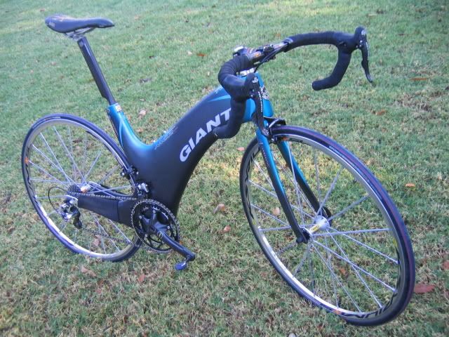

I've just bought a Giant once frameset with a group included, so I would rather ride that cause it's lighter and stiffer. BUT... I bought a MCR frameset, and it's sort of rare (as well as chipped) so I was thinking of converting it to a fixed, or single speed.
Anyone had any experience with the groupsets that go every now and then on the net including crank, seat, handlebars, rear cog, chain and two hubs?
I've seen them selling for around 150 to 200 bucks and wonder if they're any good.
I have a spare Sh-r500 rear wheel, so wondering if this will work ok with a single cog, is this the difference between single speed and fixed (the freewheel).
Or any other recommendations available?
Not sure if I can post a photo yet but i'll try.

Davey wrote:I've just bought a Giant once frameset with a group included, so I would rather ride that cause it's lighter and stiffer. BUT... I bought a MCR frameset, and it's sort of rare (as well as chipped) so I was thinking of converting it to a fixed, or single speed.
Few questions here, and not entirely sure what you're asking, but I would avoid cheap as !! BAN ME NOW FOR SWEARING !! packages from the net because they're , well, !! BAN ME NOW FOR SWEARING !!. You also have to know in advance whether everything is going to fit, correct threads, diameter etc
Yes. That's the difference. That wheel is unsuitable for a fixed gear bike (without significant bodging). Do a search for Giant on the fixedgeargallery for some ideas
Do some research, learn a lot, that looks like a nice frame to make a quite unique bike. What are the rear dropouts, do they give you some adjustment for chain tension. If not, you're opening up another fair can of worms.

I had a bit of a look around and because I dont have horizontal dropouts I'd have to get a chain conversion kit, or replace the dropouts (they screw in). Theres a couple of the groupsets on ebay, but they aren't well known brands, (supreme or something).
http://cgi.ebay.com.au/ws/eBayISAPI.dll ... 0333306248
http://cgi.ebay.com.au/ws/eBayISAPI.dll ... 0333306773
Not sure if I will go that way. I think I can live with a freewheel until a flip flop comes around and I'd have to get rims and spokes if I got the hub kit as well as build a rim.
I saw those dmc things for conversion but if you're going for a fixie I'd think that people making fixies are trying to be purists, so i'd rather get the dropouts changed than use a kit.

2 possibilities
1) I assume they're rear facing dropouts... get a machine shop to make up a pair with about 20mm adjustment. That'd do it.
2) White Industries ENO hub. Eccentric cam, self tensioning. Costly.
okay, 3 possibilities
3) Magic gear. Selected ratio to give right length chain for chainstay measurement. Usually involves compromise.

Yeah the dropouts are rear facing so I might get my grandpa to help make some. Wondering what steel to make them out of, but he was a tool maker so should probably know.
