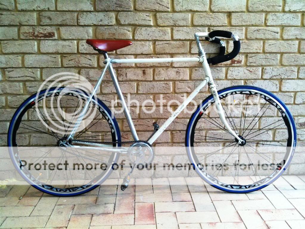

Ok it's all done and here's my write up. Keep in mind I've never worked on a pushbike before and the intention of this build was to keep it simple and cheap. I will eventually build myself a decent quality fixie when I get bored of this one.
Total cost - $364:
$40 - frame… including forks, seatpost, crankset, handlebar etc (Gumtree)
$100 - wheels (Catch of the Day)
$102 - tubes and tyres (eBay)
$29 - paint (Bunnings)
$1 – rear axle spacers (Cycle Centre)
$21 - new bearings and 15T rear sprocket (eBay)
$10 - brake lever (eBay)
$18 - pedals (eBay)
$9 - bar tape (Torpedo7)
$9 - brake pads (Torpedo7)
$25 - saddle (CoTD)

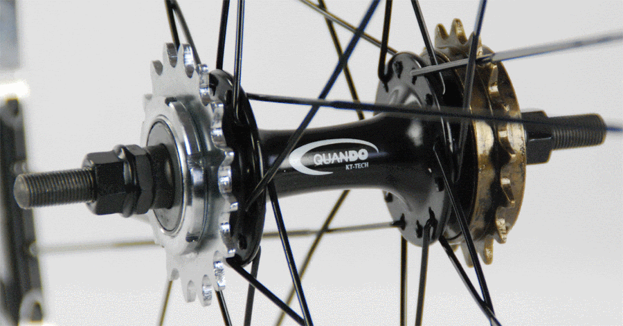

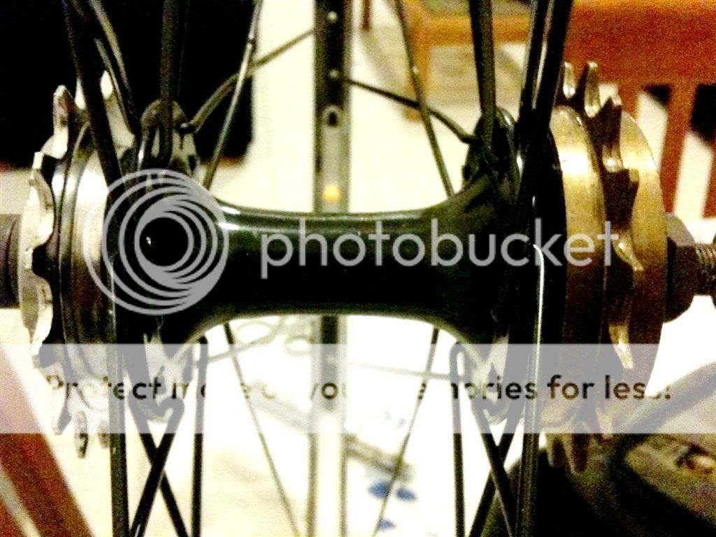

The old-school 80s forks ends were just a couple mm too narrow to house the new axle. A bit of rubbing inside and it opened up quicker than a Catholic school girl.
With a single sprocket now substituting a cassette of gears, the rear fixie hub was 20mm too narrow for the frame. I popped into Cycle Centre in town, had a rummage through their spare parts bin and $1 later had a couple of spacers. One spacer added on the right.
I later discovered the flip-flop sprockets were different sizes. The freewheel sprocket was designed for a 3/32” chain (same size as the original chain on the bike) whilst the fixed sprocket was designed for a 1/8” chain (typically used on single speed bikes). No idea why they were mismatched but it kind of defeats the purpose having a flip-flop setup, possibly why it was going dirt cheap on CoTD in the first place...
So I turned to eBay and discovered most of the fixed sprockets were in fact designed for a 1/8” chain, but eventually stumbled across 3/32” size fixed sprockets.
$11 delivered.

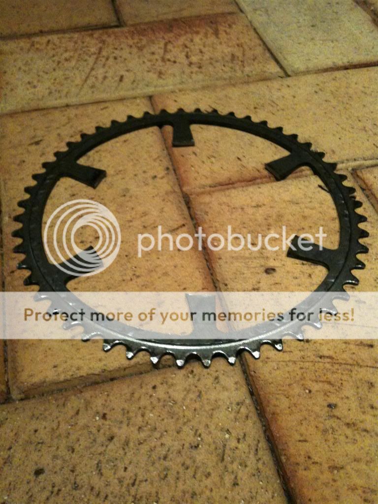

I opted for a 15 tooth sprocket (right) over the original 16T, to keep in line with the advice of Sheldon Brown:
http://sheldonbrown.com/fixed-conversion.html#flip-flop
15T fixed / 16T freewheel
Both now 3/32" ^_^

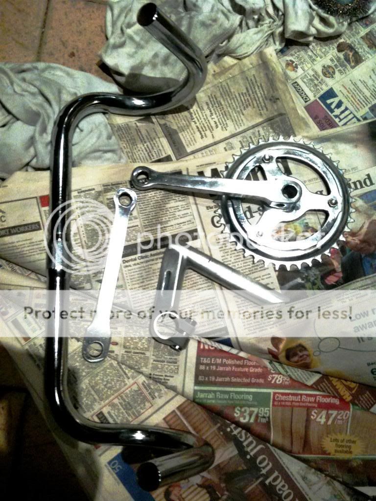

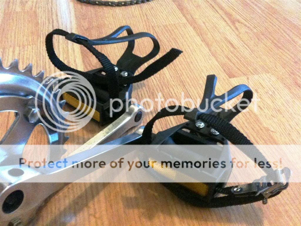

Being a budget fixie build, I opted to use the existing cottered crankset instead of buying a new crankset. This also meant not having to replace the bottom bracket. Since the inner chainring provided a straight enough chainline, I removed the outer chainring.

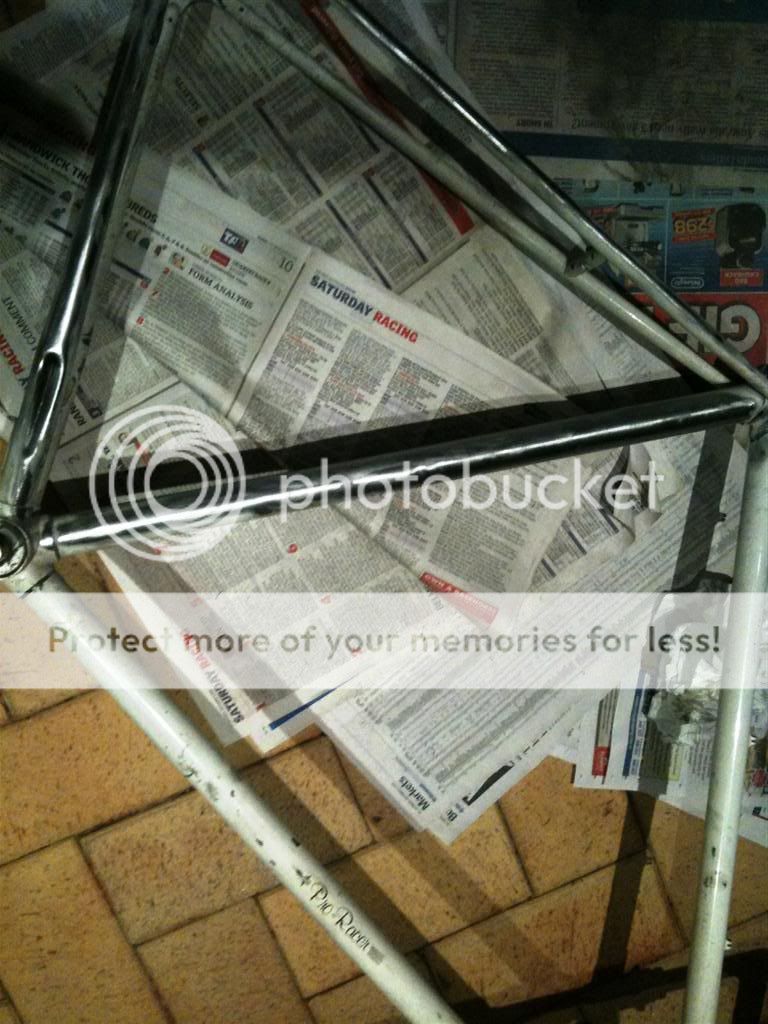

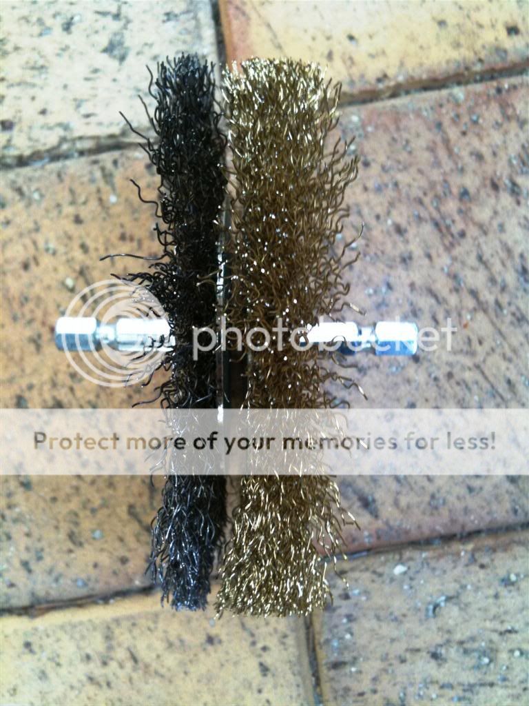

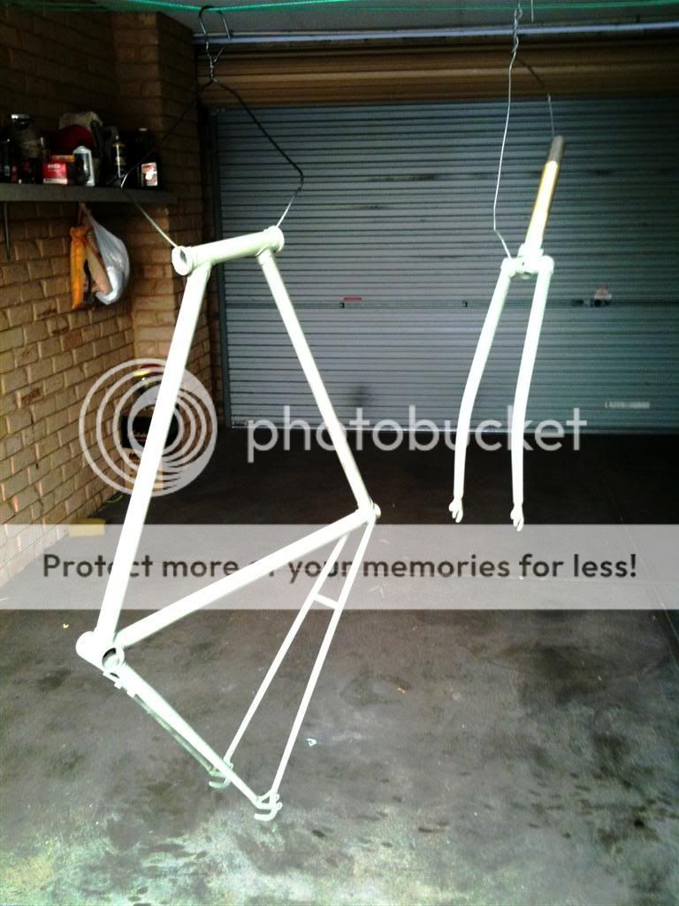

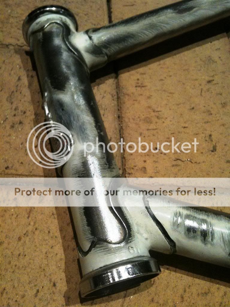

Sanding back the frame and forks proved a tedious process. I used a circular wire brush drill attachment for the job, well, 3 in total. Managed to get it to a bare metal state, apart from the underside near the bottom bracket, not that it matters as the sun never shines there anyway.
Sanding the lugs and inbetween >.<
Sanding disc a bit worn v_v
Temporarily pieced together

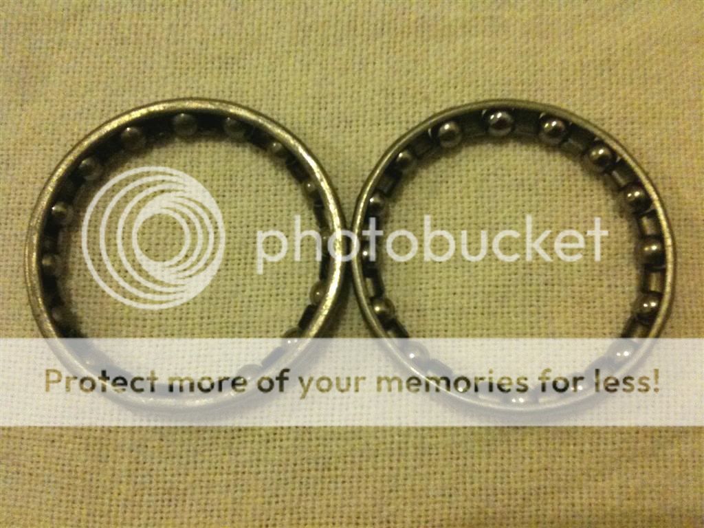

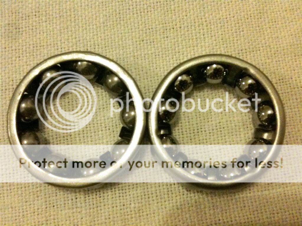

Thought it would be worth inspecting the bearings on a racer that had stood the time of roughly 3 decades. Pulled apart the bottom bracket and steering brackets and cleaned up what I could. Replaced the bottom bracket and steering bearings for $10
Bottom Bracket bearings: old vs new
Steering bearings : old vs new

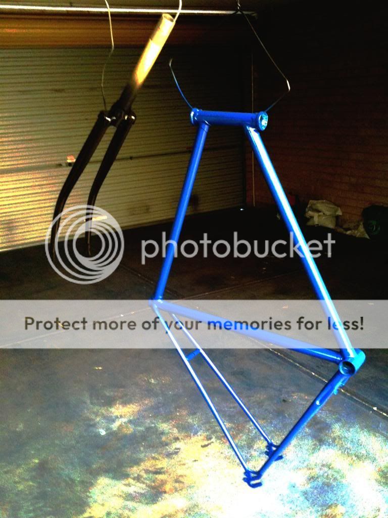

One coat of primer
Finally matt black forks and a blue frame emerge

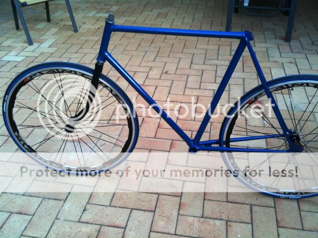

Wheels on
New pedals $18 landed from eBay, 150g lighter than original

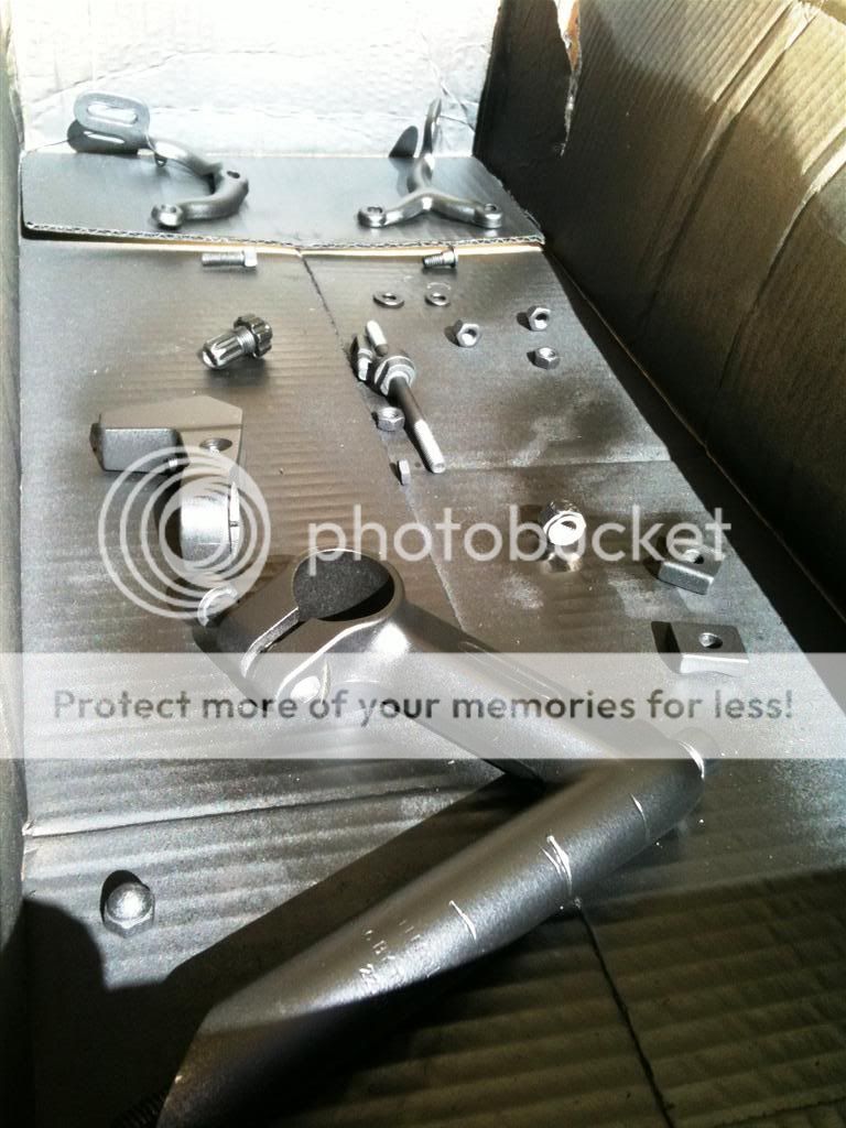

Bit of matt black love

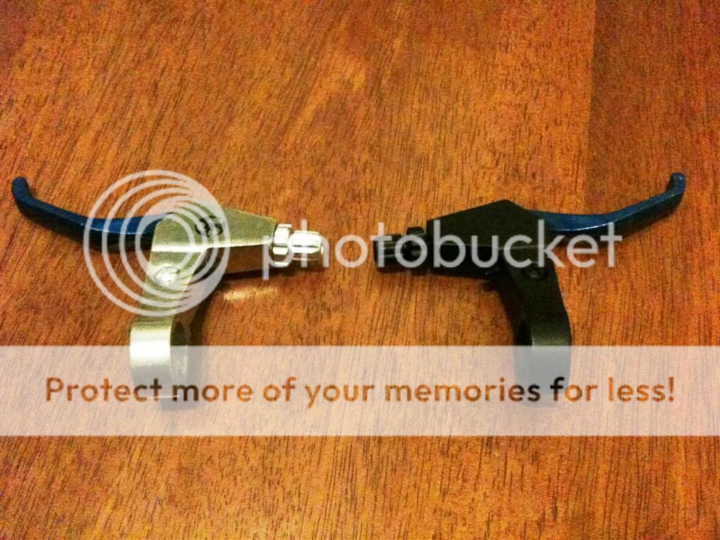

New levers, I sprayed then front one matt black.
These were $10 delivered from eBay
Matt black front brake with new pads

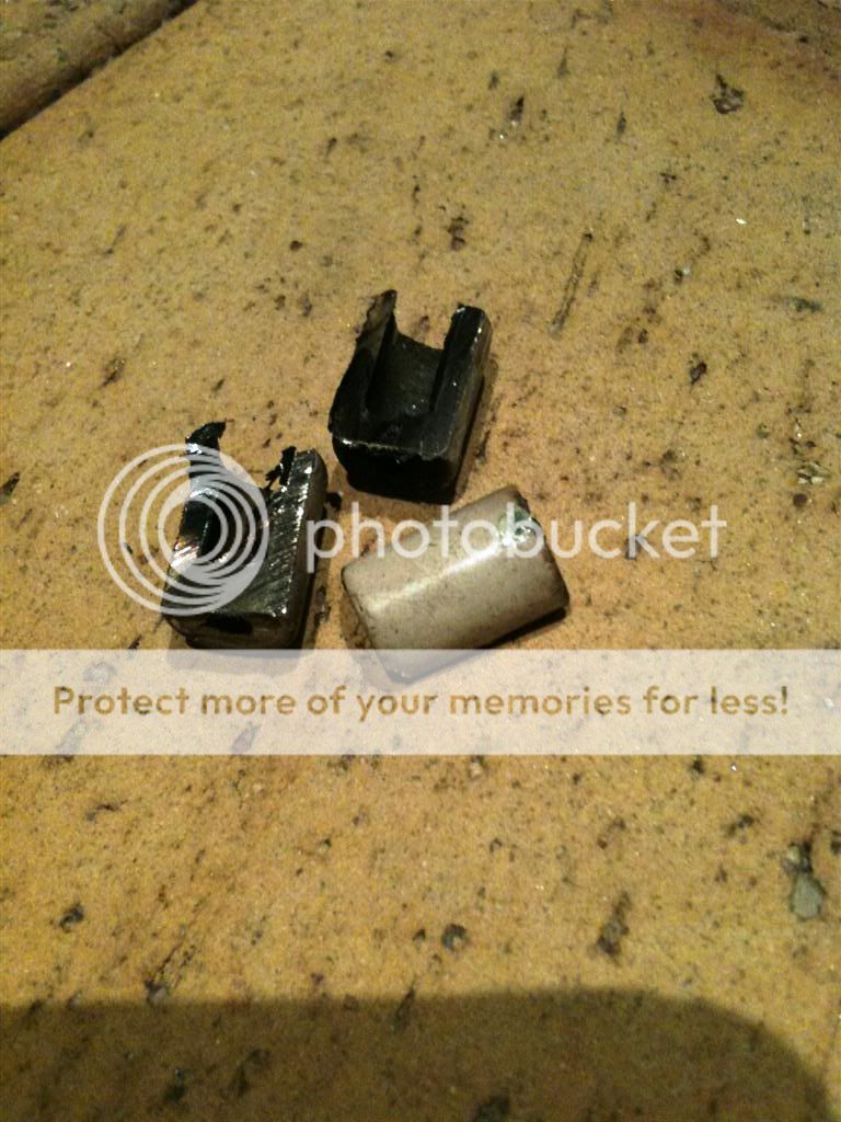

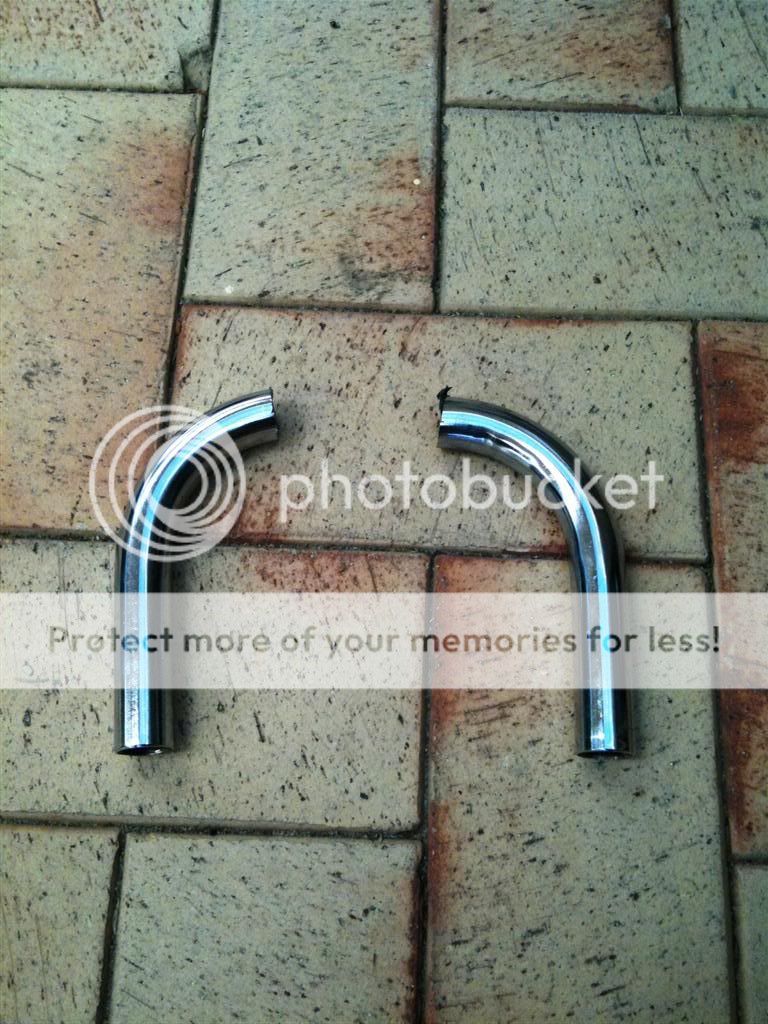

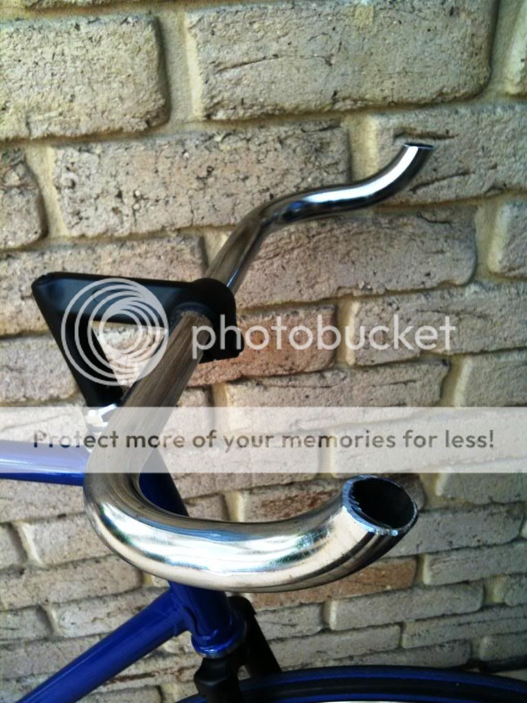

Goodbye handlebar ends
Hello new flipped over handlebars
Add 1 x front blue brake lever.

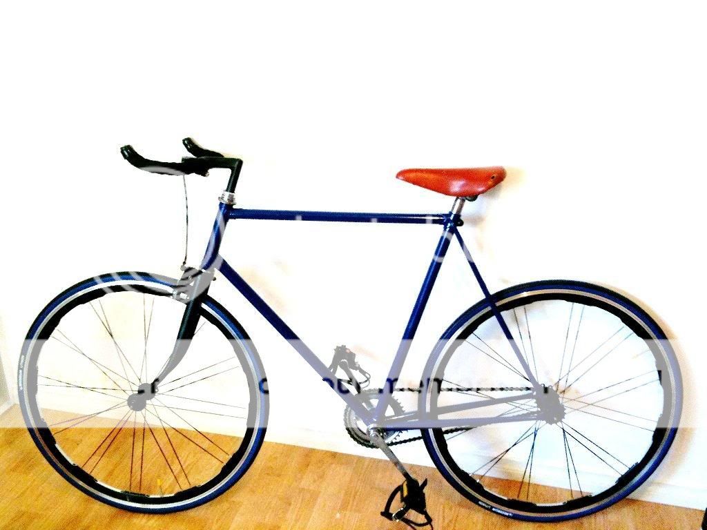

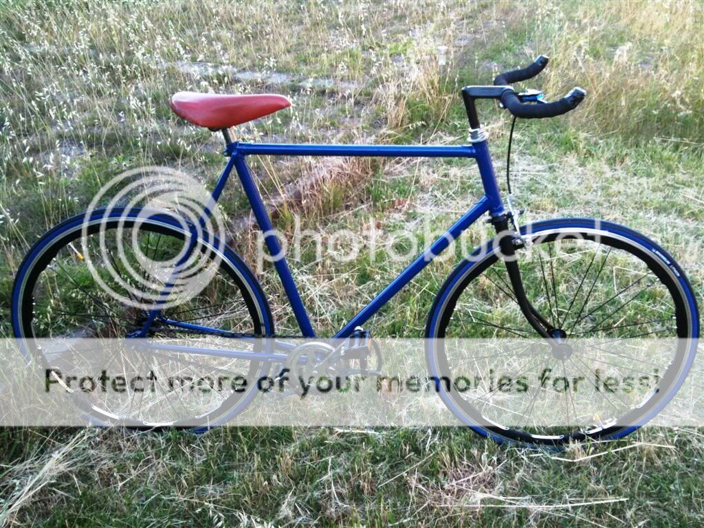

Finally pieced together (minus new saddle)
Back from first ride

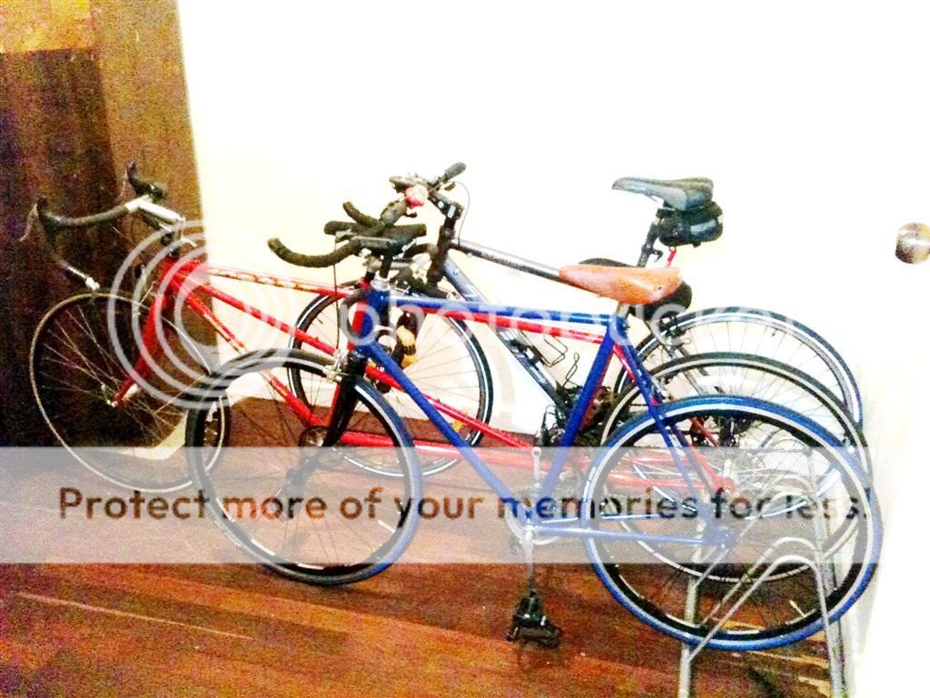

Back in the bike garage with the tandem and roadie

Anyway, looks pretty good, except that I dislike how high you put the stem (but that's probably cause you need it like that) and that's about it.
What happened to the Raleigh badge on the headtube?

Postby hondaboy » Thu Nov 11, 2010 12:37 pm
Hey guys, any other feedback (positive or negative) for my first budget build?
It rides really smooth btw, took it out for a 20km run and was a dream to ride (for me anyway, I have nothing else to compare it to)

I would recommend getting some new cranks. That chainring looks very small, you will probably find yourself spinning out down hills.
Otherwise, good job, looks great. I would have left the brakes, stem etc... nice and shiny though.

Oh, as Moe mentioned, how have you faired with those long cranks and smallish chainring? Looks like it would be pretty tricky to deal with down slopes.

Also, what did you use to clean up the components (crank, chainring, bars etc)? They look very shiny and clean.
hondaboy
Posts: 184
Joined: Tue Oct 19, 2010 3:10 pm
Location: Northside, Perth
Raleigh fixie build (image heavy)
Postby hondaboy » Tue Nov 16, 2010 8:28 pm
Moe wrote:I would recommend getting some new cranks. That chainring looks very small, you will probably find yourself spinning out down hills.
It is small but for the riding I do it's manageable. The intention of the build was to keep it cheap and simple, changing the crankset would also require a new bottom bracket.
I thought the matt stem/brakes would compliment the forks. It will eventually scrape off anyway I guess.

elStado wrote:What brand/type paint did you buy?
Also what seat did you get? I got some cheap $25 seat from CotD as well, last week when they had a bike sale. Seemed decent enough for a spare seat for the project bike.
A cheap brand from Bunnings, ~$3 a can. I'll definitely have my next frame blasted/coated the spraycan job doesn't cut it if you're doing a nice build.
Yeah would have been the same one, yet to have mine delivered. Time will tell how bad it is for a cheapie!

elStado wrote:Also, what did you use to clean up the components (crank, chainring, bars etc)? They look very shiny and clean.
Either turps or metho spirits, whatever I found in the shed I can't remember haha

hondaboy wrote:A cheap brand from Bunnings, ~$3 a can. I'll definitely have my next frame blasted/coated the spraycan job doesn't cut it if you're doing a nice build.
Cool, I'm not doing a super nice (expensive) build, but I figured that $70 to have the frame and forks sand blasted and powdercoated would be a good cost effective, easy and durable option. I have done some spray painting in my time and it is so annoying and time consuming, not to mention all the mess and fumes. Rather leave that business to the pros.
