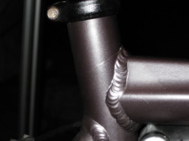

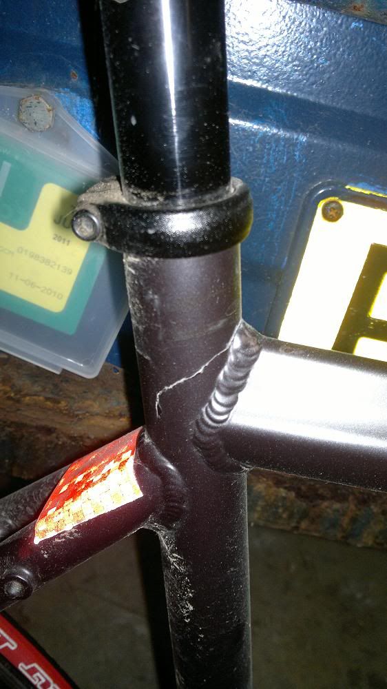

I cracked the frame at the seat tube. No injury.
Southcott were very good and sent out a new frame with forks in about 2 weeks from me contacting them.

Postby fenn_paddler » Fri Apr 01, 2011 8:53 am
Similar crack to my Felt Dispatch:
Southcott also replaced mine, though the replacement took a while
They did advise me to purchase a longer seatpost, which I did - the thomson elite on it now is 400mm. Bike has been going strong for over a year now so don't know if the new frames don't have that weak spot any longer or if the seatpost addressed the issue.

Postby Mulger bill » Fri Apr 01, 2011 8:10 pm
Sure looks like not enough seatpost insertion to me.
Rule of thumb I was told years back was to have the bottom of the seatpost at least 50mm below the lowest weld.
Posts: 22828
Re: Felt Dispatch
Postby Mugglechops » Fri Apr 01, 2011 8:49 pm
Mulger bill wrote:Sure looks like not enough seatpost insertion to me.
Was atleast that far in. Just checked it against the new frame and the bottom of the post was where the red line is.
