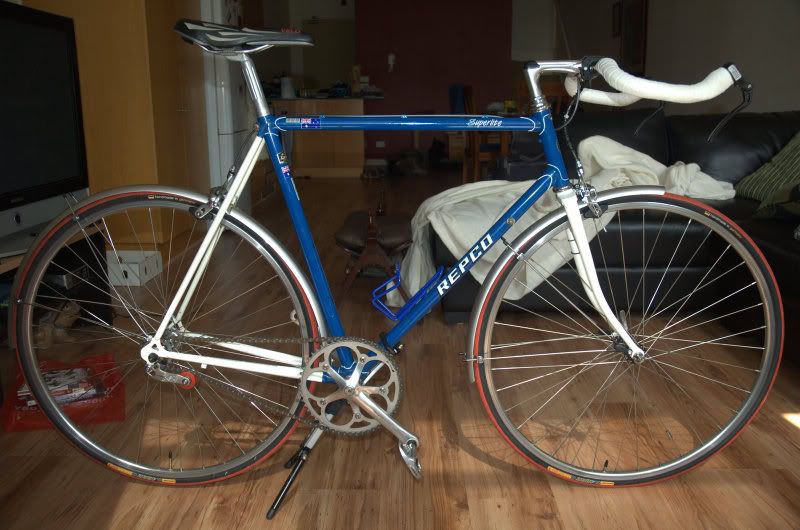

Postby vitualis » Mon Sep 08, 2008 12:05 pm
The project is complete!
The last thing I needed (the stem) arrived the day before I was going NZ for 2 weeks... Got back to Sydney yesterday and finally completed the build! Went for a test ride today and everything is working well!
With the single speed drive train and the 105 freehub, this bike is evilly silent... :twisted:
Annoyingly, I discovered that the seat post is 26.8 mm diameter (I think) and is on the short side. I've got it up as high as I dare... still fits okay.
Cheers!

Postby h3ndry » Mon Sep 08, 2008 12:59 pm
Looks awesome mate, especially nice work on the bars. What levers are they?
And did you have to redish the rear wheel after spacing?

Postby kukamunga » Mon Sep 08, 2008 4:09 pm
Nice. White lug highlights are the icing on the cake, IMHO! I've got a use now for all those dozens of Humbrol model paints I've got stored away somewhere.... :roll:

Postby vitualis » Mon Sep 08, 2008 4:15 pm
They are ITM Low Pro/TT brake levers: http://www.ribblecycles.co.uk/productde ... 0000000000
As for the rear wheel, it has a modern 10-speed 105 hub. It was the wheel originally from my Colnago (that I replaced recently with a TWE wheelset). I used spacers to "convert" it to a single speed wheel.

Postby vitualis » Sat Oct 25, 2008 11:03 am
Finally got a replacement 26.8 mm seatpost as the original was much too short. When putting the new one in I stripped the thread of the somewhat rusty seatpost binder bolt... :oops:
I've now got the seatpost in place with a bolt, nut and couple of washers. A bit inelegant but it works.

Postby familyguy » Thu Oct 30, 2008 12:28 pm
Binder bolts not that exxy, surely?
The bike looks nice. Does the single cog on the spaced cassette feel lopsided at all? Reason I ask is that I'm debating about getting a set of cheap road cassette wheels and doing the same thing (cheaper, faster, easier to change ratios).

Postby vitualis » Thu Oct 30, 2008 12:40 pm
familyguy wrote:Does the single cog on the spaced cassette feel lopsided at all? Reason I ask is that I'm debating about getting a set of cheap road cassette wheels and doing the same thing (cheaper, faster, easier to change ratios).
No, it feels and rides fine.

Postby Endo » Thu Oct 30, 2008 3:00 pm
Jr Dacks wrote:53/18 is a big gear for a single speed, im running 50/18 on mine and thinking about dropping it down a touch but see how you go with it anyway.
I love the fenders 8)
I'm ran 51/18 for 100kms in the Around the Bay ride in Melb and I found it fine. Sure, on one of the hills I was out of the saddle for about 1km -- honking the hell out of it, but the rest of the ride was fine on that ratio!
PS: The bike's look great! Love the fluted seatpost too! Is there anyway you can ditch the DMR tensioner?

Postby vitualis » Thu Oct 30, 2008 7:26 pm
Unfortunately, had to give the seatpost away... it was just too darn short. As for the chain tensioner, it's a must. This model Repco Superlight doesn't have any fore-aft adjustability with regards to the rear axle.

Postby Endo » Fri Oct 31, 2008 10:00 am
vitualis wrote:Unfortunately, had to give the seatpost away... it was just too darn short. As for the chain tensioner, it's a must. This model Repco Superlight doesn't have any fore-aft adjustability with regards to the rear axle.
Cheers.
'magic ratio' ;)
You can make minor adjustments by changing the front chainring tooth-count to take up the slack without affecting your gear-inches dramatically...

Postby kukamunga » Fri Oct 31, 2008 11:09 am
vitualis wrote:This model Repco Superlight doesn't have any fore-aft adjustability with regards to the rear axle
Do your dropouts look like the drive-side one on this frame?
You could file or get them machined out longer.....

vitualis wrote:The project is complete!
2years too late but I think you put the chain on the wrong side of the tensioner..?
all the ones ive seen have it like this
oh well doesnt matter now :? ha

Postby vitualis » Wed Sep 08, 2010 5:49 am
Actually, the chain tensioner didn't fit the frame properly so I had to jury rig just a part of it onto the frame. In any case, with testing the way I eventually put it on (in the photo) worked better insofar it provided more even tension with bumps (i.e., with the chain bouncing).
