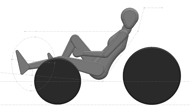

Postby AndrewBurns » Fri Jul 27, 2012 6:11 am
Hey all, I'm totally new to the whole bent thing (never owned or ridden one) but I think the idea is kinda cool and would love to give a velomobile a go, I just don't think they're practical enough to warrant buying one.
That doesn't mean I can't have a look at designing and building one though...
I've never built a bike frame either but I've got some composites experience and I'm keen to give it a shot. I started last night by measuring myself up and reading a bit about rider location, crank location etc. I've had an attempt at placing my dummy rider in a position I think might work however I don't have any experience actually riding a recumbent so if you could critique the position in the picture that would be great. The oval represents the clearance needed around the cranks. I'm thinking the cranks might be a little too high as the clearance above the tip of the toe at the top of the stroke is pretty much level with the riders face so the fairing might restrict visibility.

Nice one.
The cranks do look a little high in that the fairing will need to curve over that high pont and then start dropping to the nose.
You could use that position on an open recumbent and it would be pretty aero.
Laid back seat doesn't always turn out best in a faired vehicle
That position looks similar to my Roto Velo layout although the BB is lower.

Postby AndrewBurns » Fri Jul 27, 2012 8:35 pm
Thanks for the link, very interesting. I've updated the design with a lower angle to the BB (from 10 degrees to 5 degrees) and a more upright seat position (from 50 degrees to 55 degrees). I also added approximate wheel locations, a 26" wheel at the rear and two 20" wheels at the front (all with 1.1" tyres), wheelbase is approximately 1m at this point and distance between the front wheels is 680mm.
Side view
Front view
Perspective view
I was planning on double wishbone front suspension but I don't think that I can without making the front track a lot larger, there's really not much room between the wheels and my legs to fit it in! How important is suspension in these things? I might be able to fit some very limited suspension in depending on the arrangement of the hubs, brakes and steering assemblies.
In terms of steering I was considering using standard head tubes, headsets and steerer tubes as kingpin assemblies, I'm sure I've seen this done before, any comments about this? I'm also looking for sources of things like hubs capable of running with stub axles and other recumbent specific things so if people have suppliers I'd love to hear about them. I'm looking around for dimensions for various parts to include in my model but unfortunately not many bicycle manufacturers supply dimensioned drawings or 3D models compared to industrial equipment suppliers...

AndrewBurns G,day. About your steering, read up about Ackerman Steering Geometry. Yes you can parts of old frames. Good Luck ! Bob.

Ok so I'm trying to design in double wishbone suspension (I've seen a few designs that use wishbone and a few that use sliding kingpins, the wishbone designs seem more mechanically sound to me). It is very difficult however to avoid the rider's legs. The designs that I've found do two things:
- Lay the rider back a bit more, allowing the rider to move forward relative to the wheels but keeping the CG around the middle, this places the suspension arms in the pocket under the knees.
- Sweep the suspension arms forward, allowing the pivots and shocks (bulky things) to be in the pocket under the knees/thighs while the front wheels are further forward.
The problem with laying the rider back is reducing visibility and possibly putting the legs at a less efficient angle (unless the BB is raised) and the problem with sweeping the suspension arms forward is that vertical loadings on the wheels will induce a strong twisting moment in the suspension arms. I think that both of these problems can be overcome but require some careful design work.

Postby Poiter » Mon Jul 30, 2012 8:31 am
Can you rotate the cranks and leg in the drawing?
Be interesting to see where the knee comes up to at full height.
Was messing around with this on a bike I want to fully fair and even with a low BB the knee rotates up quite high approaching my sight line.

Postby AndrewBurns » Mon Jul 30, 2012 1:49 pm
Thanks for all the links and advice. I'll have a go at rotating the legs in the drawing to get the maximum knee height tonight, keep in mind though that the dummy is dimensioned on my measurements and I have relatively short legs compared to my torso.
Considering using some "Burner RCP" oil damped spring shocks on the front wheels, I got a quote from the manufacturer in Asia of $170 USD each. 48mm stroke, think the stock spring rate is 750 pounds/inch, I'll have to see if I can arrange the front-end geometry to work with these numbers. I'm also considering building the frame from pre-made carbon tubes direct from China, once I have the frame design more dialed in I'll put out some RFQ's to see if I can get a price worth going for. Assuming I can get tubes of the right dimensions at the right price it would be a lot faster and easier than me making them, I just have to finish and join them.

Ian, Is there any rule of thumb for the amount of camber to add to the front wheels? I'm just designing this for fun right now but if I did get to actually building it I would primarily use it for recreational rides and possibly the occasional commute or longer ride. In terms of luggage I'd be happy to be able to fit a rack and panniers over the rear wheel or maybe I could add in a compartment but I don't need all that much. I'd be aiming for minimum weight for better up-hill performance (lots of hills around Sydney).
I've attached some more pics of the changes I've made to the design. Reclined the rider slightly and shifted forward over the front wheels a bit to give more clearance under the legs for suspension and steering components. Added in bicycle head tubes for kingpins and MTB rear shocks in approximately the correct location. Current suspension layout would give a maximum vertical travel of about 60mm, spring rate at the wheels is about 10.7kg/mm, so full compression takes ~643kg. That's clearly a lot but I'm not sure I can get the shocks with weaker springs, I'll have to look into it.
Oh and I played with rotating the legs, no pics but at maximum height the knees come up to about the dashed line running from around neck high, remember that I have short legs compared to my torso.

Postby Poiter » Fri Aug 03, 2012 11:09 am
AndrewBurns wrote:Oh and the Trisled site linked to doesn't mention it but what are the details of those Rotovelo front wheels? Are they 16" or 20", axle diameter? Disk brakes?
RotoVelo has disk brake 406 wheels.
No rotors or calipers of course.
Axle is a 10mm tapered head bolt into a threaded mount on king pin.
In the Roto Velo with no suspension I have no problem with fast tight cornering.
The problem is keeping the tyres in contact with the ground on rough paths with tree routes on corners.
But being a tadpole it just slides and hops a bit.

Postby Poiter » Fri Aug 03, 2012 11:22 am
Andrew's new Drawing.
Now it looks too high off the ground (COG) and you will have problems with cornering and lifting wheels or toppling over.

Postby Baalzamon » Fri Aug 03, 2012 11:41 am
Poiter wrote:Andrew's new Drawing.
Pete
Yep I'd be dropping that too, just have a look at the Mango's and quest to see how low they are to the ground
