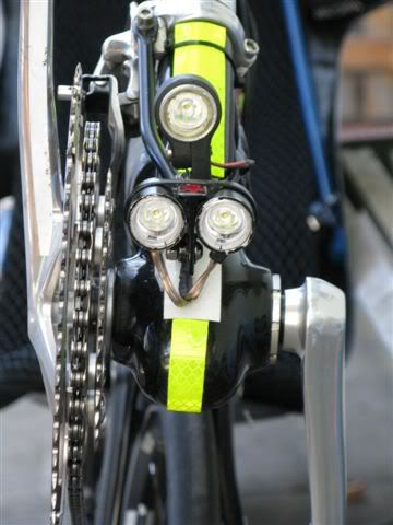

Postby skyblot » Mon Jul 22, 2013 8:10 pm
This probably doesn't really help, but I mounted my Ayups using the standard handle bar mount but strapped to the bottom bracket. Works just like it was designed for the spot.
I don't notice any real foot flash, whereas when I had a light on the top of the derailleur post it was quite bad.
