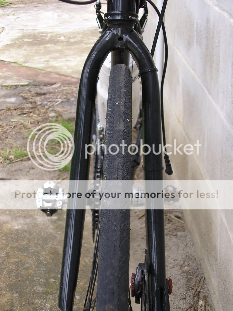

I hope no-one ever picks up a D shackle with those Enve forks. Instant superman impression while wondering what happened.
Safer to have a 'cross fork IMO. Tyre width in pic below measures 24.8mm and a D shackle will pass straight through as I've tried it.
Also Salsa might have trouble selling all-weather road bikes that can't easily fit mudguards. They obviously think they have some kind of niche market for them though.

Nobody wrote:I hope no-one ever picks up a D shackle with those Enve forks. Instant superman impression while wondering what happened.
Mind you, that goes for any fork on a road bike vs a D-shackle. I hope never to prove the theory.
The ENVE fork will obviously never fit a mudguard, as I understand that pic is with a 25C tyre.
Whilst my Kona fork doesn't have the same clearance as the CX versions (like Nobody's), there is still plenty of room even after a 28C tyre is fitted.
