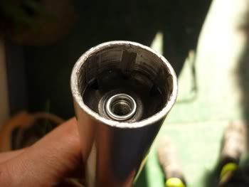

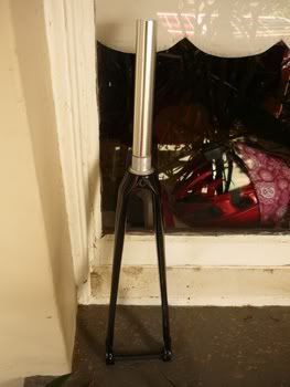

Postby jules21 » Sat Oct 08, 2011 5:45 pm
any tips on how to do this?
i tried wacking it, but it won't go in straight for some reason (possibly as i didn't cut the steerer perfectly flat).
youtube says to source a threaded rod and use that to pull the nut down, from underneath the steerer. that sounds good - any ideas where i would get a threaded rod? it would have to be really thin (can't engage the nut thread).

Postby jules21 » Sun Oct 09, 2011 10:38 am
can't make it work. tried the screwdriver thing, but no matter what i do, one side of the nut slips inside the steerer before the other and then wants to go in sideways.
i've tapped one in before with no dramas, but this one seems to be giving me more trouble. maybe as the steerer is soft aluminium?

Postby jules21 » Sun Oct 09, 2011 12:40 pm
it's definitely the right size - 25.4mm internal diameter steerer. the star nut is just bigger than it - it will go in, i just can't make it go in straight.
if i keep forcing it in, will it straighten up, or will it just go through sideways? i keep pulling it out before it gets too far in to remove.

Postby glennb » Sun Oct 09, 2011 12:53 pm
jules21 wrote:it's definitely the right size - 25.4mm internal diameter steerer. the star nut is just bigger than it - it will go in, i just can't make it go in straight.
Not necessarily, depends on your method.
I thread the star nut on to a 150mm bolt then hammer it in. The nut mostly self-aligns when the second star enters the steerer, but a few angled taps on the projecting bolt are usually required to get it prefect.

Postby drubie » Sun Oct 09, 2011 2:11 pm
It's gotta be straight-ish when you insert the first set of stars but as glennb said the second set should pull it straighter. I didn't find any difference between aluminium and steel steerers though. Maybe you're being a bit timid?
One thing to watch is if it's a suspension fork, you have to support it under the crown rather than boing it all over the floor trying to get it it.

Postby jules21 » Sun Oct 09, 2011 2:35 pm
drubie wrote:Maybe you're being a bit timid?
this turned out to be the problem! the first star went it at a wild angle, but the second star straightened it up when it contacted the top of the steer tube.

Obvious I know, but I guess it should be mentioned (for the inexperienced) that you should support the fork under the steerer in between the fork tubes using something protective (I use soft wood covered in a cloth), and not under the dropouts...

Postby jules21 » Sat Oct 22, 2011 12:35 pm
Stuey wrote:Obvious I know, but I guess it should be mentioned (for the inexperienced) that you should support the fork under the steerer in between the fork tubes using something protective (I use soft wood covered in a cloth), and not under the dropouts...
i just used the plastic dummy axle that the forks came with. while this puts a load through the forks, i don't reckon it's that high.
