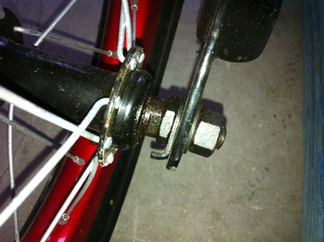

Quick bit of mechanics in the garage this morning. File out dropouts on some old forks to fit a modern wheel: check. Install tyres and inflate x2: check. Shorten brake cable, snip, darnit, snipped outer and inner in one hit. "Luckily" the outer was long enough to trim some more off to allow the inner to protrude far enough to reach the calliper. :oops:
Edit: also adjusted up a kerbside 12" for my littlest yesterday. Promptly fixed this on the Department store bike:
Who can see what is wrong?

No cards in the spokes?
Also, you may want to flip that lock washer around, maybe...

Wheel is built 2 cross rather than radially laced?

Could be :D , but my money is on the lawyer tag washers not being on the correct side of the fork.

Photobucket playing silly beggars:
