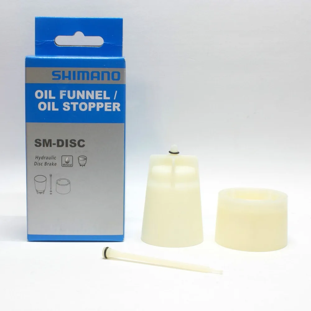

New pads for my Shimano hydraulic brake equipped Specialized Diverge, pistons in the caliper were easy to push out for the fatter (new) pads, & a quick spin/grab, tighten on the caliper bolts aligned the pads just nice.
I owe it all to this little thing I never thought I needed for a pad change:
