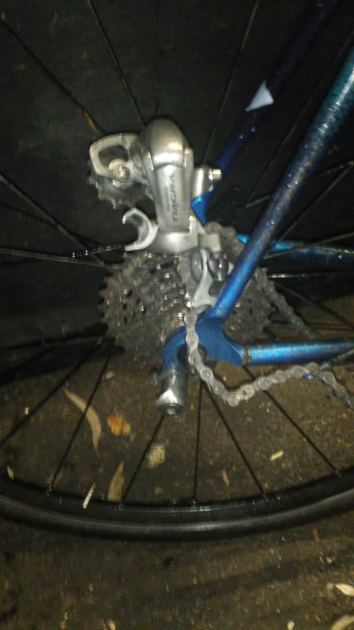

managed to straighten my (non-replaceable) aluminium-lugged carbon frame derailler hanger without it busting after a catastrophic stick incident last week.
Catastrophic in the sense that the derailler broke at the casting around the attachment bolt and flung itself into the rear wheel, chain and all, ending up somewhere down on the chainstay.
Not only was the derailler completely buggered (busted mount point, bent sprocket frames), but the chain even managed to get a couple of links bent into a permanent twist.
They don't make carbon bikes like that any more -- chainstay and seatstay both remained undamaged apart from some missing paint.

duncanm wrote:They don't make carbon bikes like that any more -- chainstay and seatstay both remained undamaged apart from some missing paint.
With non-replaceable hangers?
Nice work on the fix
yeh non-replacable.
I used a piece of pipe over the remains of the old dropout bolt and gently straightened. Much like a 'real' dropout tool.
It seems to be some sort of cast alloy - I was expecting it to break off, but it was surprisingly ductile and looks undamaged.
I'm sure its significantly weaker than it was originally.

Postby QuangVuong » Sat Jun 17, 2017 5:16 pm
Cadex's have stainless steel dropouts, not aluminium. This is why the RD blew up, and not the dropout.

duncanm wrote:
yeh non-replacable.
ouch...
better..
Can't imagine that new derailleur working too well if you've paired it to the old shifter....

Duck! wrote:Can't imagine that new derailleur working too well if you've paired it to the old shifter....
ya what?
I defer to your greater knowledge, but I understand shimanos are all 1.7 pull ratio
They both work fine(*) with my campy-10 ergo / shimano 9sp cassette hubbub cable clamp setup.
(*) - well, obviously the old one doesn't work any more.
EDIT - you might be thinking that tiagra derailler is a 10sp (4700) unit with a 1.4 ratio ? I think its an old 9sp mech.
