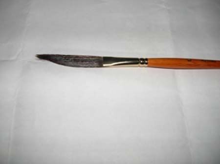

Postby GaryF » Fri Apr 04, 2008 4:29 pm
The late George Robinson showed me his pin striping brush about 10 years ago. It had a short handle with bristles reaching about 2 inches in length. The bristles were flat and tapered down like a dagger to be quite short near the handle. He had the brush stored in a tin and in a very light oil.

Postby oldtimer » Fri Apr 04, 2008 6:35 pm
GaryF wrote:The late George Robinson showed me his pin striping brush about 10 years ago. It had a short handle with bristles reaching about 2 inches in length. The bristles were flat and tapered down like a dagger to be quite short near the handle. He had the brush stored in a tin and in a very light oil.
This is a 'dagger brush' I bought recently.
The learning curve commences

Postby GaryF » Sat Apr 05, 2008 1:13 am
Hi Oldtimer.
That brush is quite similar to George's although his had even longer bristles and a wider brush width. He said it would hold more paint and allow for a one stroke to pinstripe for the length of a frame tube.
I have a similar brush to yours and have had a go at pinstriping - not very successful though. I think my hand was too unsteady. He showed me how to steady your hand with one finger on the tube you were painting also giving you a consistent distance from the tube.
I have been trying to remember the paint George suggested. I think it could have been coaching enamel - but i'm probably wrong. I do remember that the consistency had to be just right though to give an even line and consistent colour.

Postby oldtimer » Sun Apr 06, 2008 5:07 pm
silverlight wrote:hi, can these brushes be brought at any art supplies stockists??
silverlight,
It is a Roy_mac Dagger brush and I bought it from an air brush and sign shop. Art suppliers would probably have them as well.

Postby Kid_Carbine » Wed Apr 09, 2008 2:32 am
I was given one by an old supervisor at work back in the 80's He was a signwriter in a previous life & had gone blind in one eye.
Sadly, the cancer that took his eye eventually took his life.
He refered to the brush as a "Dagger Liner". The bristles are full of Vaselene [I think] & he told me that this was an old trick to preserve the brush between uses. Check with a signwriter before doing it to your brush though.
