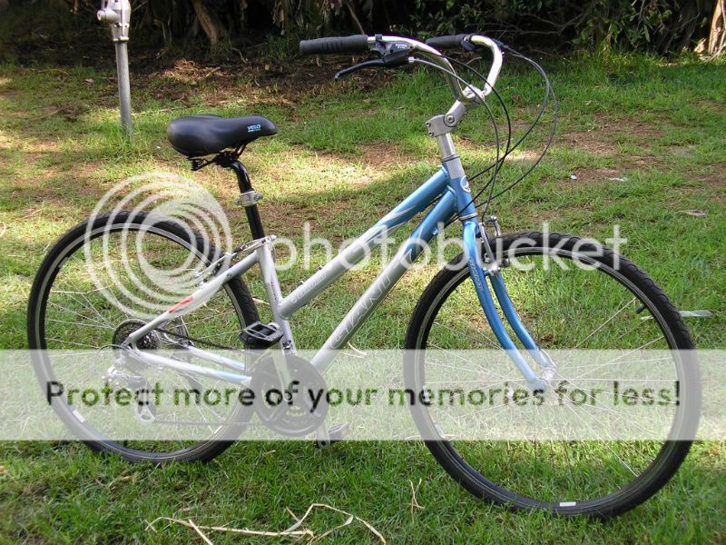

Nobody wrote:Image
Pic courtesy of the tumbleweed section. :lol:
Somehow I don't think you'll be the first person I approach for advice on saddles. Did a bike fitter inflict that saddle angle on you, or did you do it all by yourself? :shock: :P
All by myself :lol: It looks drastically nose down in that photo I agree but it's only a couple of mm at the nose. Whether its the sloping tt or the angle the bike is leaning against the wall I don't know, either way its comfortable for a couple of hrs at least. If I had a nose up brooks on it I don't think I'd be walking today, let alone riding
Nobody wrote:Here's how it's done if you have a Brooks.
Gee those bars are low, being steel you'll be able to weld some more pipe on the steerer and get a handful more spacers in there :?: :P
Failing that maybe these will help :twisted:

Postby Nobody » Sun Nov 04, 2012 4:28 pm
warthog1 wrote:Gee those bars are low, being steel you'll be able to weld some more pipe on the steerer and get a handful more spacers in there :?: :P
Um, yeah. Thanks for that "helpful" advice. :roll: :lol: Not everyone is trying the relive their youth.:P I believe pros have a 12cm drop and LA had 9 (but he obviously didn't need to be as aero.). I have 2cm. But I have a short reach for my height and so that setup still gives me a 45 degree body angle on the hoods. Fine for what I do. If I had a Madone with a H2 fit and a 14cm head tube for my size, then I think the spacers would be less noticeable.
warthog1 wrote:Failing that maybe these will help :twisted:
As for the ape hangers, I've got something similar on my wife's bike (cafe bars) and they make it very upright and comfortable. :mrgreen:

Postby warthog1 » Sun Nov 04, 2012 6:33 pm
My wife's bike is very upright and comfortable when I ride it too. You were correct, she has ridden it once thus far.
