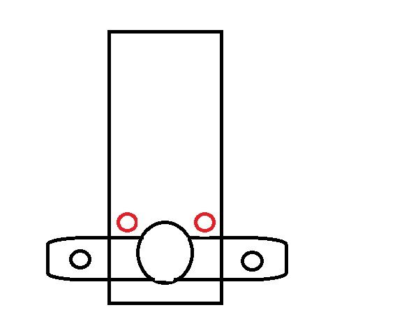

Surely you could simply weld two bits of metal on the tongue on either side so that when the rack mount tries to swivel it just hits the metal? you could even just weld on 2 nuts.
Please excuse my bad MS Paint skills.
the red circles represent welded on "nuts" or whatever type of obstruction you choose.

Or you could put them on the rack if you don't want to damage the integrity of the tow bar.
