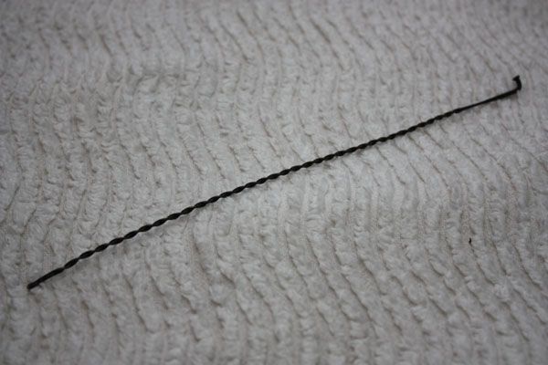

I personally prefer the DT Aerolite as you can do this:
The Dt Aerolite are much better finished and they have a smooth transition between round/bladed shape. I believe that they are a higher quality, but they do cost more again...

usernameforme wrote:I personally prefer the DT Aerolite as you can do this:
[img]idata.over-blog.com/0/02/72/10/randon-2008-news/aerolite.jpg[/img]
An interesting pass-time indeed but if they are dearer than CX-Rays its not a hobby I'm going to pick up :lol: :lol:
