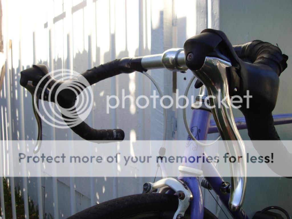

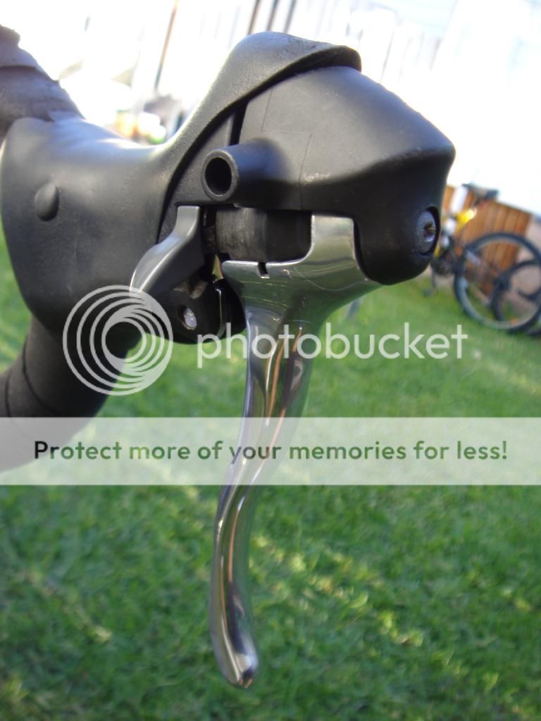

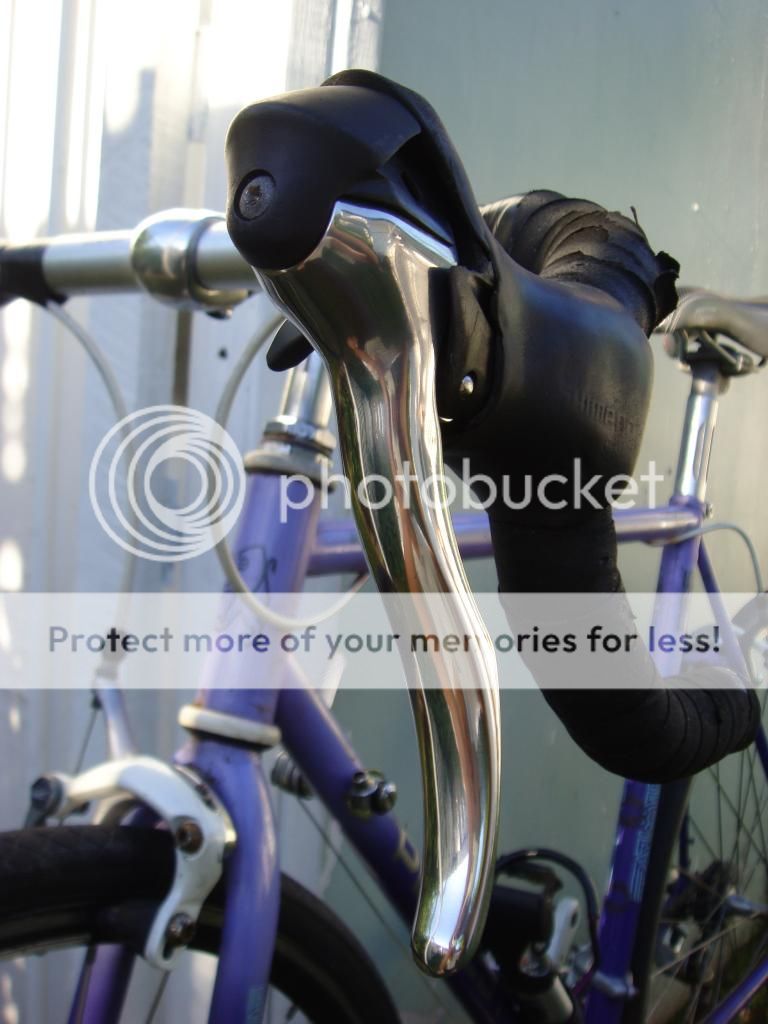

The end result after sanding and polishing.

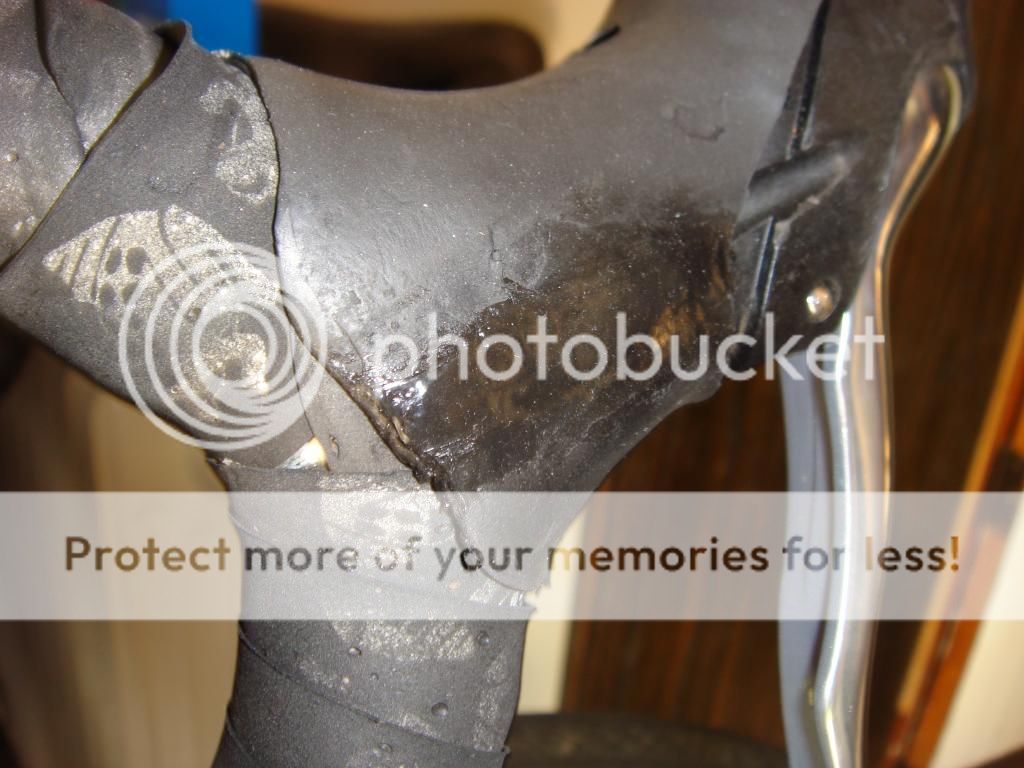

And as an aside, heres a couple finished products of the Soras(3300) which were rebuilt and polished. Hoods were repaired with silicone as well. I cut the right hood all the way down the outer side as it was already half ripped, then taped the innerside and silicone patched it up. Works well so far. Link below was what I read up on:
