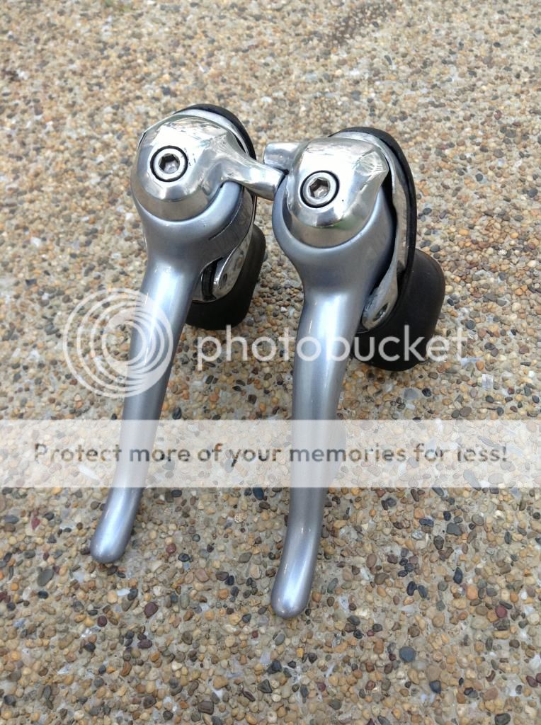

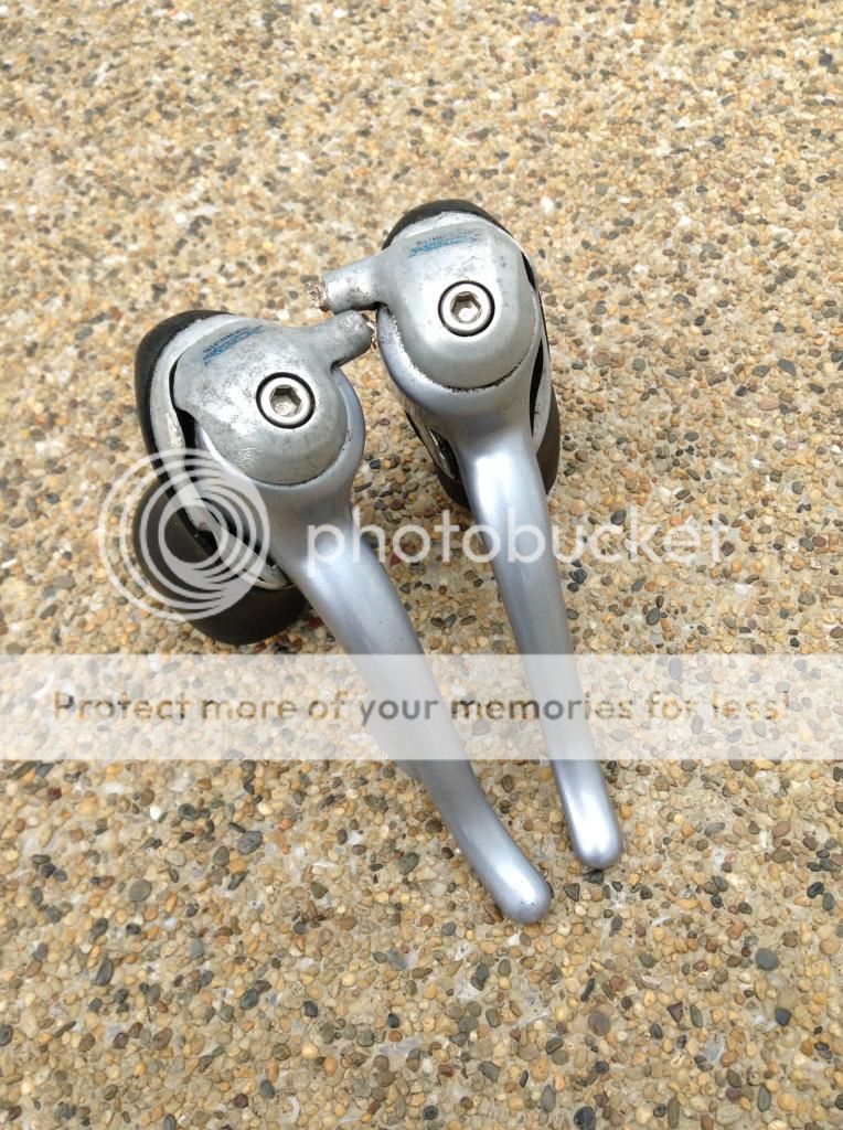

Another guide, now for the RSX STIs. These were in lovely cosmetic condition, and its obvious they did not get damaged over the years. However, the left hand shifter did not click at all. Right hand was very very stiff when clicking. Obvious signs of the gummed up grease.
RSX levers are not symmetrical. The right side lever is different to the left side lever. So I will be going through both left and right sides in this guide.

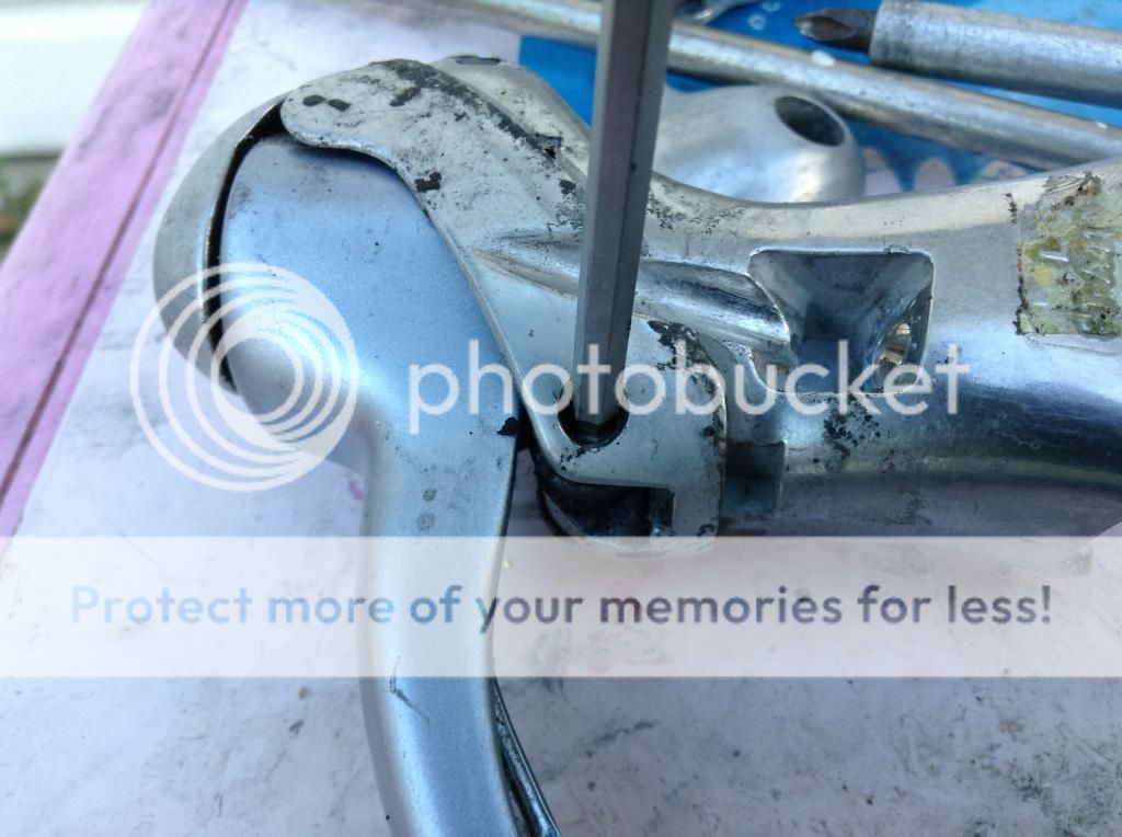

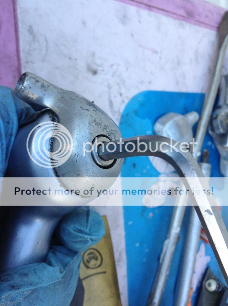

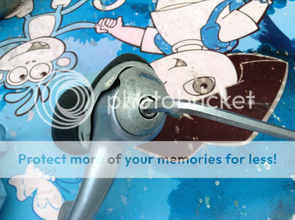

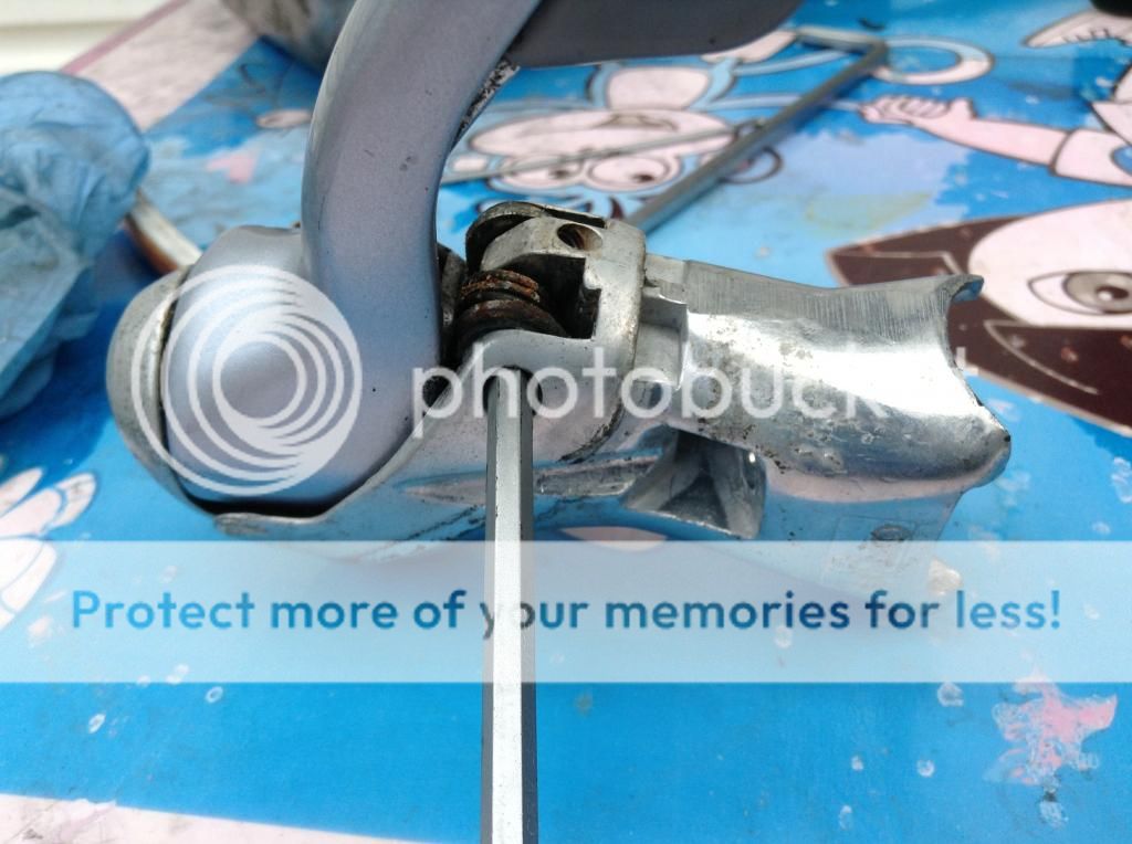

Use a 2mm allen key to remove this grub screw. THeres a little threadlock so it may be tight.
Get some sort of tool(4mm key in this case) to push out the pivot.

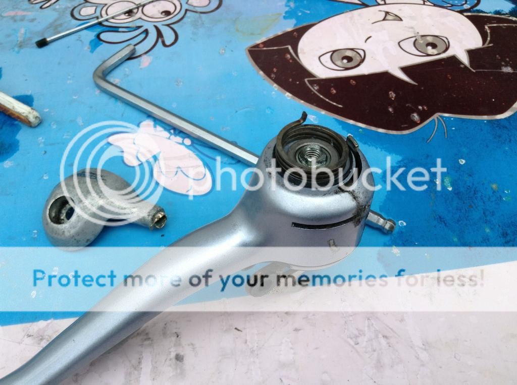

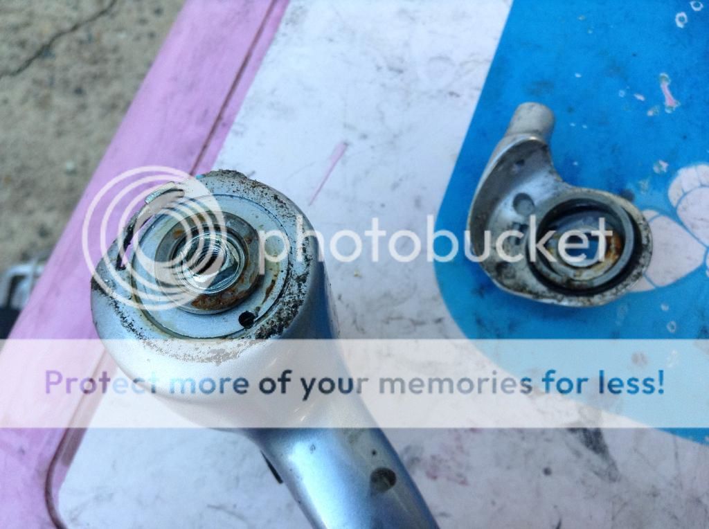

Now you can remove the lever from the body. Use a 5mm allen key to unscrew the nameplate screw. Make sure youre holding onto both the name plate and the lever when unscrewing, otherise there is a possibility that the name plate will go flying off as its connected to a loaded spring.
Carefully lift whilst twisting the name plate off. You will be greeted with this spring. This is different to the assembly of the new Sora(3300) and 105(5500) levers, but exactly the same as the RX100. Id say its much more easy to dismantle and rebuild because the spring is here.

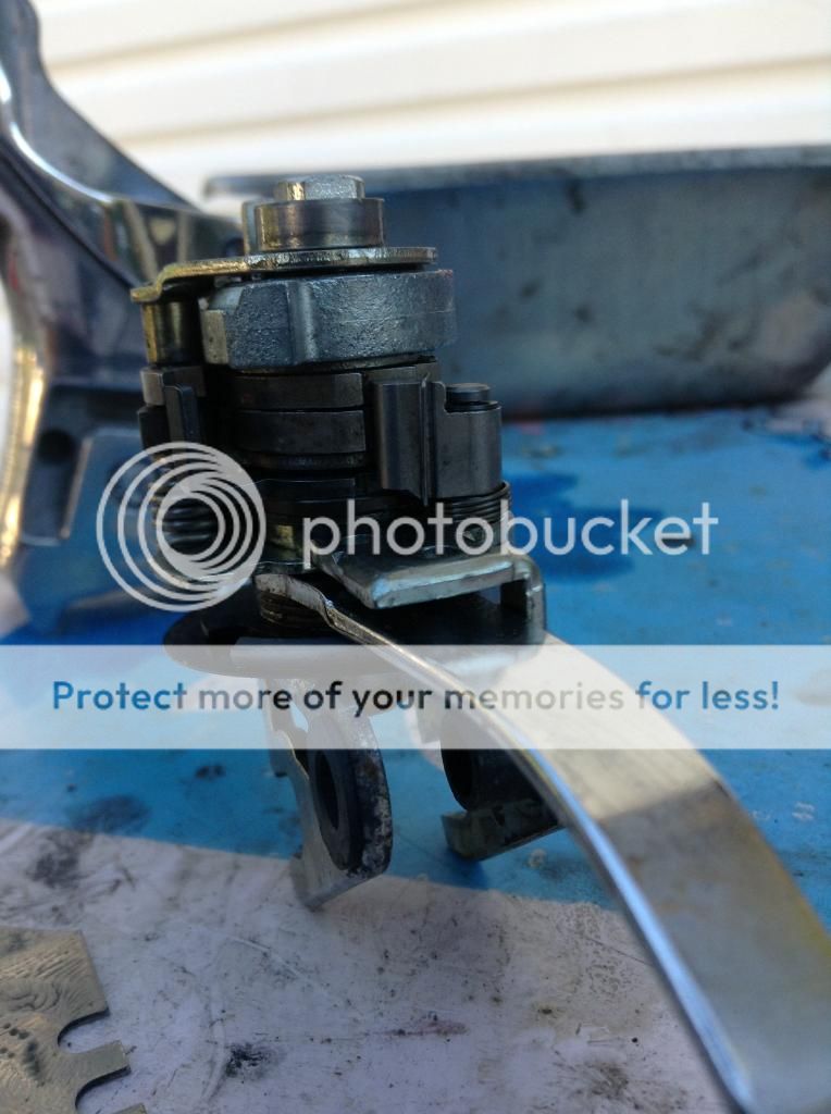

Flip to the backside of the lever, and push over the smaller lever to reveal a Phillips screw. Unscrew this, and be careful of a small screw washer behind.

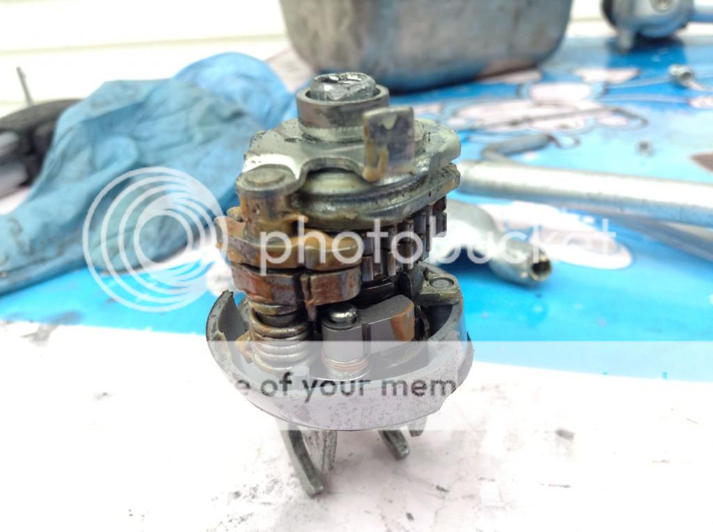

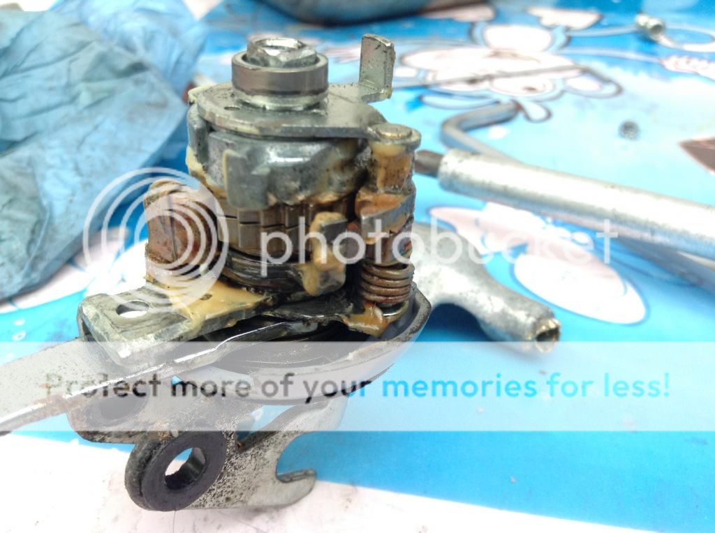

Now the large lever can be pulled off to reveal the innards. I believe this would be the levers that are the cleanest out of mine, but also the one which has dried up the most.
Proceed with cleaning up the old grease using whatever means you like(I like to use petrol). The dried up grease was some serious stuff. Though a quick soak would allow me to brush if off, but that was not the case. I had to soak it for a couple minutes together with a lot of brushing before it started to slowly clean up. Once cleaned up, apply grease to the pawls.

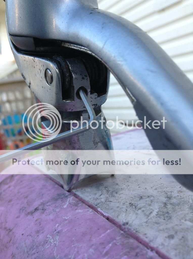

2mm allen key
Then use some sort of tool to push out the pivot.
Unscrew the nameplate screw with a 5mm allen key. Make sure youre holding onto both the name plate and the lever when unscrewing, otherise there is a possibility that the name plate will go flying off as its connected to a loaded spring.
Name plate can be lifted and turned slightly to remove
Flip to the other side of the lever, and push over the small lever to reveal a phillips screw

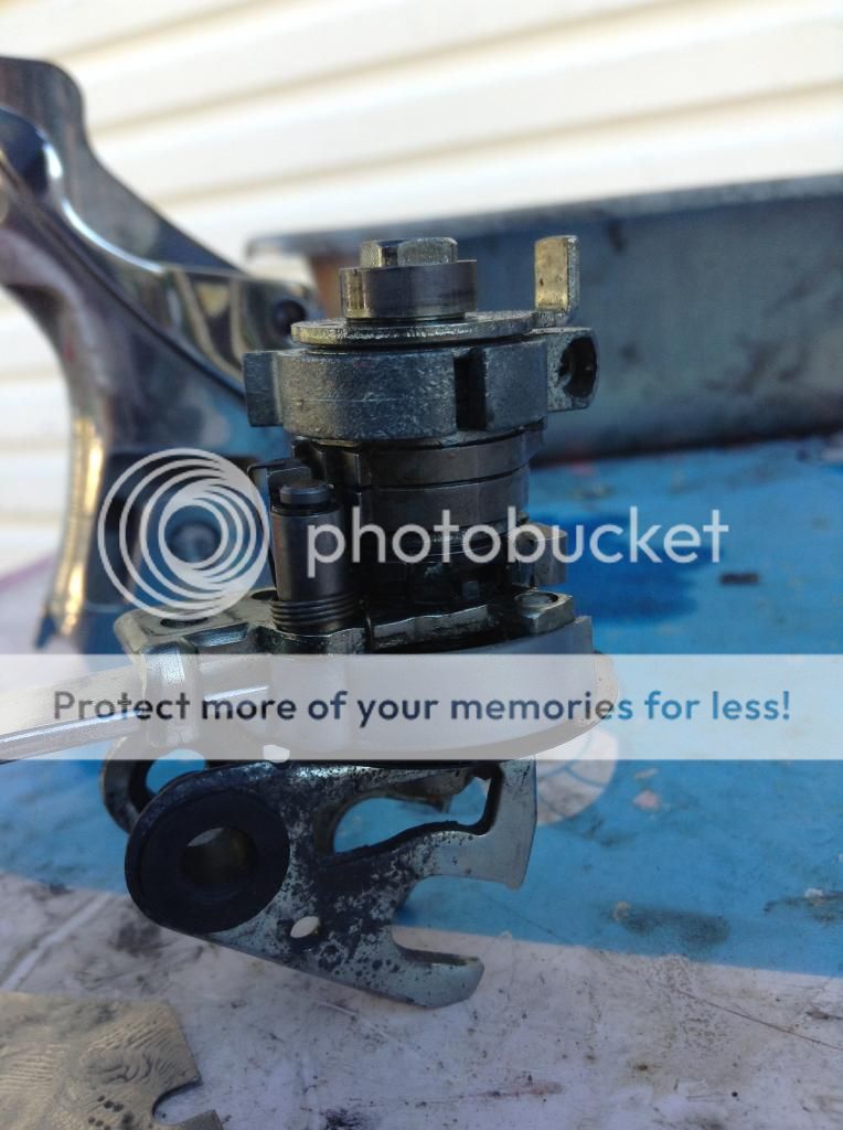

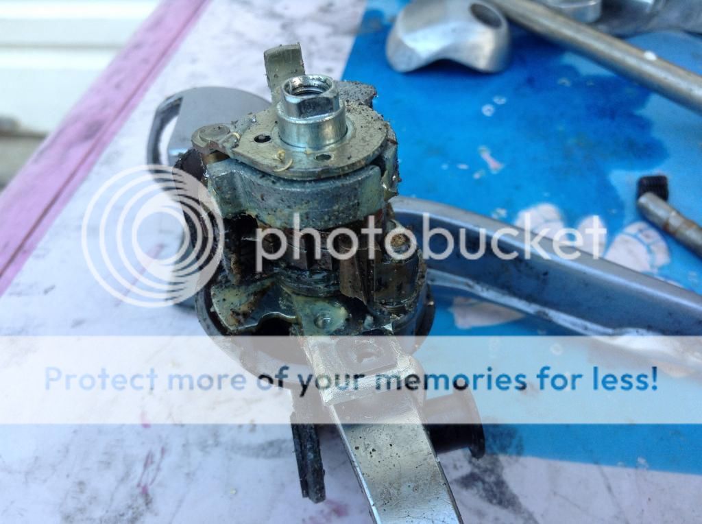

Lever comes right off to reveal the innards. Now this side was dirty as! Sand and dirt managed to get inside, and may possibly be the issue.

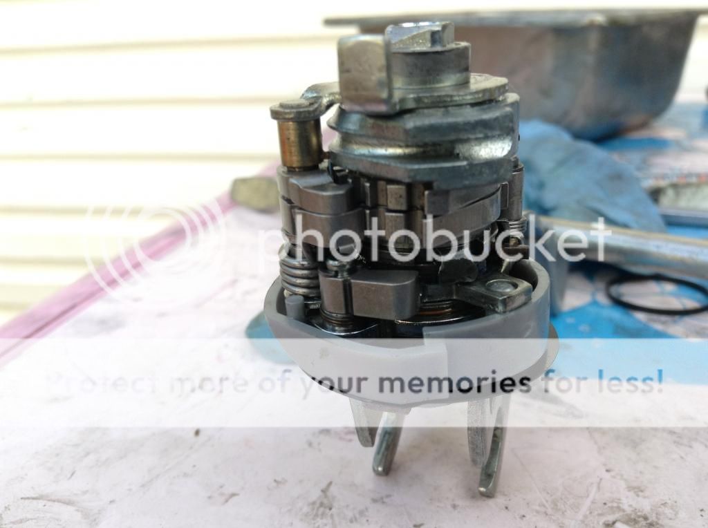

The plastic cover on mine broke off, which allowed me to clean up a little easier, but I had to glue it back on. Its only there to keep dirt and other stuff out of the lever.
Both levers can go back together in the opposite way they came apart, so back trace, and you shouldnt have a problem.

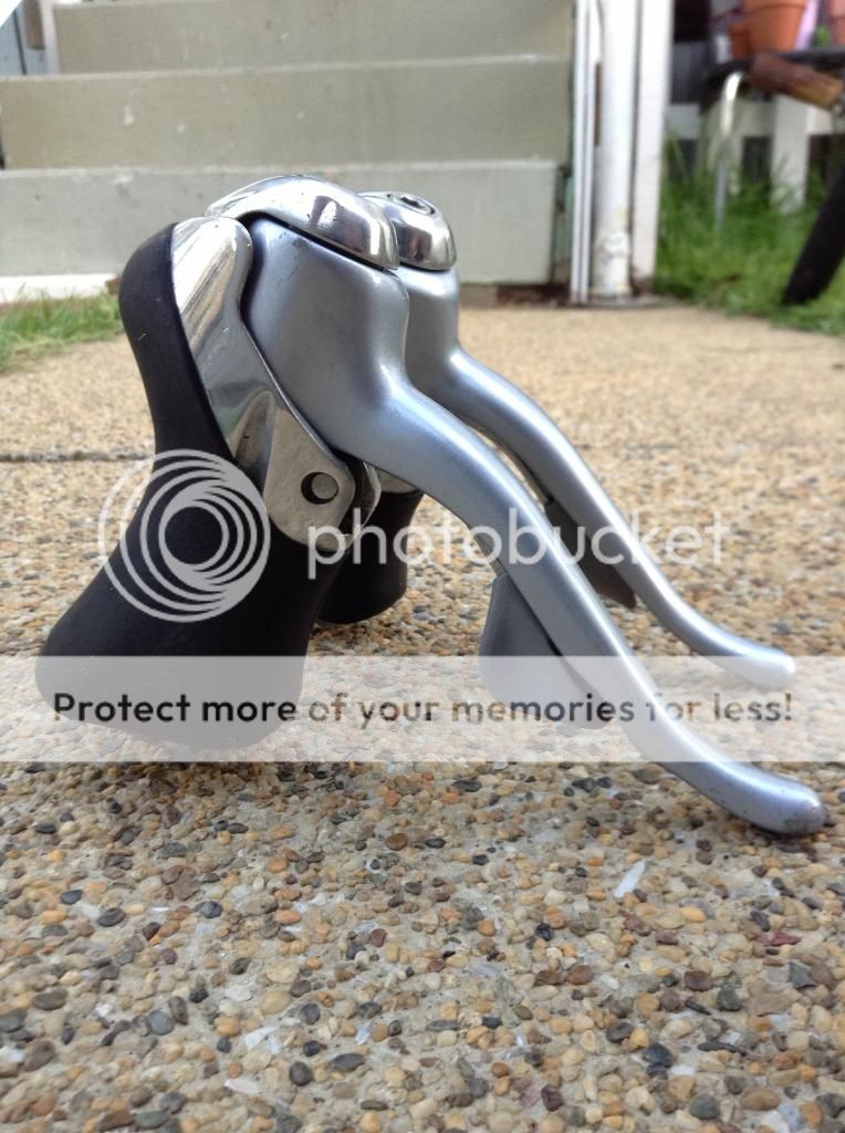

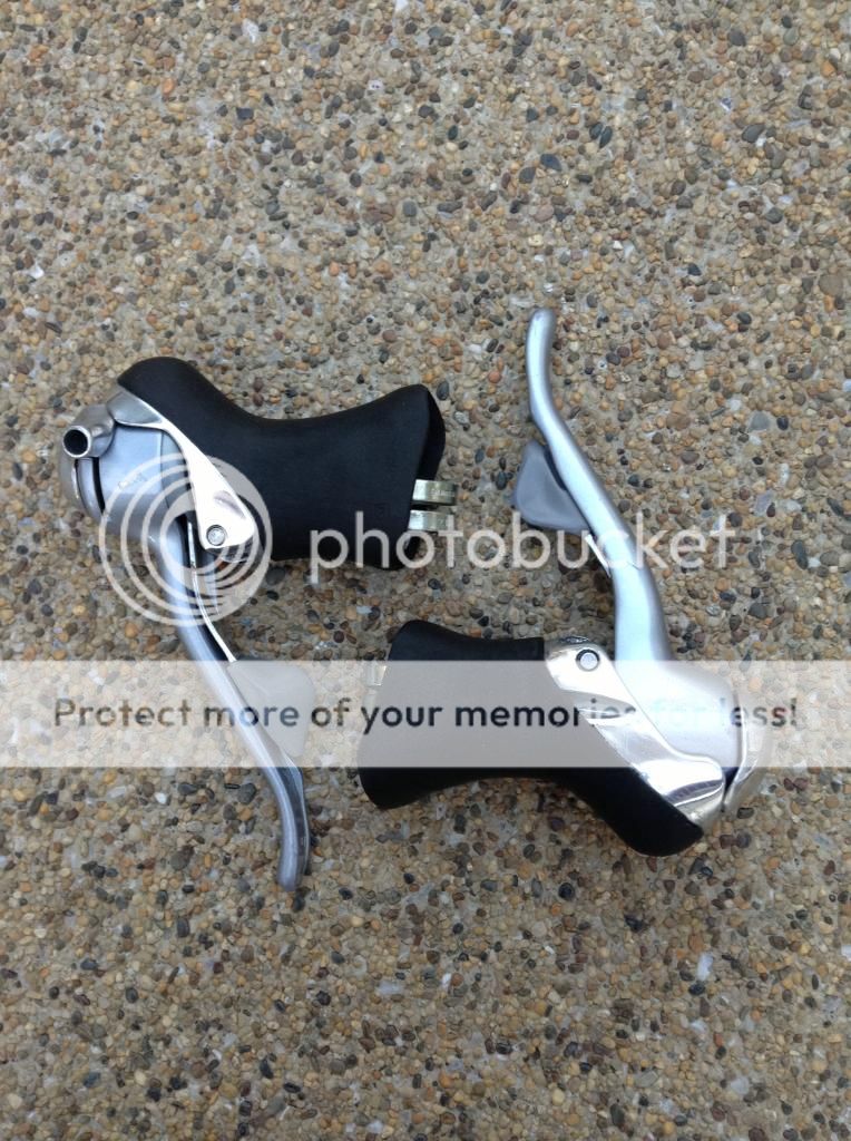

Finished Product! I chose to polish the exposed body, like on the RX100, and the name plate. I did lose the RSX logo, but in return I got a mirror finish. This time round I chose to not sand off the silver paint and polish, as it was in quite good condition, and wouldve been a hassle for me anyway.

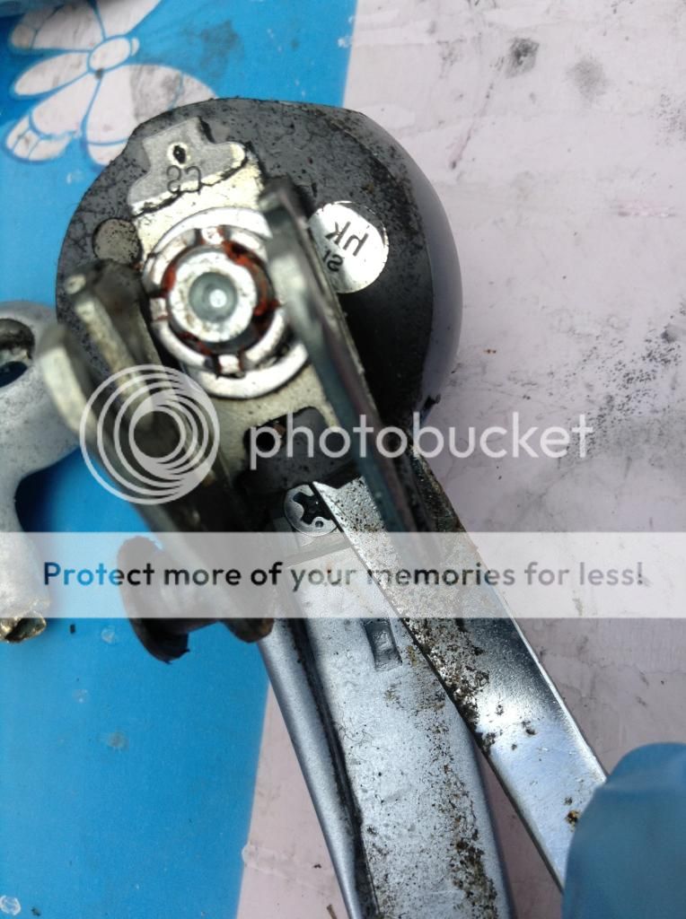

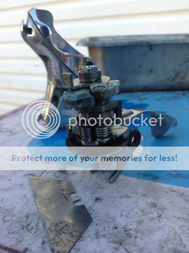

Finally had a crack at it. Got the right shifter working well, but can't seem to get the left working. Has had degreaser then WD 40 sprayed liberally and then work back and forth to free it up.
The two bits indicated dont seem to have any way of activating when moving the lever, without using a small lever. Once they are moved the spring action releases the shifter as it should.
Any tips on what to do next? I haven't removed the plastic I over yet, probably the next step, I was avoiding this step so far.

In the pic, its in the larger chainring position. When you push the small lever over, that L looking shape in the pic will push onto the left 2 pawls that you indicated, lifting them up. Theres a spring on the inside of the mechanism which will pull it into the small chainring position. Now, here it may not do that. The gummy grease is still around inside the middle of that lever, not allowing it to freely spring back, as that was what I found out had happened on mine recently. But that should be fine. When attached to the FD, the restoring spring in the FD will assist in returning it to the small chainring position. For now, use a free finger or small pointy object to assist it into the small chainring position when you push the small lever. You should see that itll spring back.
The part you indicated on the right has that spring hwich holds the pawl into the gears. When you push the large lever, itll push the mechanism over a click, as per the gear shape. The small lever will shift into the small chain ring, as the pawl will slip over the gears due to the shape of the gears. Nothing activates this pawl. It just moves with the large lever.
This is from just these pics, and what I can remember. I may be wrong there somewhere, but should be pretty much spot on.

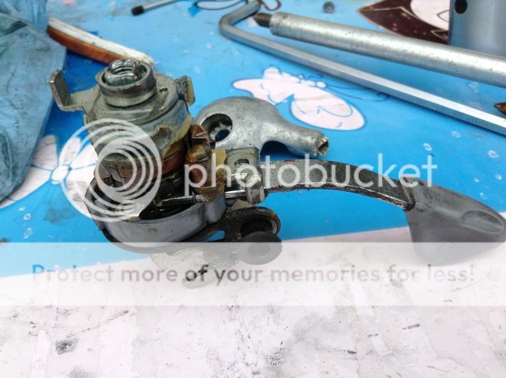

Fixed mine today. I ended up removing the plastic cover to see what it was hiding.
The pic below shows the cam that wasn't engaging, preventing the downshift. I was a combination of the cam not being free enough to move and the spring not being in position. WD40 and plenty of manipulation sorted the movement, it flopped around nicely after luring. The tiny wire around the cam is a light spring, mine was on the inside of the cam, not the outside as it is in the picture as restored.

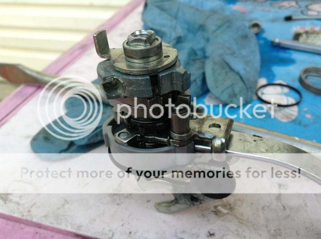

My RH shifter stopped working again, so out with the instructions and tools. Unfortunately it appears that this time it wasn't grease, but the cam that engages the bit to drop to a smaller cog won't engage with its catch (terminology?). It appears to have worn down and even pushing on the cam won't get it to release the gear most of the time so adding lubricant won't work. Looks like it may have passed the end of its useful life.
It's shown in the bottom of this pic.

I know of the part you're talking about. And yes, I've since realised that it's that pawl and the one that is directly opposite to it which are the usual suspects that hinder the shifter from working.
I find that even after a long soak in solvent it still does not want to freely pivot, so it needs a bit of manual pivoting(use a small pen knife or similar) to break up the grease bond. Try that first as I find it odd that it'll be so worn out. If it is worn, I probably have a spare lying around.
I'll probably get these instructions updated whenever I get the time to do that. My methods of cleaning and lubrication have changed a bit
