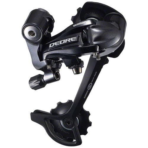

Can I confirm that a 9sp Deore will work?
It's cheaper anyway. :)

warthog1 wrote:Can I confirm that a 9sp Deore will work?
Yes, or alternatively CRC also carry the slightly lighter and higher spec Deore XT version, which is the one I have successfully used on a road bike with a 34T rear cog (for climbing stupidly long and steep mountains in Italy). Deore XT
Setup and adjustment was a bit more finicky than with the standard 6700 RD - it was hard to get it shifting sweetly at both ends of the cassette but it got there in the end.
