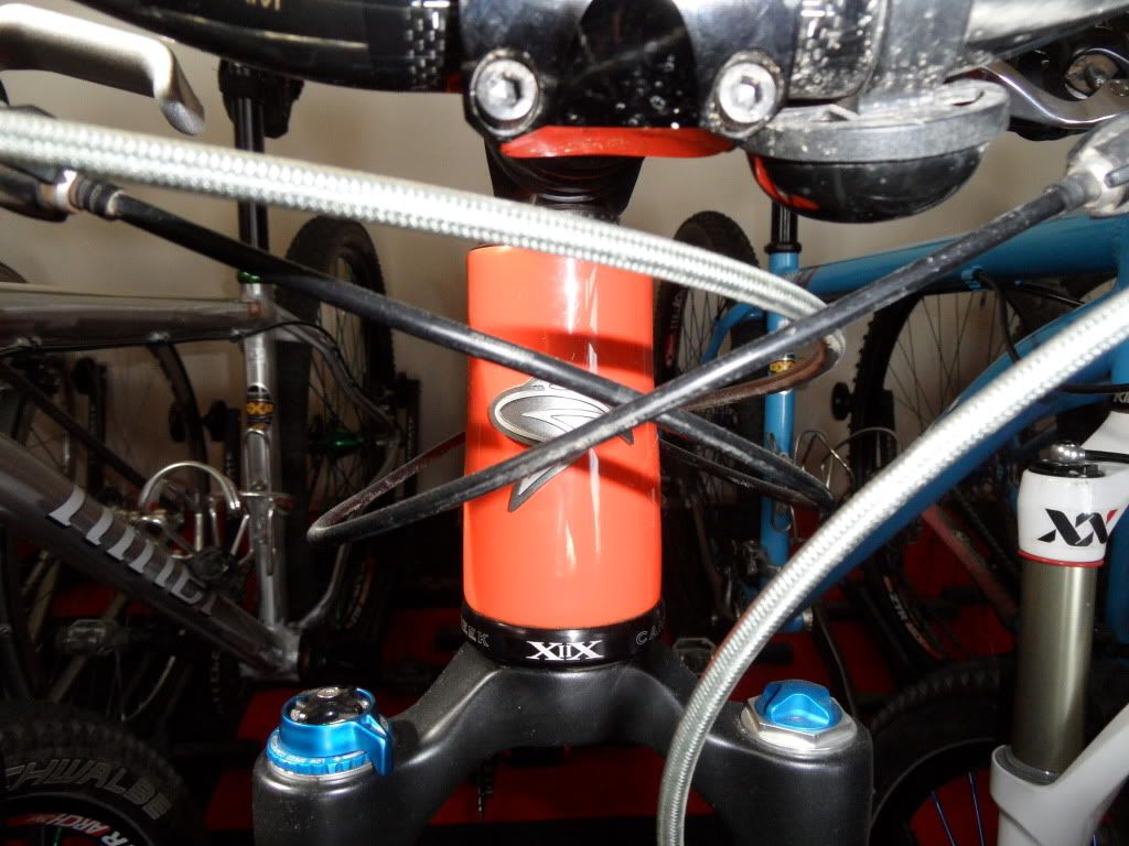

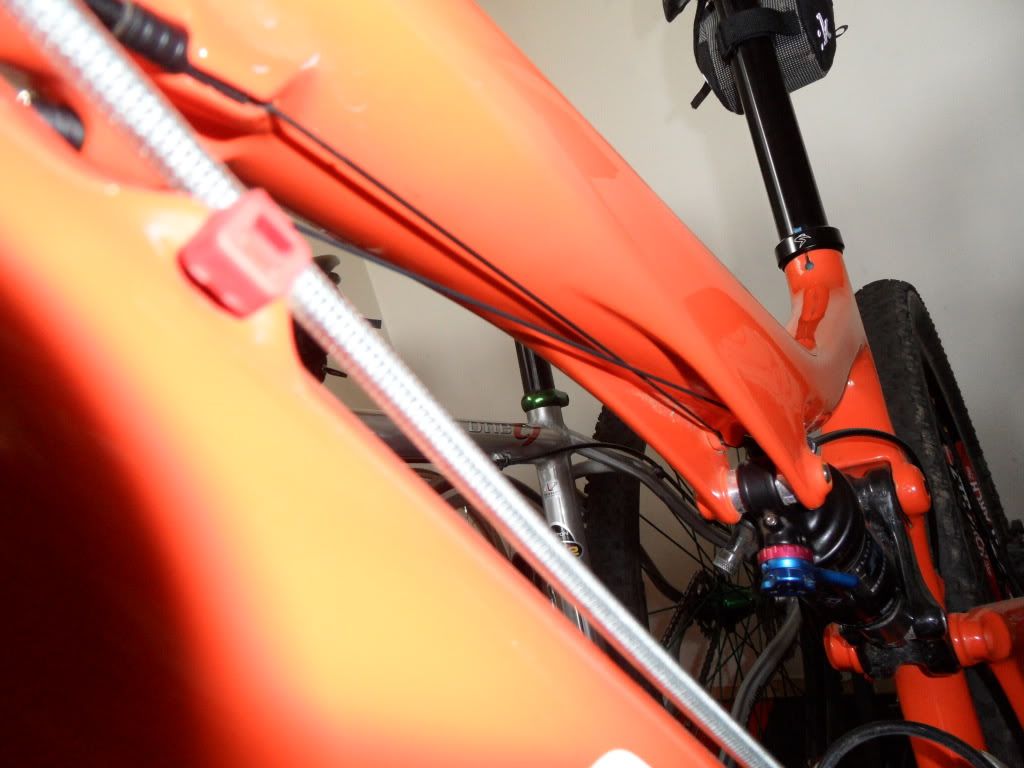

Postby ZepinAtor » Tue Oct 15, 2013 12:53 am
MattyK wrote:It still baffles me though, as per my first post, that those frame makers based in RHD countries (Aus, NZ, UK, etc) don't move the cable stops/frame entry holes around to better suit the cable routing of a right-front/left-rear brake. It looks so much neater when the cables can bend gently around the head tube, not get knotted trying to stay on the same side as the lever.
That's the exact reason all my bikes including the MTB's are right rear. Clean cable lines as you say & if the bike allows it I cross the gear cables over under the head tube to achieve the same effect. I don't have any frame rub stickers except on the SuperSix as the cable stoppers are too high on the down tube to perform the cross over.
Clean rub free lines :)

Postby eeksll » Tue Oct 15, 2013 10:00 am
that cable routing above is much nicer.
unfortunately my new bike won't allow crossover underneath as the cable stops are on the side of the frame. The under bar tape gear cabling makes it harder as well.
my current plan is to move over to nokon type cable which worked really well on the flatbar for cable routing as it is much more flexible.
