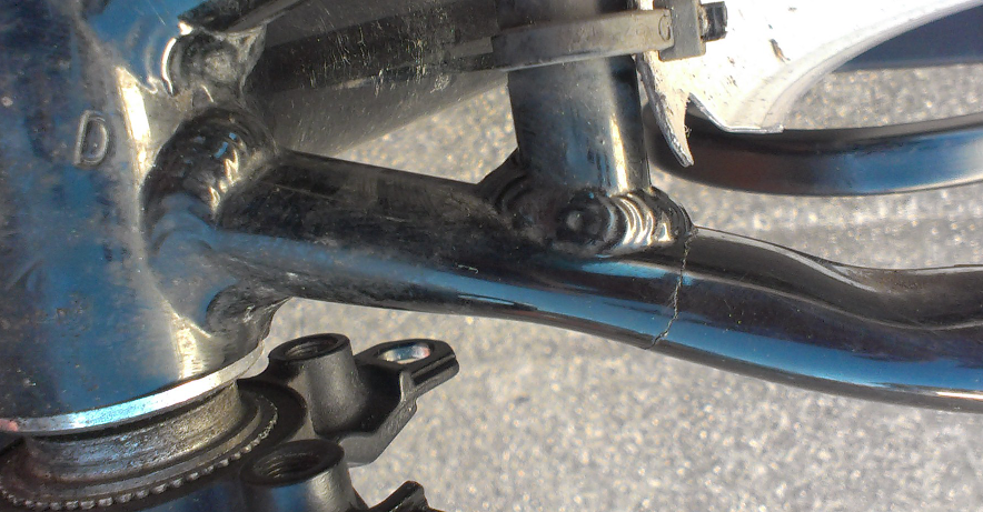

It looks like I was fretting over the wrong chainstay. I popped off the chainring to clean the drivetrain and found this on the driveside:
The crack goes right around the inside of the chainstay and round the top. it probably goes 2/3s of the way around its circumference.
I don't know if its fatigue or crash damage. I've had the bike for three and a half years and have had a couple offs in that time; I've gone over onto the drive side at least twice. On the other hand, I'm 6'4", 90-odd kg, usually have a pannier aboard and have been running the bike as a single speed since February.

Postby il padrone » Mon Nov 04, 2013 7:06 pm
Wow! Lucky you took that kickstand off eh? :P
That is an EX-frame. The crack began at the tip of the weld (stress riser caused by heating of the tubing) and propogated around the tube. Probably compounded by loads carried.
Touring bike = steel IMHO
Get yourself a Surly LHT or Crosscheck frame, or even better, go on-line and buy yourself a nice BIG Thorn Sherpa Mk2 (from http://www.sjscycles.co.uk) and swap your components over. You'd get a lovely new frame for about £435 plus shipping. Should be about $800, but would need forks as well, so another £240. A bit of $$$ but you'll have a bike to keep.
