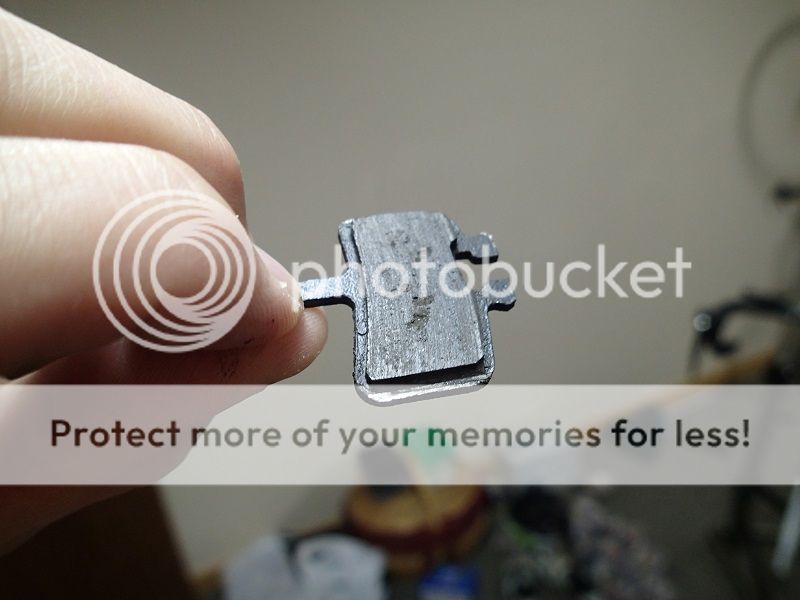

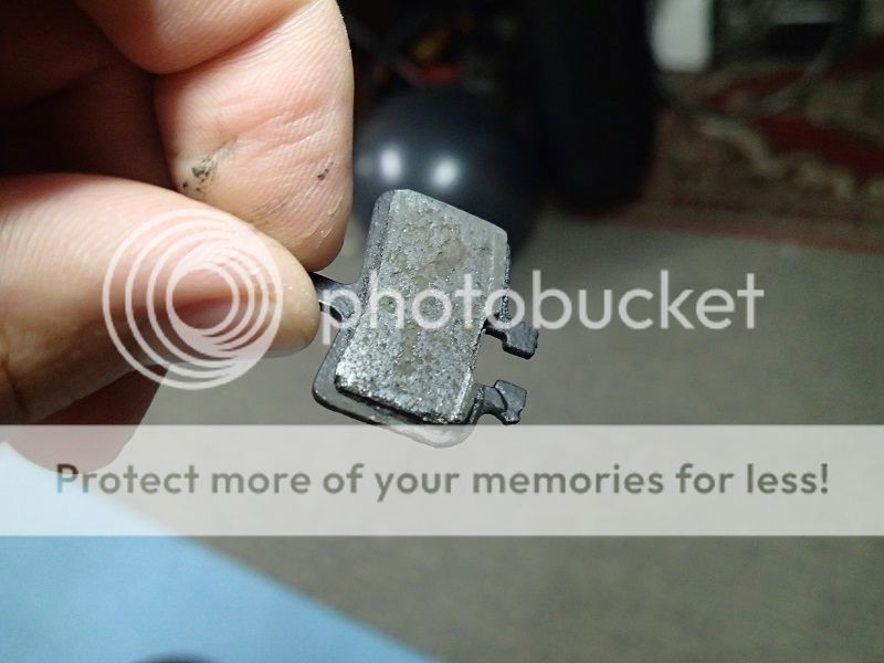

2nd descent - complete fade, brakes went out the window - shocked!
had a look & it appears they cooked!
REALLY disappointing... *might* switch to the HS1 rotor, but might have to chuck the ceramics & go to Kevalr on the BB7's...
Pics of the results...

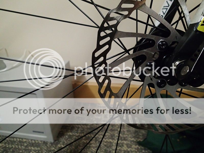

noticeable discoloration on the disc, and chunks missing from the pad material :\

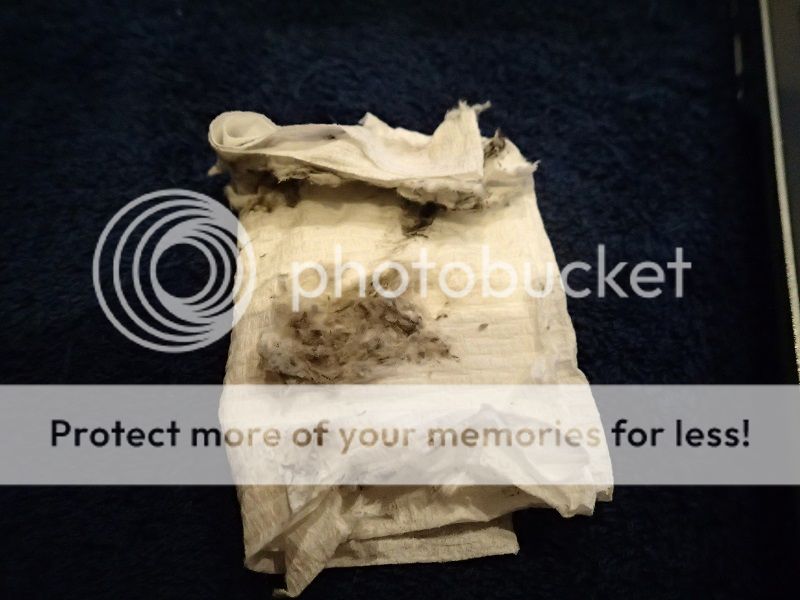

stuff removed from the rotor:
Look cooked?

Re discolouration : Have seen a similar thing on my discs. Just means they got hot. No problem.
Re material from disc : Just brake pad dust. No problem. Some will do it more than others.
Re stopping power : Most pad materials will have a heat range where they work well. Some work great from cold, but will lose power when hot, some the other way around, some consistent over a wide heat range etc.

My conclusion is that you reached the limit of the pads re heat. Try the same run with the Kevlar pads and see what happens.

I would go for a rotor with a lot less holes and more of a sweep area or bigger diameter. No mater what brake pad you use if you go harder compound its going to make more heat and cook your rotor and pads. Once you over heat the rotor and it gets that black coating on it you reduce the braking friction and its all down hill from there.

In the OPs case the rotor is black already pretty overheated to me, go to the next level harder pad compound, the rotors will fry even more. He has had brake failure from the brake set up he has now it cant get rid of the heat fast enough. Going to harder pads will generate even more heat as he will most likely be able to brake harder and longer. Im 75kg and run a 185mm avid disc brake on my mtb and use metallic brake pads and I am able to fry them at my weight and I cant image a largely slotted light weight 165mm rotor doing well with close to a100kg rider on board braking hard. On my road bike I run a 160mm tektro disc that is thicker and has a larger sweep area to the Avid disc I have on the mtb and I do quite a few mountain descents at 80kms and only brake in a few spots but they seem to hold up. I have over 20 years of experience on working with brakes and partly on race cars at that and I wouldnt recommend he goes to a bigger diameter rotor on the front which would be the best solution but it will rub like mad when he corners it's typical of light weight carbon forks from my experience.

The rotor isnt cooked - the black stuff comes off easily with some acetone, its not metal discolouration from heating - more melted pad (not pad dust).
looks like they're NOT G2 clean squeaks.

The first photo is deceiving looks black with scrape marks in it but your brake pads are absolutely fried. See how you go Ive never played with Kevlar pads, on the rear of my mtb I wanted to keep with 160 and went to the avid HSX rotor it was a little better than the HS1 I had on it. The HS1 would get really hot easily and then would start to squeal like a pig with organic pads.
