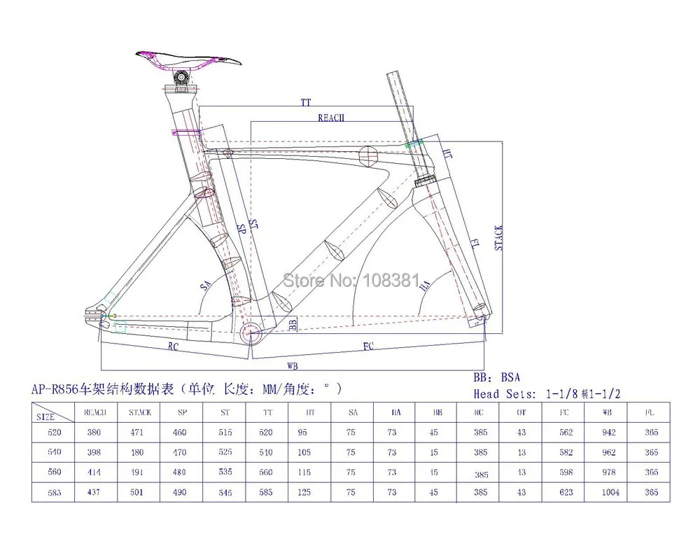

Also, going back to frames, just spotted this on ebay/aliexpress the 54 would be a good fit for me. The BB is nice and high, and the front center is generous. Perhaps another option?
