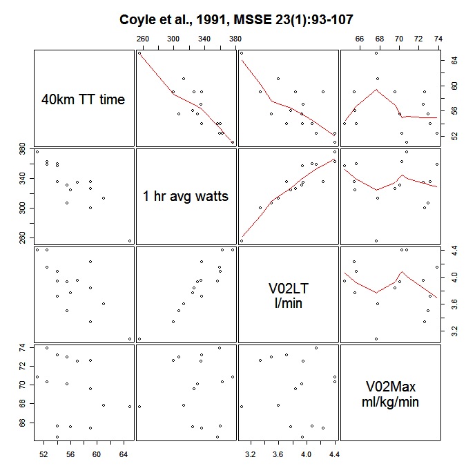

Postby Alex Simmons/RST » Tue Aug 23, 2011 2:37 am
vander wrote:You can mostly extrapolate those values from a VO2max test. Those Wattage values do the same thing they tell you your possibilities but not what they will be. Im going to use VO2max tests as a way of monitoring my training. I am already planning the next one in about 6 weeks to see how i improve. VO2 is just another tool, and i thought it was meant to be more exact then the power outputs.
Vo2max is a pretty poor indicator of performance, and definitely inferior to power output in that regard. VO2max will give you a rough idea of performance potential, telling you which ball park you could play the game in but beyond that, if you want to know how you'll perform, go race.
"The best predictor of performance is performance itself" - A. Coggan
Sustainable power to weight ratio is an excellent predictor of performance. Some data from Coyle, summarised in this neat chart by Prof. Chung:
Note the poor correlation between rider's VO2 max and their lactate threshold, 1 hour power and 40km TT performance. Note the far better correlation between lactate threshold, 1 hour power and 40km TT performance.
One can't measure blood lactate nor VO2 while training and are they are pretty impractical as a guides for to day to day training. Save your money on VO2 tests and BL equipment and get a power meter. Far, far more useful.

Re: VO2Max
Postby vander » Tue Aug 23, 2011 8:32 pm
(AT) Alex
Highly significant relationships were obtained between Wpeak and VO2max (r = 0.97, P less than 0.0001) and between Wpeak and 20-km cycle time (r = -0.91, P less than 0.001). Thus, Wpeak explained 94% of the variance in measured VO2max and 82% of the variability in cycle time over 20 km. We concluded that for trained cyclists, the VO2max can be accurately predicted from Wpeak, and that Wpeak is a valid predictor of 20-km cycle time.
Hawley, J A. Noakes, T D.
Peak power output predicts maximal oxygen uptake and performance time in trained cyclists.
Shows that VO2max is a good predictor of Peak Power and Peak Power is a good predictor of 20KM TT. This was a paper I was told to look at from a lecturer at uni. I would rather be using race performances to see where I am at. But as I wont be racing for about 6 weeks or so while I build up base fitness I was wondering where I was at now.
vander
